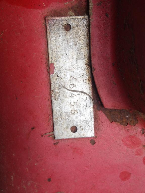

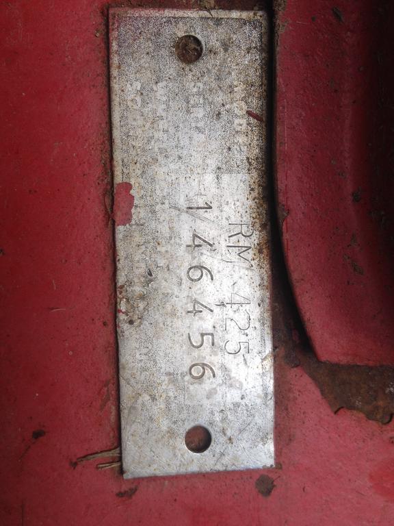

i need help with a RM425 deck I recently purchased , I need replacement blades but all I can find are 42 in ? My deck is 38 or less (exact measurements to follow later) Im beginning to wonder if the tag has been replaced? I want to add that it's great to have the good friends of likeminded people to turn to for help,support & general all around enjoyment of the Redsquare sight!!!😃
RM-425
RM = rotary mower
42 = 42" width of cut
5 = 1965
The original 5879 blade replaced by 100201 3-blade kit and no longer available (Hole 5/8in.x3/4in. Double-D)
You may find some old stock somewhere.
I do not know the length of the original blades. Measurements are normally taken diagonally from tip to tip.
:WRS:        Welcome back!  A good measurement and a top and bottom photo of the deck will help.

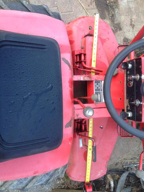

Thanx guys for the welcome backs! If what gwest has posted is the formula for the model number then the tag had to have been replaced ! I'll try to post pics w/exact measurements shortly... Thanx again my equine friends.
APPALACHIAN EDGE

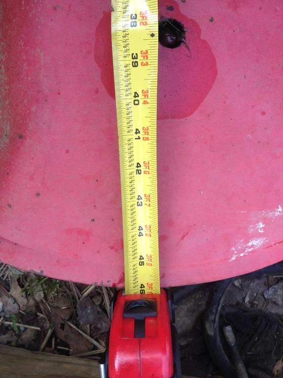

Ok I jumped the gun a lil , deck seems to be 42 with around 38 in cut , duh! Now that that's cleared up anyone have any ideas where a feller could find replacement blades or what the part# might be??
