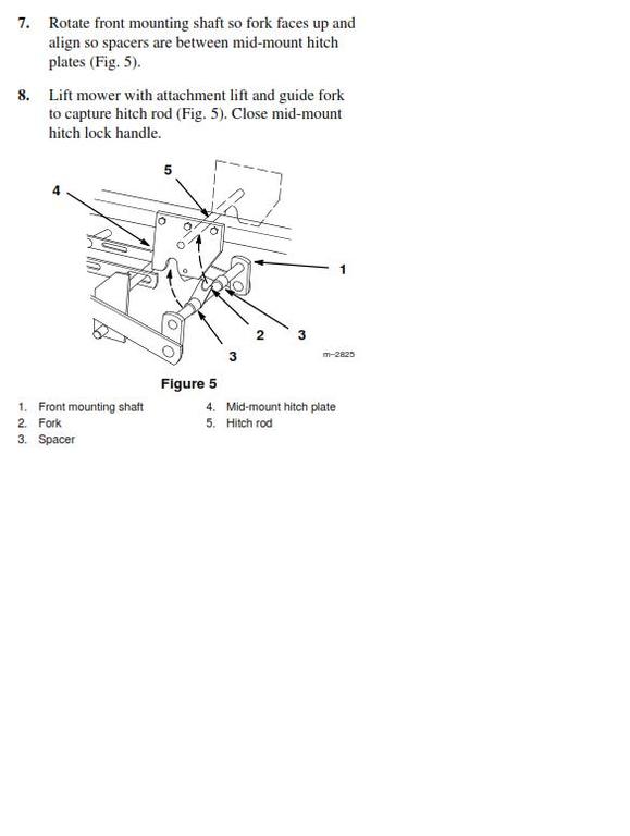

These pics should help..
Just a guess at the deck you have. Click on the picture
The info supplied above is all correct and was the same till the end of production in 2007.
