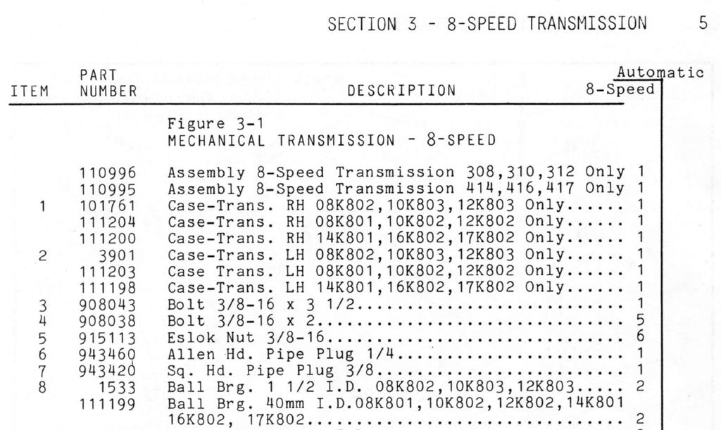

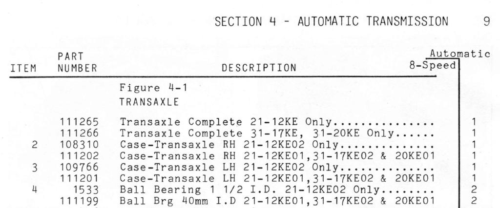

gwest_ca-(File Mod) 11,243 #11 Posted May 21, 2018 Found this in the original ipl for the 1986 300-Series and 400-Series tractors I always guessed the early and late tractor model numbers were produced by Wheel Horse for the early and Toro for the late because 1986 was the year Toro acquired Wheel Horse. Looks as though the differential side bearings forced the tractor model number change. According to the online Toro parts lists the 111199 metric bearing was used in various models 1986-1990. Garry Share this post Link to post Share on other sites
