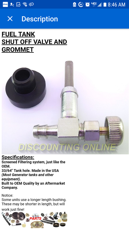

moe1965 752 #5 Posted May 2, 2018 I just bought this one on eBay. 11 bucks or so. They also sold the rubber grommets in avteo pack. I used oil and pushed mine in kinda a push and a twist. 2 Share this post Link to post Share on other sites
