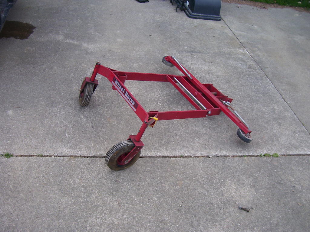

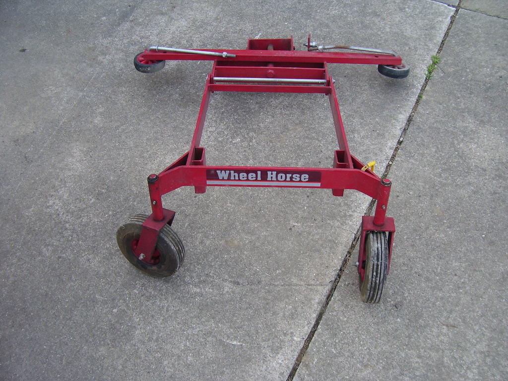

richmondred01 2,237 #1 Posted April 30, 2018 Got the out front deck installed today. It’s works well even lacking the gauge wheels. It cut very well and it reached far under the trees. I was also able to reach areas into a drainage ditch that typically requires a string trimmer. The only drawback is when I put it into the shed. It’s rather long and I’m afraid that it’s novelty will wear off soon when I need space. Im thinking that the room it takes up is a deal breaker for me. It may need a new home. 13 1 1 Share this post Link to post Share on other sites

richmondred01 2,237 #11 Posted May 7, 2018 Got some new gauge wheels and swapped decks with another 42 I had in the back of the shed. It works very good. And everyone was right it flips up for storage. It’s still a larger then I have space for and it will be looking for a new home shortly. Share this post Link to post Share on other sites

richmondred01 2,237 #16 Posted May 8, 2018 Flipped up. Saves some room. 1 Share this post Link to post Share on other sites
