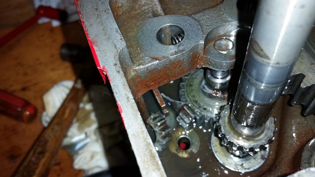

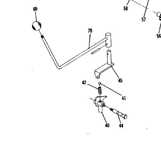

This is what is inside.  Can you rotate the shaft  #45 just sticking a pin through the roll pin hole

Shaft #45 now just rotates freely without engaging any gears.

This doesn't sound well Jeff ... sounds like the tranny is gonna have to get split. Does 45 swing 360 degrees?
IthacaJeff
Not sure how much it rotates. I've put the tractor back together and will need to disassemble a bit to investigate more. Maybe in a couple of days. . .

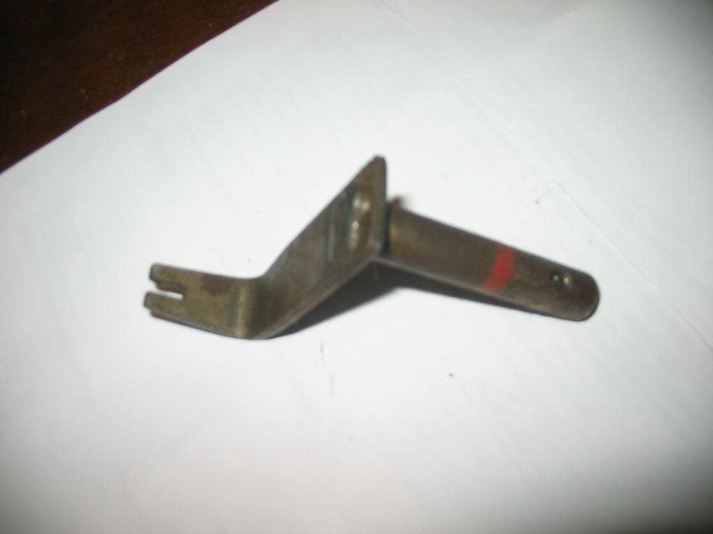

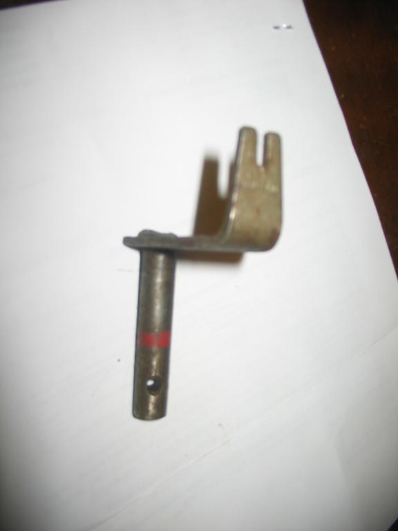

If you find that # 45 is broken, I have a replacement.
my direct email is:
daveoman@windstream.net

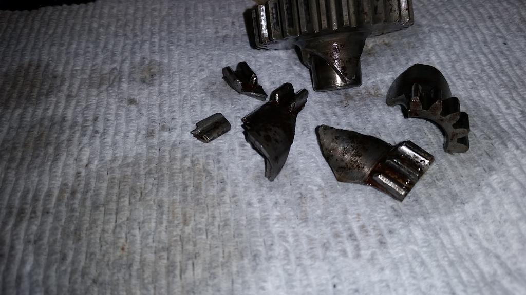

11 hours ago, IthacaJeff said:
Real, real drag
Yeah I know what you mean, I had a 5060 just went through. Parked it at a tractor show and when time to load up wouldn't move. Back apart to find a busted hi/low range gear. No idea how it happened.  Probably not your problem but you never know.

I think the smart money would use the 310-8 for mowing once or twice. With the time you would save doing that, drop the other trans and open it up.  I figure that you either broke or bent something...it should be an easy fix.  If it turns out worse then we think, then take the trans off the 310-8, fix the one off the 416-8 and put that one on the 310-8 when done. :think:
That gear looks all Wisconsiny. You boys are hard on equipment. Broke just sitting at a show! :) :banana-wrench:
