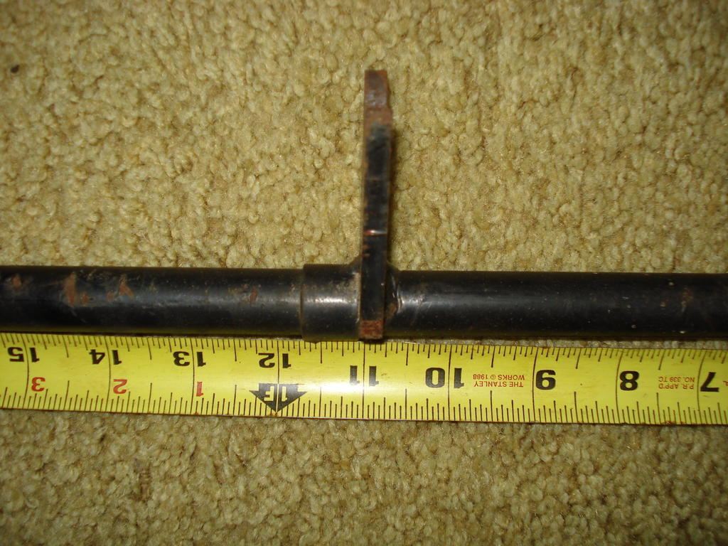

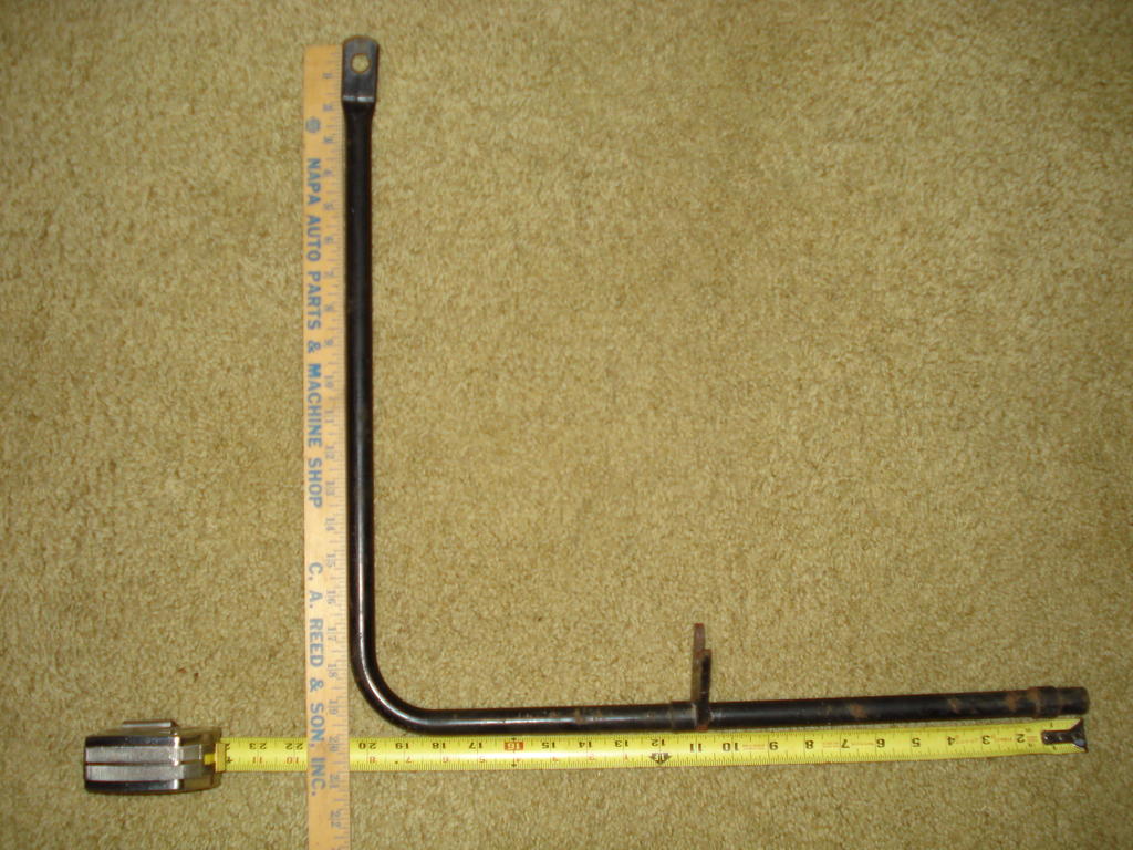

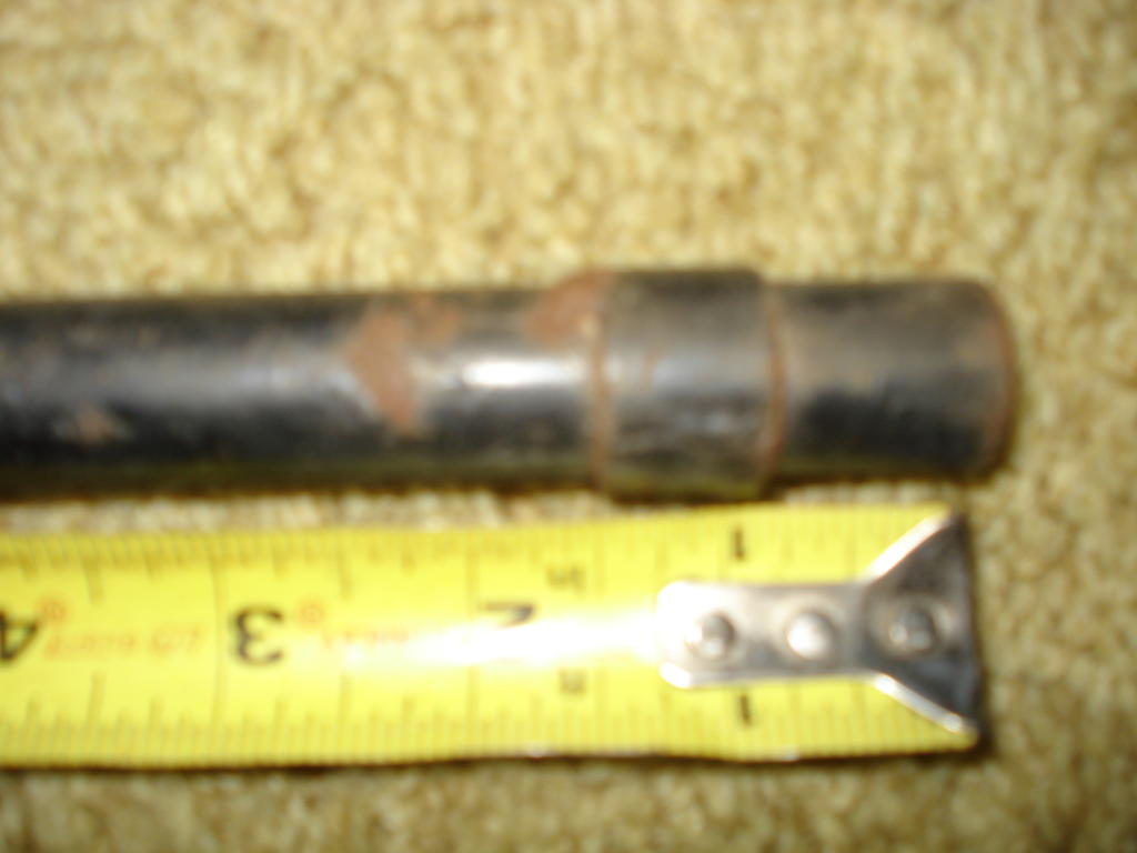

1995 520H+96+97
This is for a Toro XI series. The lower part is longer than the one on my 520H.:wh:
O2B__
Thanks very much.  That helps a lot.

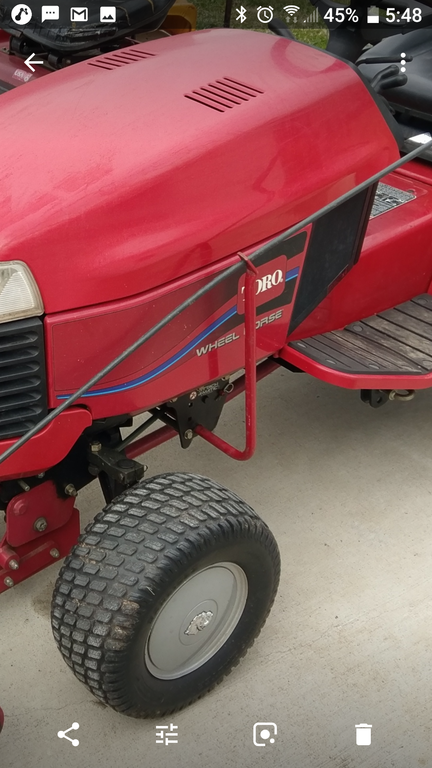

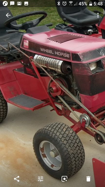

WVHillbilly520H
Here's what they look like mounted,  sorry can't measure it as I've sold both tractors with the single-stages, Jeff.
O2B__
Thanks WVHillbilly520H, for the additional photos.  Seeing it on the tractor is helpful.
