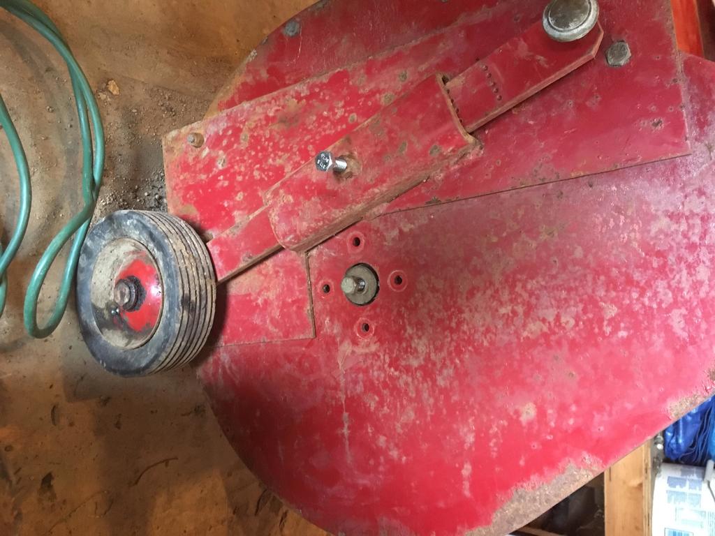

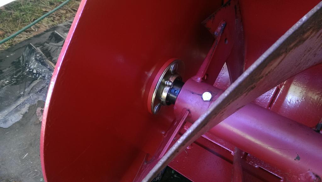

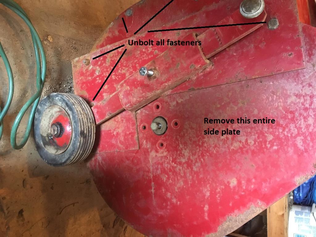

David Portenier
I took the four bolts out on the sides of the blower as you can see in the picture. I just dont know how to get the whole auger out so I can access the bearing.

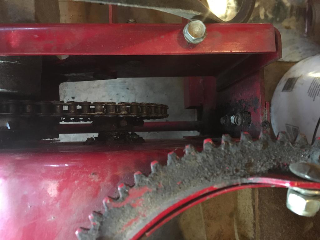

In your first pic with the drive chain, that needs to be removed as well as the sprocket then there's a locking collar bearing on the impeller (main) driveshaft then the WHOLE auger/impeller assembly will come out as one unit at least that's the only way I could get mine apart for the refurb I did a few years ago, while I was at it I changed the the impeller shaft bearing the drive chain and tensioner and added rubber impeller extensions and went through the auger gearbox new seals/gasket, not to mention cam lock bearings on the auger (but that takes extra fabrication), BTW like the adjustable wheel skids, Jeff.
wallfish
On 4/18/2018 at 6:29 PM, wallfish said:
Remove the side plate which the bearing is attached to.
image3.jpeg.1adcef207ed10107a72ec837f965f826.jpeg.ee78bdebb530b1626507d548a867996f.jpeg
