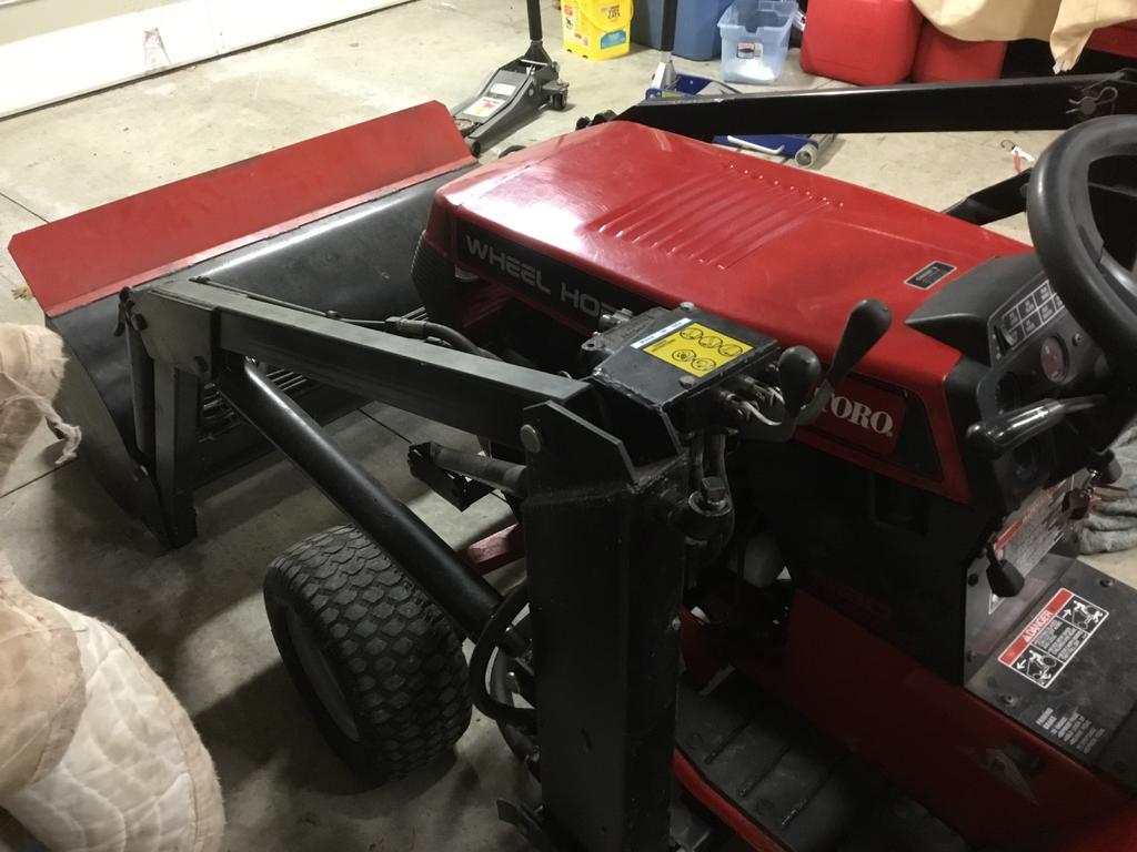

Hi everyone I just installed my loader on my 520 H and it seems to work very well. I have a few questions even  though I have a manual that I downloaded,
1. What fluid do you use? Manual says ATF or good quality  hydraulic fluid. I live in Wisconsin so some cold  weather use can be expected.
2. How do you change it. I does not say in the manual only  talks about adding in the fluid for the first time.
3.  How often should you change the fluid.  So far I can’t see any leaks. I was told the loader was only used for about two or three hours I believe it to be true since the bucket looks brand new and still has the original paint on it.   Loader is most likely purchased in 1997 or 1998.
 Thank you in advance
 Rod

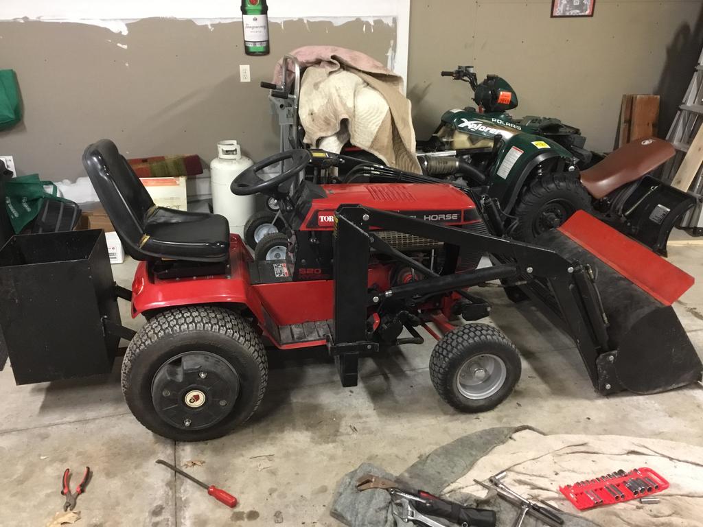

Drain the fluid from the left leg.  If it is clean, just add to the fill level hole.  If you see contamination, add enough fresh universal hydraulic fluid so that the pump picks it up and run for just a very short time and drain again.
Now look at that weight box.  That sharp rear corner will have you dug in when backing into dirt or hard packed snow.  Mine now has a 45 slope half way.
