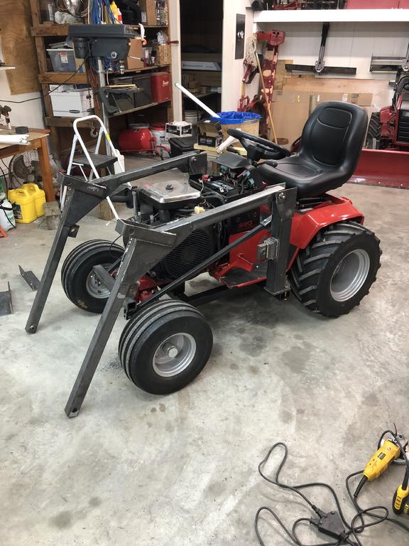

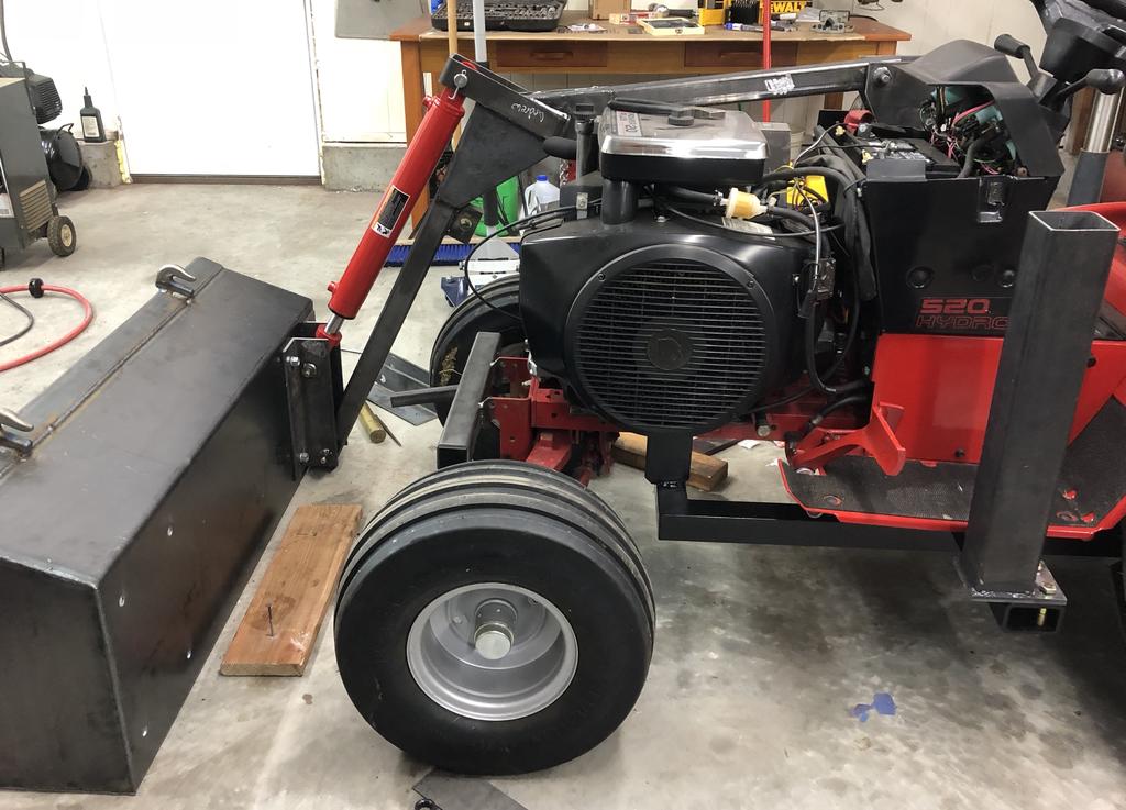

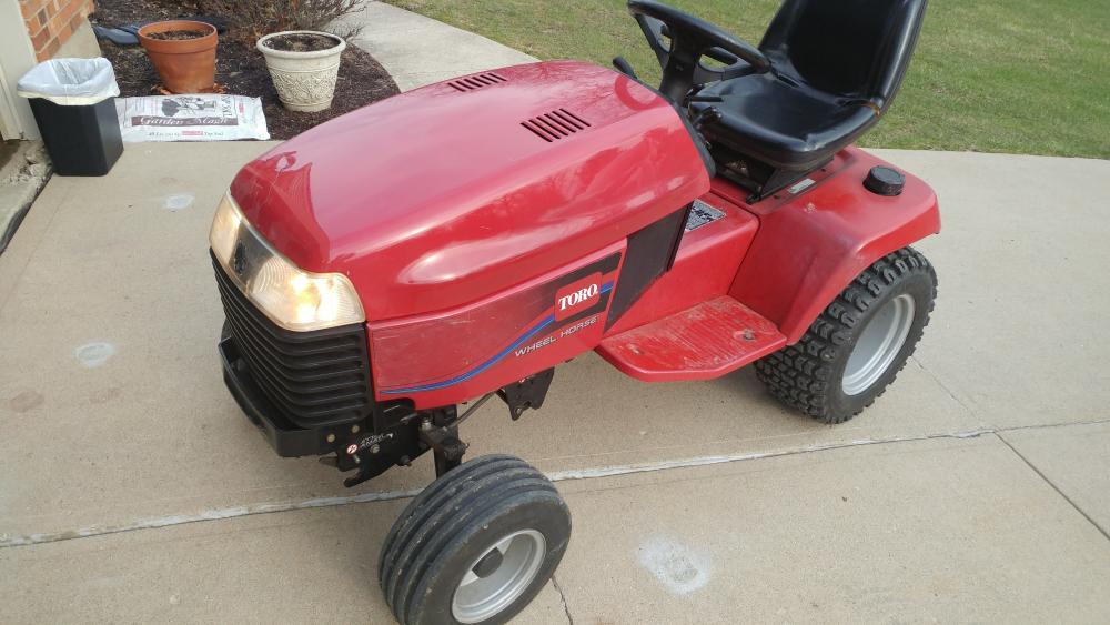

cschannuth 3,817 #6 Posted April 10, 2018 I used the tires below and went with the 18x8.50’s. You can steer this thing with your pinky with no load. I’m still working on my loader. 6 2 Share this post Link to post Share on other sites
Jrblanke 881 #7 Posted April 10, 2018 Craig your tractor looks great! Y'all bring up a good point about messing up the yard. I will be using the loader to move fill dirt and pea gravel from my concrete driveway, to different places in the yard. So making ruts may be something I need to think about more. Craig's front tires look like a good balance between turf and tri ribbed tires which would seem to be a balance between traction when steering and floation in the yard. 1 1 Share this post Link to post Share on other sites
littleredrider 409 #8 Posted April 10, 2018 I had those on my old 520. Didn’t do much with it, but when I did use it in soft ground it didn’t sink in. I plan on getting the same exact size as above, since I have 25s on the back, maybe level it out lil bit... 1 Share this post Link to post Share on other sites

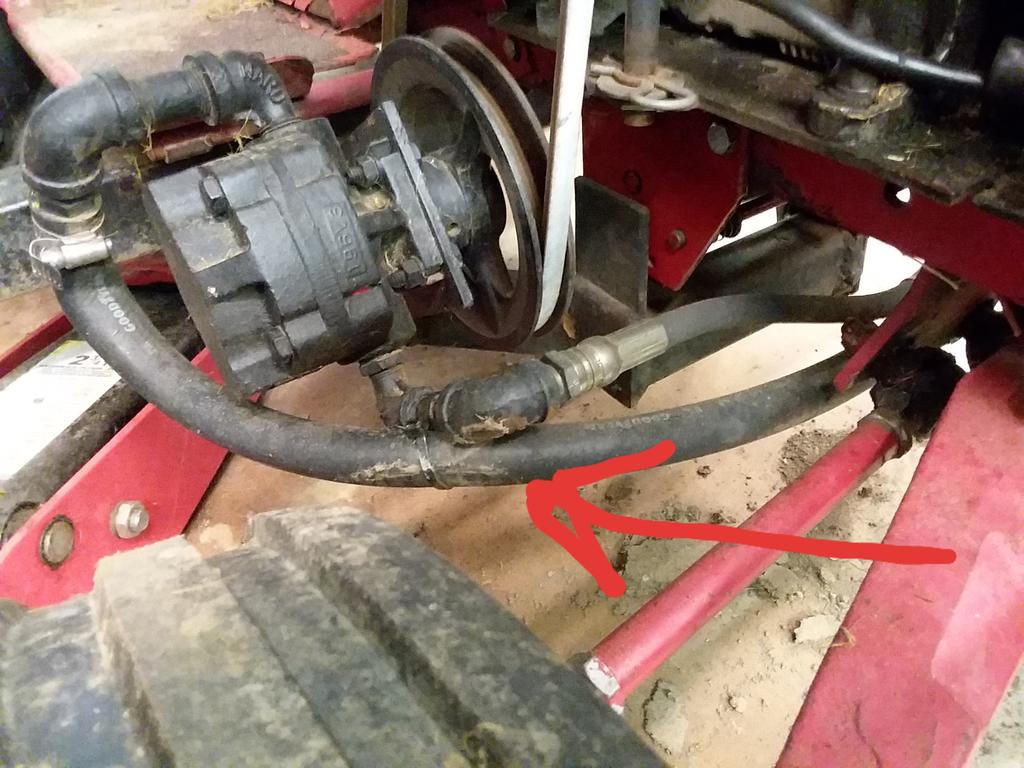

Steve_O 25 #14 Posted September 19, 2019 So, I bought the 18x8.50’s. As soon as they arrived, Miller tire notified me that 16x6.5-8's were back in stock. Rather than sending them back, I tried the 18.8.5's. They fit well on a swept axle 520. They look good. They ease turning force... .all good stuff. They do, however, interfere with a the hydraulic pump on a kwick way loader, when turning hard right, if the axle is tilted. These 18's will end up on my blower 520. 2 Share this post Link to post Share on other sites

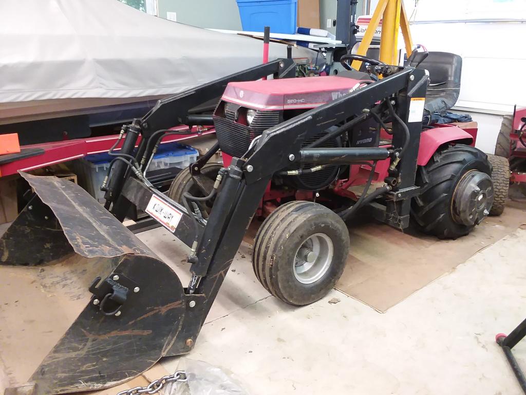

WHX?? 49,817 #16 Posted September 19, 2019 Yes pics please Steve. Did the 18's unlevel the tractor much? Steering better on soft snow and slush. As expected no better on hard pack or ice. A quick pull on the lift lever if they start to skid on tight turns on hard pack. My sno rig with 16 V's 2 1 Share this post Link to post Share on other sites
WHX?? 49,817 #18 Posted September 20, 2019 Looks like those hoses could be re-plumbed to get them up out of the way and closer to the frame. 1 Share this post Link to post Share on other sites

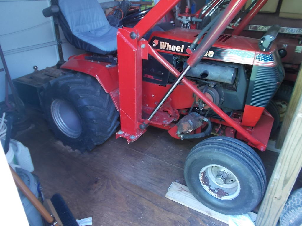

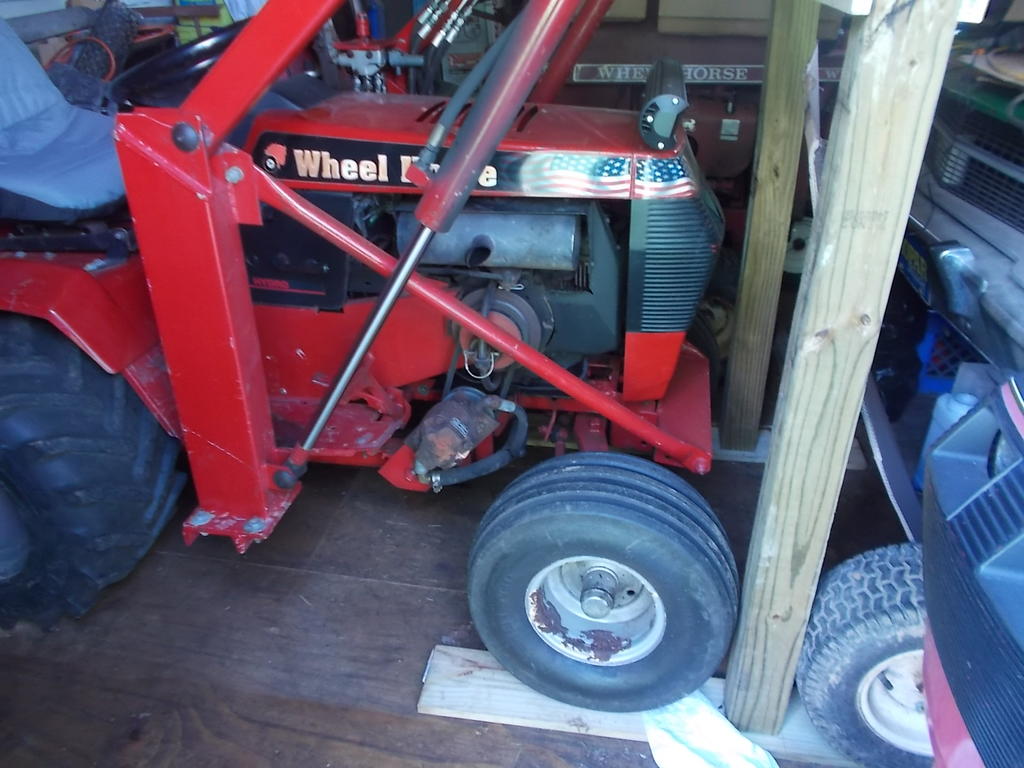

ericj 1,578 #20 Posted October 1, 2019 (edited) this is my loader, when I bought it, it had the Firestone tri rib on it. I didn't like the way the center rib cut into the soft yard when you had any weight in the bucket or hanging off the front end. I read about the Verstiens on here and thought I would like to give them a try. Found them for sale at Lebanon valley Exbo show in February in the other year. Move the tri ribs over to another 520-H that I use a front dozer blade and rear garden plow on. I like them very much on that tractor. I like the V61 on the loader, supports the load better, making the tractor more stable. I would buy them again and would put them on another loader tractor if It didn't have them on. eric j Edited October 1, 2019 by ericj Share this post Link to post Share on other sites
