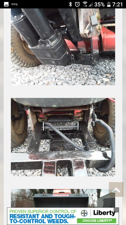

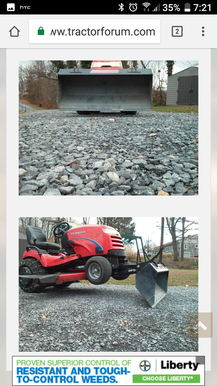

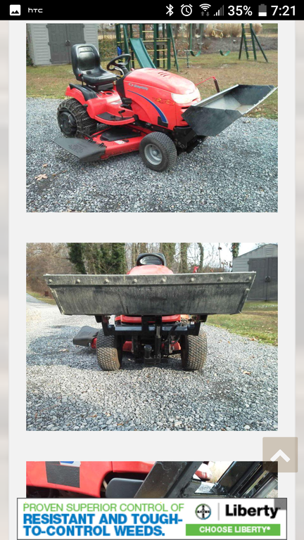

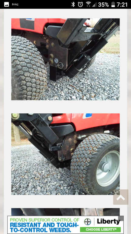

Justy37 41 #1 Posted April 8, 2018 (edited) Landed a cheap used swisher bucket... Which I am currently making front mounts for the 953.. The hydraulic ram is strong and will lift a 54" dozer blade in a pile, and lift the front tires off the ground idling... But, not sure if it would lift that swisher bucket... Well take that back, I know it will lift that bucket empty... So I've thought two options (three really) First option, run a steel bar from ram/rocker bar underneath to the bucket, lifting the bucket and having down force. Option two, run cable and pulleys from ram to bucket, lift only. Option 3, Buy a winch and mount it similar to an ATV setup.... I have no idea what a 44" bucket weights loaded with dirt or rock.. And if it's super heavy, than a winch would probably be the best option. But also puts stress on the battery. What do you guys think? Other things read about this bucket... According to northerntools... The Swisher dump bucket has a 250 pound capacity. So the shipping weight of bucket is 100 pounds.. Meaning hydraulics would need to roughly lift 350 pounds. Edited April 8, 2018 by Justy37 Share this post Link to post Share on other sites
