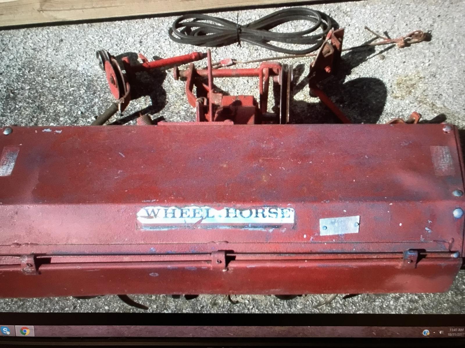

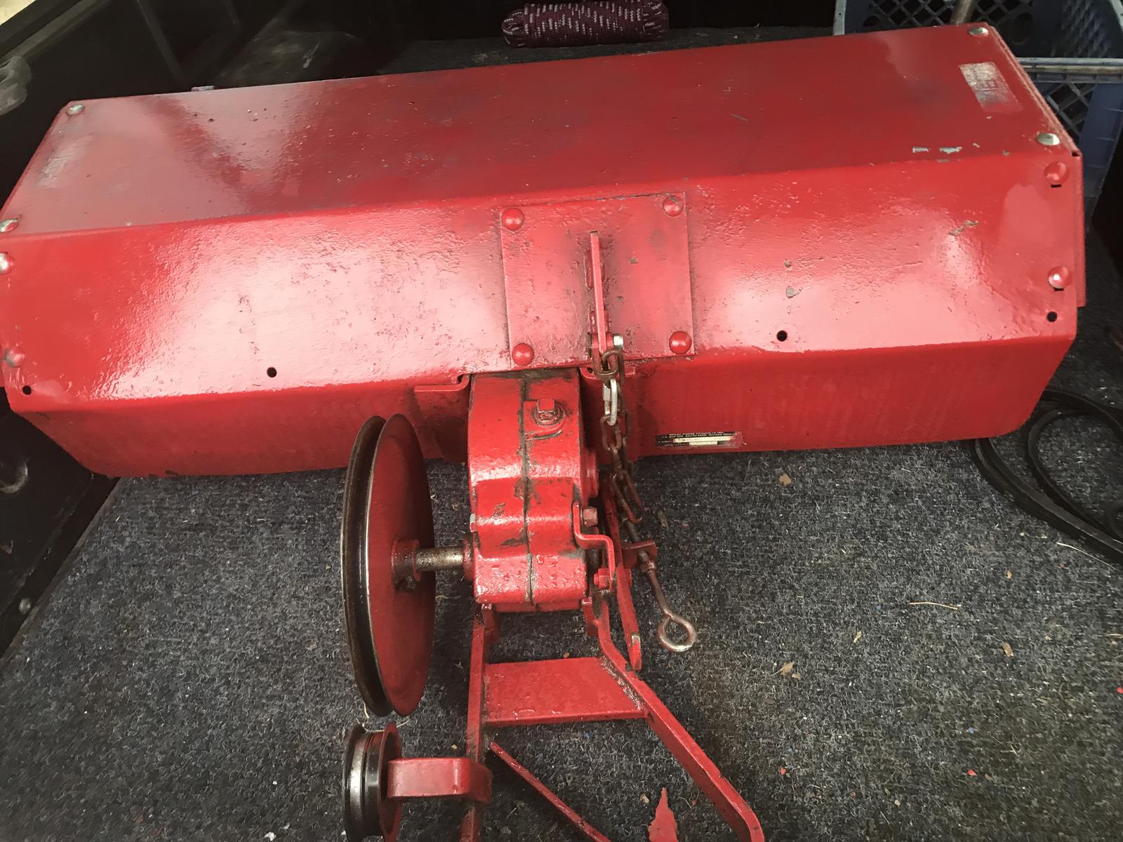

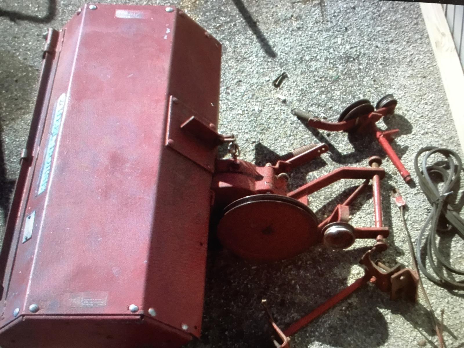

Lane Ranger 11,051 #2 Posted April 4, 2018 (edited) Two seals on most tillers on tine hubs. They can be changed from outside case - no splitting of case needed! Some of the earlier tillers I think had only one seal on outside. Most models have two. Lowell S. (wheelhorseman1000) sells in vendor section (new seals)! IMG_1321.HEIC IMG_1574.HEIC IMG_1672.HEIC IMG_1696.HEIC Edited April 4, 2018 by Lane Ranger Share this post Link to post Share on other sites
