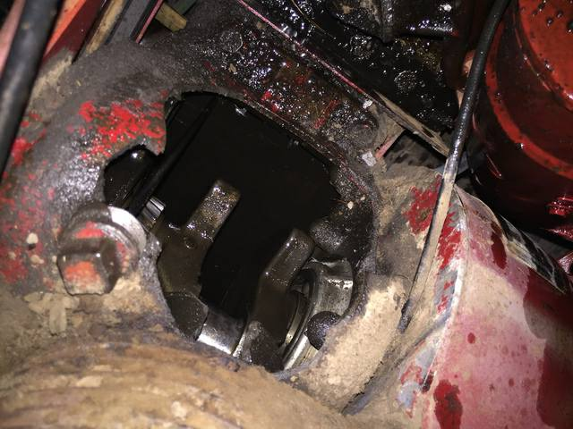

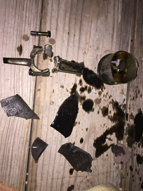

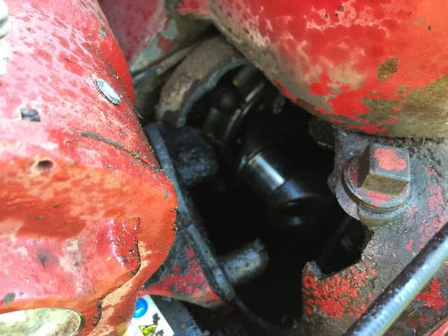

ClassicTractorProfessor
  On 4/3/2018 at 3:21 PM, mikeeyre74 said:
 unless the pieces are already flying off of it.
That's a scary situation when pieces start flying off of it, ask me how I know :lol: I've gotten now to where I can laugh about it some, but it wasn't funny when it happened almost two years ago

Sarge
I can weld that back together, at least the block, anyway. Rod, not so much...lol.
The "Kohler knock" is generally just timing, but you have to know the difference in sound. My K-301 knocks like crazy from it's balance gears and timing, plus age. One of my K-341's, it's the rod coming loose....has a gutteral, hollow knock that is distinctive of a steel rod becoming egg shaped. That's when they come apart, and why that engine is out of service - the 301 will keep on running for years. Just takes an educated ear, find an older gear head that has blown up his share of engines over the years with you - they will know...
