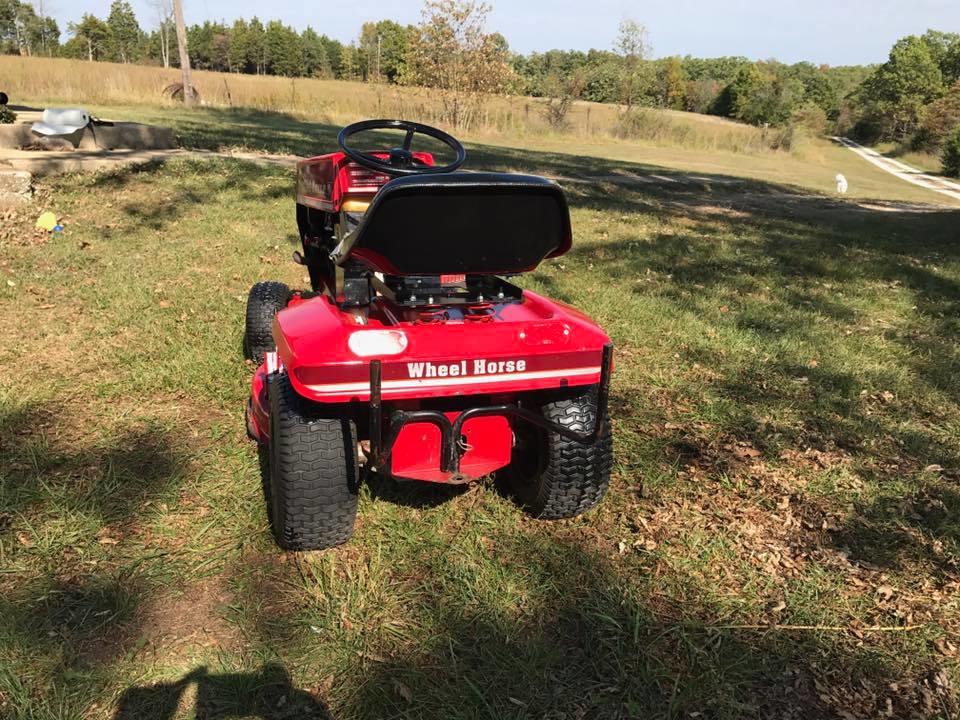

I'm heading over to take a look in an hour and I'll keep an eye for those issues. The seller says the motor mounts are a bit worn, are these expensive to replace? I'll dig around the vendor links before heading over.

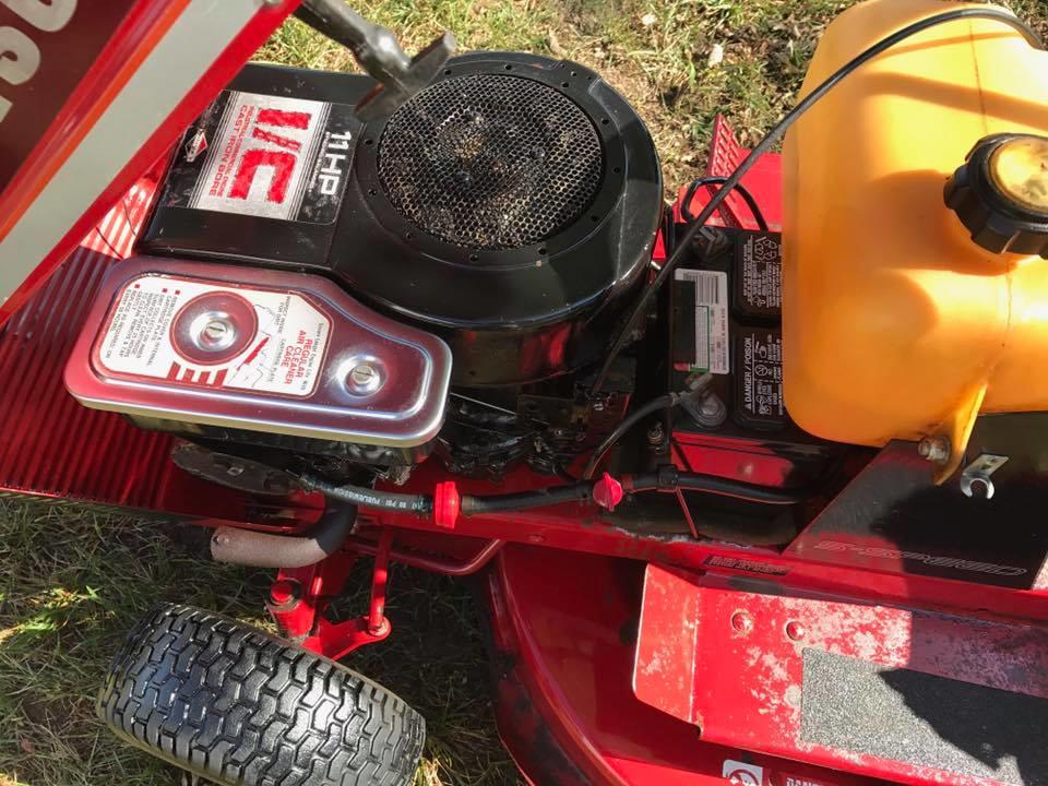

The search ends in disappointment with a little hope mixed in. As soon as I saw it I wanted it something fierce. Just enough of a patina to let you know it wasn't afraid of work. The first sign that things might not go well is that he had it running when I arrived so I couldn't cold start it though he "promised" it starts fine cold. The second sign was that as we talked he pushed the throttle up from idle to full open the first time before the engine was fully warm and a puff of white-ish smoke emitted from the exhaust. Seemed to run decent and the deck didn't make any sounds then I pulled the tranny dipstick and found that it was bent back on itself in a continuous tight radius and the end was chewed up a bit. I straightened it out and shoved it back in where it seemed to fit and the oil that came out was mostly sludge as expected but it seemed to have the beginnings of the milky water color turn. I noted that it was stored outside and had just been snowed on. Also I wasn't sure if the stick  was damaged while on the outside of the machine or in and the guy swore I was the first to pull it in years. Made me question if someone had monkeyed with the tranny a bit especially since he mentioned he and his neighbor had toyed around with the idea of turning it into a puller, but that is all speculation. I drove it up and down the street everything seemed tight until i noticed the knock from the motor.
Couldn't hear it at idle but from mid to high RPM the tick/knock was audible. I am not knowledgeable enough in these motors to distinguish between a valve clank and a rod knock but the noise was there. Oil was present in the motor though ancient and not enough, just below the hash mark. Considering that I want the machine I buy to be my weekly (daily? :lol:) use machine and don't have the resources to get bogged down in any major repair at the moment I couldn't pull the trigger with unanswered engine questions. I'm sure one of you fellas could have nailed the problem down complete with cost estimate but I just don't have the noggin' for prognostication to that degree especially with Sarge's warning about potential knock repair costs. It took me a solid half hour to talk myself out of buying it.
Did I overact and walk away from a good Horse?

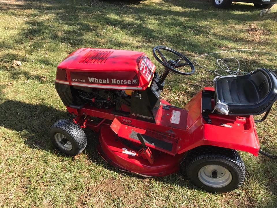

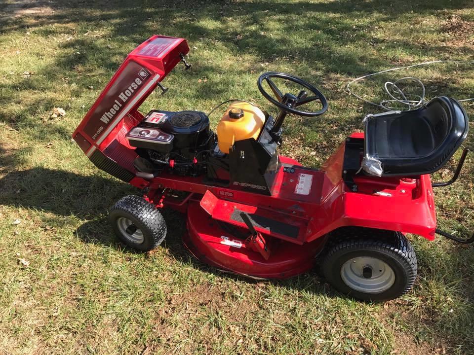

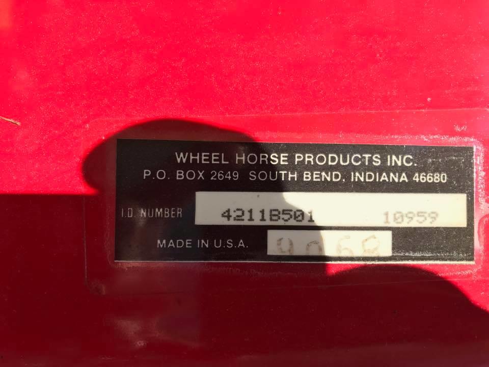

     The hope arose when I realized that seeing one in person gave my a bite from the same bug! :greetings-clappingyellow: She spotted a 1980 WH on Facebook in the area. It's a different model so I'm back to square one. Here's the info (without and external link this time Mr. Moderator :rolleyes:
1980 Wheelhorse, 11hp Briggs & Stratton Engine, 30" cut, runs good, $350 OBO
Any thoughts would be appreciated. Sorry about the spoilers i can't figure how to get them off and my brain has disengaged for the evening.

Personally, ID much rather wager on the C121, but then again, I know that @oldredrider Would help me get her tip top with the Kohler.  I'm just not much on the vertical shaft mowers, especially those later model machines.  The C121 has lots of attachments available and will hold its value much better.  Just my :twocents-02cents:!
  • Like 1
c-series don
I would not buy that toy 211 lawn mower. That is not a garden tractor capable of handling many different attachments like a C-series tractor. I would wait for a decent c or 3-400 series tractor to come along.
  • Like 1
oliver2-44
You did good walking away, the right one will come along
