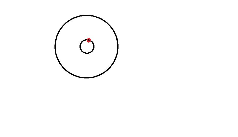

You can attach a pulley by drilling a hole 1/2 in the pulley, 1/2 in the shaft. Thread the hole with a tap and lock it together with a set screw
That's a slick idea John!  That's easy enough to try!

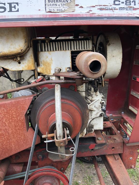

As stated There are many ways to get the HH100 up and ready for a horse. I currently have 3 and gave my old reliable 1045 with Tecumseh transplant to my brother. All are still running strong. If I were in your spot I’d find a different crank and side cover.
The common 70’s era side covers have the same bolt pattern as a  8 hp Kohler and a raider engine mount plate can make it a bolt in swap on a B-80 or C-81 and some others.
With :wh: using both 1” and 1/18” cranks it wouldn’t matter much what size crank you find as long as it’s to spec. Here’s a pic of one I’m currently putting together, waiting on @jay bee to fill his muffler order and then it’s another horse back to work:woohoo: E5A67190-F182-4CEA-AF28-A8F2C7977BF1.jpeg.7d44942bcb547f50e6a9458e9458caa7.jpeg
