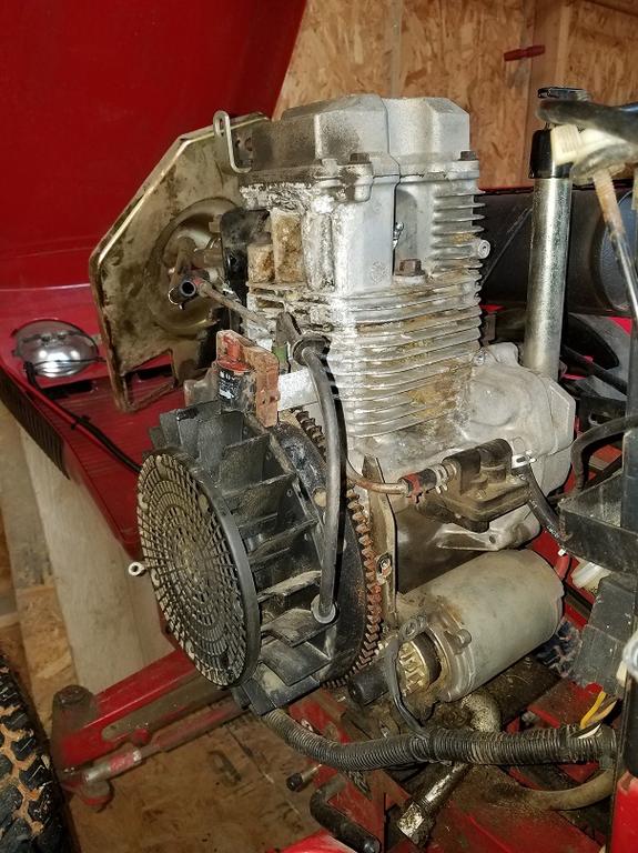

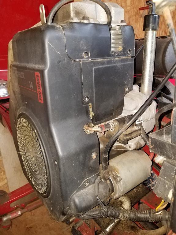

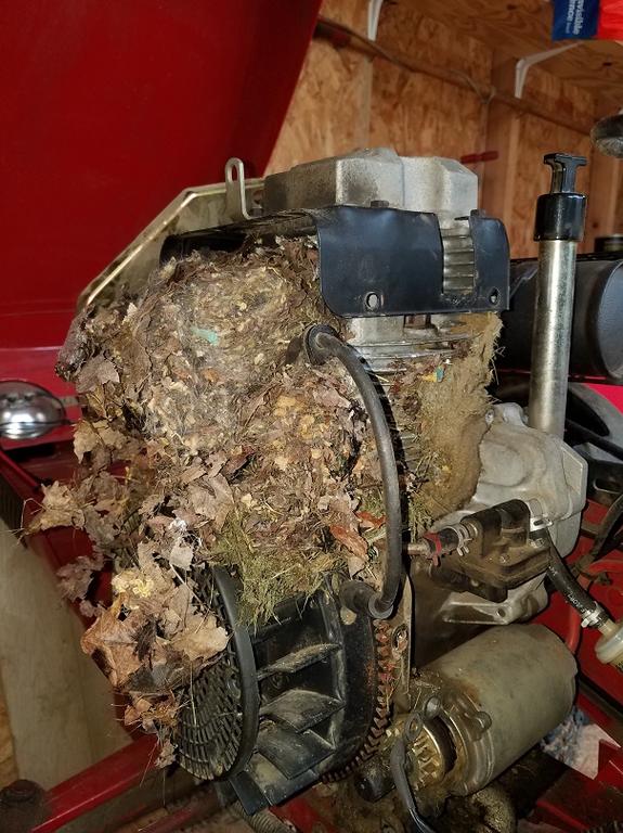

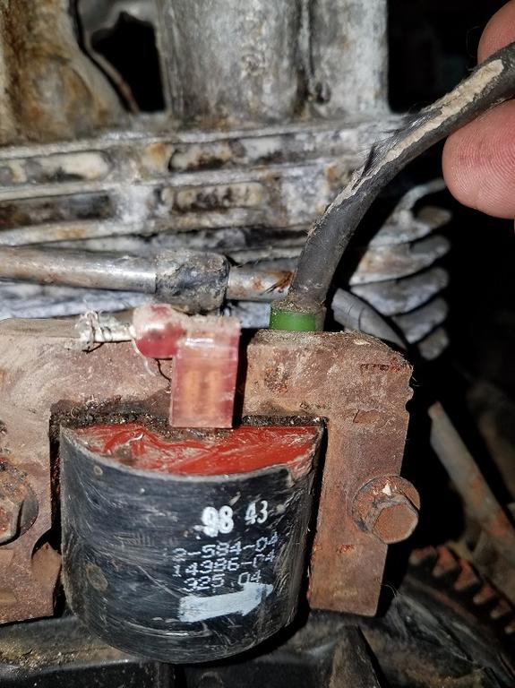

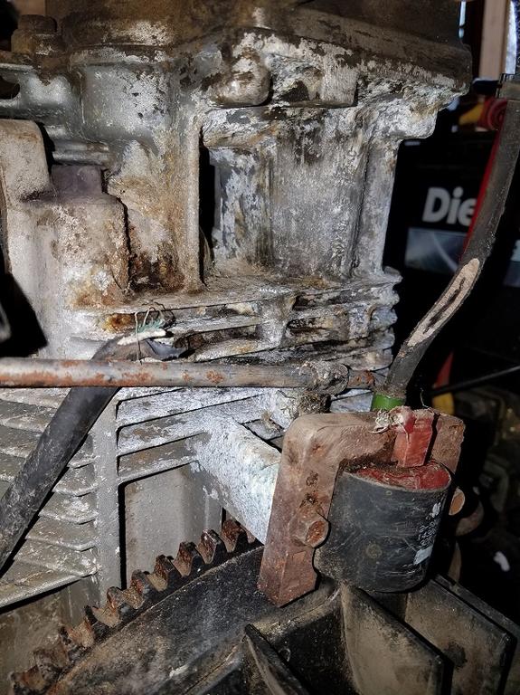

I've had my 314-8 for about a year.  Last summer, with the hood up and the engine running, I would occasionally see some grass and fluffy stuff blow out from under the engine covering near the spark plug area.  I finally decided to take care of it and took the engine cover off today.  It was BAD!  I got it cleaned up to the point you see below by just picking stuff off and using a stick to scrape between the air fins.  The little pests chewed through the insulation on the spark plug cable, and completely removed a section of a wire that leads into the ignition coil connector.
Questions:
- I'm going to have to splice in a new length of wire going to the ignition coil.  It has white insulation.  Anyone know the gauge of that wire?
- I've gone to my local Toro dealer for filters and stuff.  Is that the best place to go for ignition coil (& plug wire) and more, or is there a great place on-line to order parts?
- To finish cleaning the engine (fuel & electrical connections, various metals, plastic, and rubber), what is a good mild cleaning solution?

Yep...Them's mice!!! Looks like you evicted them just in time!
I'd hit it with the air compressor and let the air do the final clean...

Primary wire to the ignition coil is typically 16 or 14 gauge. You can get the good stuff (pre-tinned) at any marine supply store or on eBay or from Amazon. But the stuff you can buy from Home Depot works just as well.

Holy Cow it is a wonder the engine did not over head with the mouse condo you had under the tins.

I don't think there's enough wire on the ignition coil's connector, so I'll just buy a connector with a length of wire and hope it's the right gauge.
https://www.homedepot.com/p/Gardner-Bender-14-AWG-18-ft-Primary-Wire-Spool-White-AMW-334/300689781
