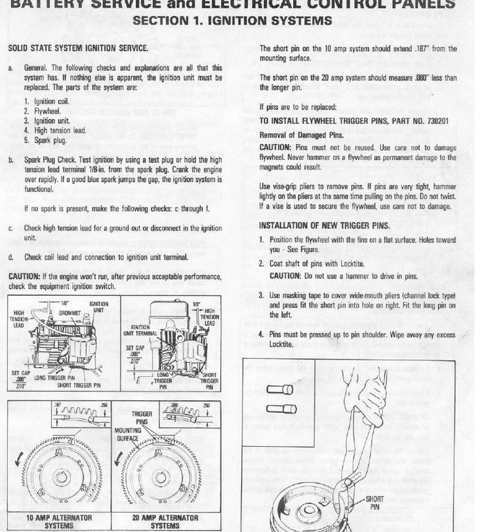

R. L. Addison 299 #4 Posted March 24, 2018 Can't do pictures yet, still have not been able to pay my support yet. Think i'm going to let a bill or two go to pay shortly.. That Tecumseh is mag run & ground to kill, am I right? Ron A. Share this post Link to post Share on other sites
Ed Kennell 39,903 #5 Posted March 24, 2018 file:///C:/Users/asus/AppData/Local/Microsoft/Windows/INetCache/IE/JHOZ30UX/Tractor 1969 Charger 10 1-7041 OM IPL Wiring 1-7041-P.pdf Raider was 8 speed gear drive. Charger was hydrostatic drive. Yes, the HH100 Tecumseh would be Magneto ignition. 2 Share this post Link to post Share on other sites
pfrederi 18,223 #6 Posted March 24, 2018 9 hours ago, Ed Kennell said: file:///C:/Users/asus/AppData/Local/Microsoft/Windows/INetCache/IE/JHOZ30UX/Tractor 1969 Charger 10 1-7041 OM IPL Wiring 1-7041-P.pdf Raider was 8 speed gear drive. Charger was hydrostatic drive. Yes, the HH100 Tecumseh would be Magneto ignition. It functions like a mag but it is actually a Solid State ignition system. Like the Kohler breakerless ignition the techy module is NLA and used ones that work come dear...so make absolutely sure you do not fry it by applying voltage to the kill wire. 1 Share this post Link to post Share on other sites
