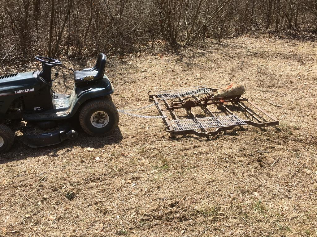

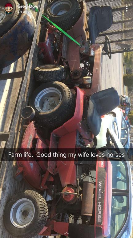

Slickbilly-D 40 #1 Posted March 22, 2018 Hello from central Indiana! Well, I traded a pistol and $200 for a 314-8 with 309 hours and a rough c-100. I started the 314 tonight, but I’m not getting fuel to the pump, gummed up I assume. Didn’t have time to mess with the c-100. I’m pumped to be tinkering with something again. I used to mess around with small block chevys but I don’t have the garage space nor money for hot rods. I hope to restore the c-100 and work the hell out of the 314. I have a 1/2 acre food plot for deer that I haven’t been able to successfully get the ground worked up to make a decent seed bed. I ve be been using my craftsman lt1000 and a Wizard for working the food plot and mowing. The craftsman mows decent but that’s about it. Cant wait to get the 314 mowing! 4 Share this post Link to post Share on other sites

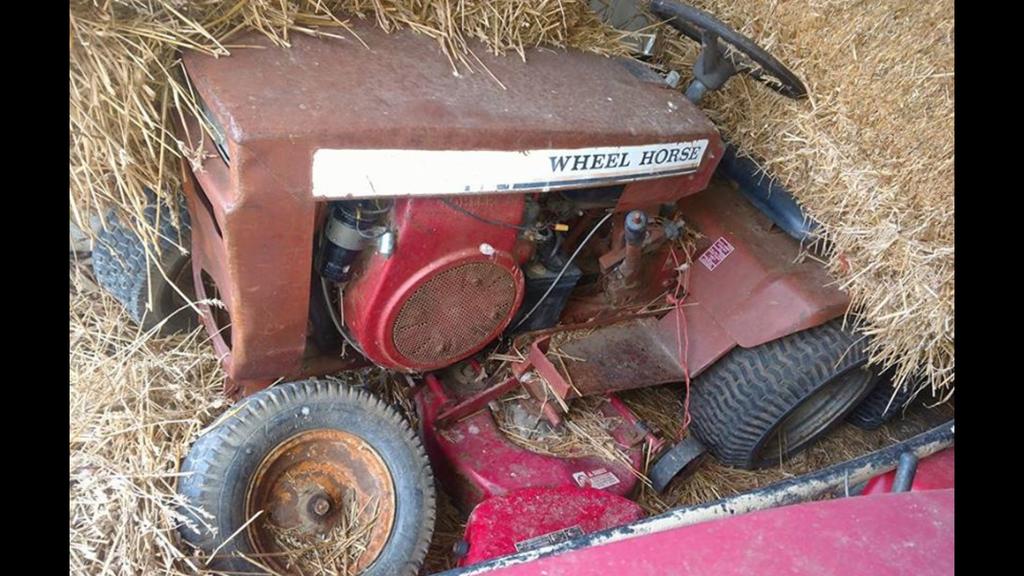

Mike'sHorseBarn 3,115 #5 Posted March 22, 2018 That is a nice score on two great tractors! The 314 will be a great worker for you, much better than your current set up lol As for the C100 it doesn't look rough to me other than what appears to be a broken spindle. Looks like it would make a fairly simple restoration assuming the engine and transmission are ok. Share this post Link to post Share on other sites

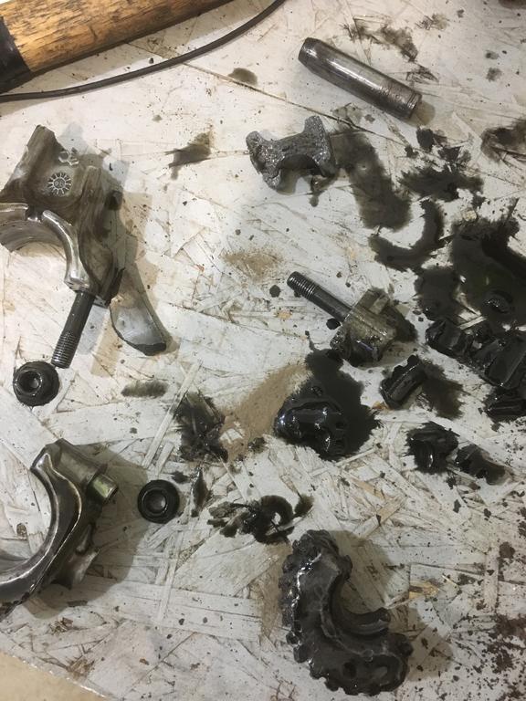

Slickbilly-D 40 #11 Posted March 23, 2018 314 didn’t run long! Lol oh well. I cleaned the points on the c100 and drove it to the shed. Let the work begin! 1 1 Share this post Link to post Share on other sites
oldredrider 2,553 #12 Posted March 23, 2018 How does the block look? I hope it's not ventilated. Must have never seen an oil change in 310 hours. Share this post Link to post Share on other sites
Slickbilly-D 40 #13 Posted March 23, 2018 2 minutes ago, oldredrider said: How does the block look? I hope it's not ventilated. Must have never seen an oil change in 310 hours. Hahaha block looks good. The gear on the crank assembly...not so much. I’ll dig more into it tomorrow Share this post Link to post Share on other sites

Slickbilly-D 40 #15 Posted March 23, 2018 1 minute ago, jay bee said: to Slickbilly...but that explosion is not a very nice welcome to the Wheel Horse world!!! The welcoming here makes up for it. I’ll get it cleaned up and rebuilt. 2 Share this post Link to post Share on other sites

Slickbilly-D 40 #18 Posted March 23, 2018 Block is busted. She’s toast. Total damage done: broken rod, broken counterbalance gear, busted block, governor gear disenegrated, piston has chunks falling off, and a busted chunk out of the bottom of the cylinder. ISO Kohler M14 lol 1 Share this post Link to post Share on other sites
richmondred01 2,287 #19 Posted March 23, 2018 Sent you a message. Thats pretty bad, sorry to see that happen. Those balance gears are problematic. Share this post Link to post Share on other sites
