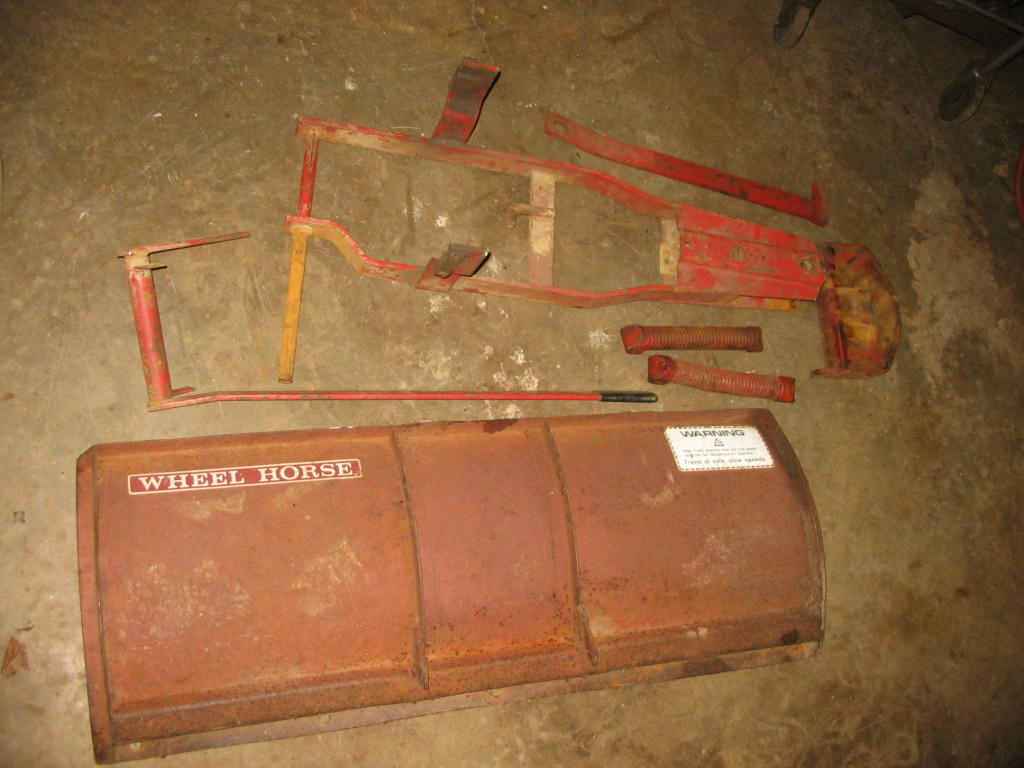

wheelhorse66 10 #1 Posted March 20, 2018 What wheelhorse does this plow fit?thanks Share this post Link to post Share on other sites
953 nut 57,473 #2 Posted March 20, 2018 Looks like it would fit most vertical shaft . This list will tell you. WH Interchange 1955-2000.pdf Share this post Link to post Share on other sites
daveoman1966 3,788 #3 Posted March 20, 2018 I have one like that....its for an A-90 or an A-100. Share this post Link to post Share on other sites
rlrnot 39 #4 Posted March 20, 2018 (edited) I had a Charger 8 that had a blade like that. I modified it with angle iron to use on my 310-8. Edited March 20, 2018 by rlrnot Share this post Link to post Share on other sites
