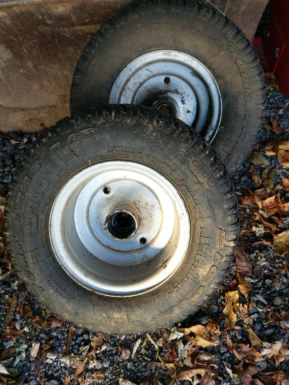

Front spindal question / C-175. Rim falls off
scott willey
still available from toro $44.00 each

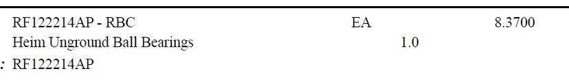

pfrederi
You can get US made Heim bearings (same brand as WH used years ago)  $8.37

11 hours ago, wallfish said:
Believe he's referring to these type. They're not tapered but roller bearings for the 3/4 spindle straight shaft x 1 3/8 OD
I wouldn't be comfortable using those roller bearings because they use the unhardened spindle as an inner race. I'll stick with a good quality sealed ball bearing.
 And just to beat a dead horse a little more ;-), I'll ask the question; Wouldn't a external snap ring be better then a "C" clip to hold the front wheel on?  I think so.
