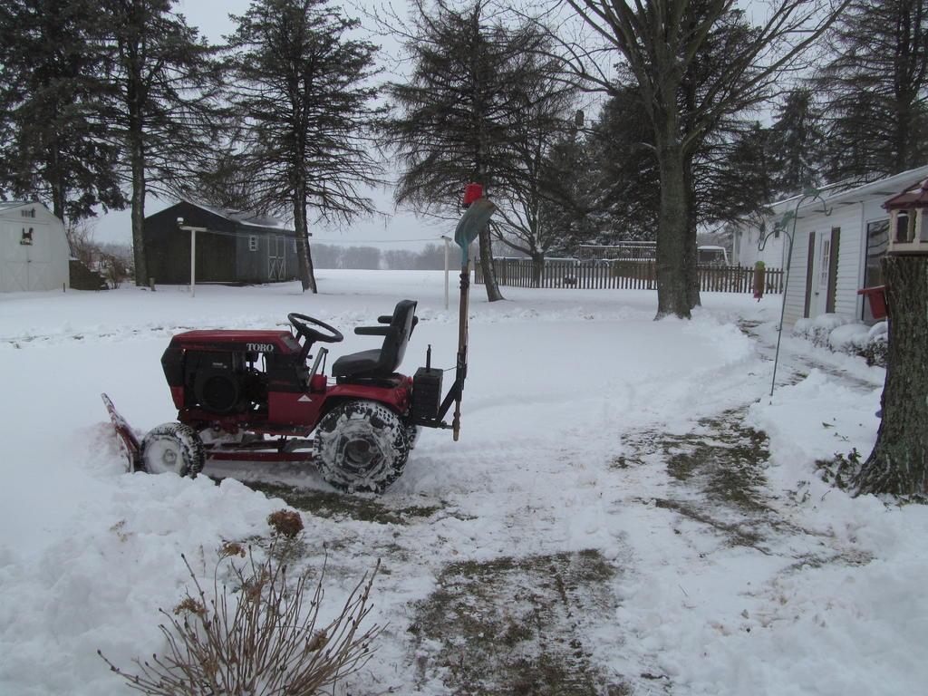

What's with all these storms you easties are seeing .... if Ed @Ed Kennell took off his snow equipment  like he was supposed it would be spring! :D
Didn't have to Jim.   Just the threat was enough to make it snow.  And BTW, Spring has arrived.

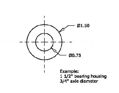

Tankman
1 hour ago, JERSEYHAWG / Glenn said:
Tank, what size would work?  Good idea. I like the quality.
Glenn
The ID axle OD dimension.
The OD (outside dimension) same as your rim's bearing housing (or close).
Example shown.
Thrust washer thickness depends on how much lateral movement you have; i.e.: 1/16" lateral movement? 1/16" thick thrust washer. :handgestures-thumbupright:
I have installed numerous thrust washers on front axles but, without measuring, forget the sizes.
QBC Bearings is quick delivery and reasonably priced. The '90 520-8 I restored needed thrust washers, works great when I
installed thrust washers. Zero wheel play and keeps grease in, dirt out. I have 'em on both sides of the rims if needed.
Edited by Tankman

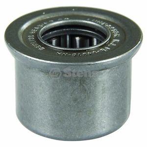

wallfish
5 hours ago, ronhatch said:
tarcoleo; Yes, interested!   What kind and size of (tapered?) roller bearing will take the place of the 1 3/8" OD X 3/4" ID junk ball bearings?
Believe he's referring to these type. They're not tapered but roller bearings for the 3/4 spindle straight shaft x 1 3/8 OD
