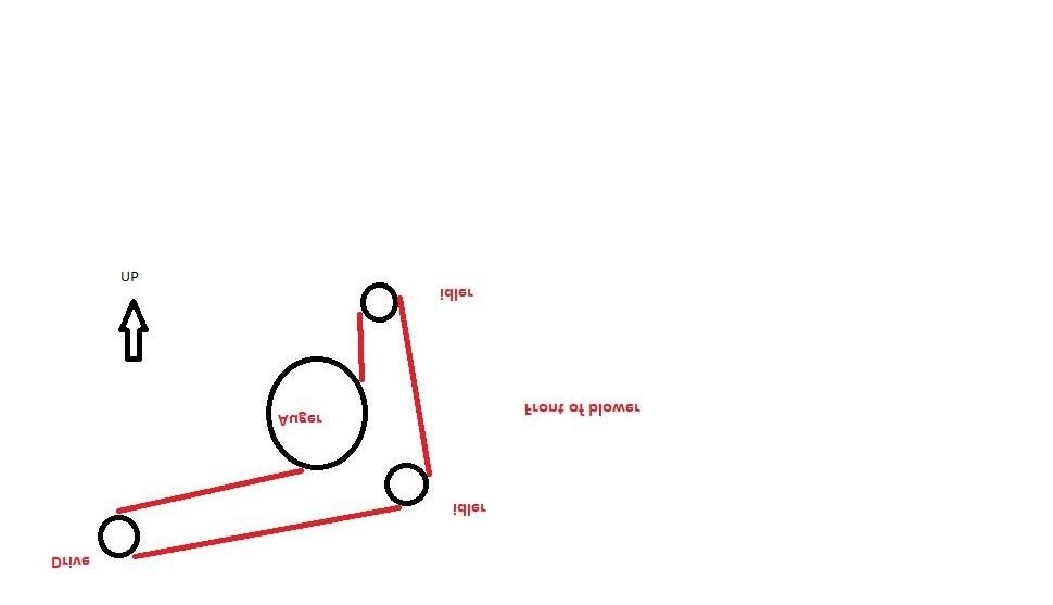

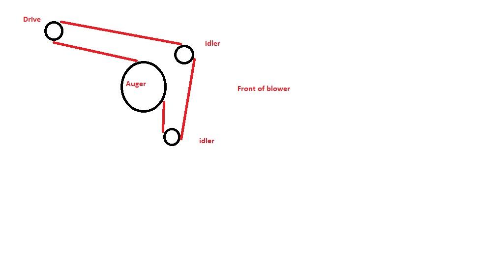

Being unfamiliar with all the blowers by the model number, here's a quick drawn diagram of the most common one. On all of them for horizontal PTO tractors, the chain needs to be routed so the auger gear is on the outside of the chain loop which effectively changes the direction of the rotation.
Sarge, he posted the model #  of his blower and has the manuals
Seems there were some older threads for reference using the search button but like many old posts, the pics are being held hostage by photobucket
Needs to be like this for proper direction of rotation.

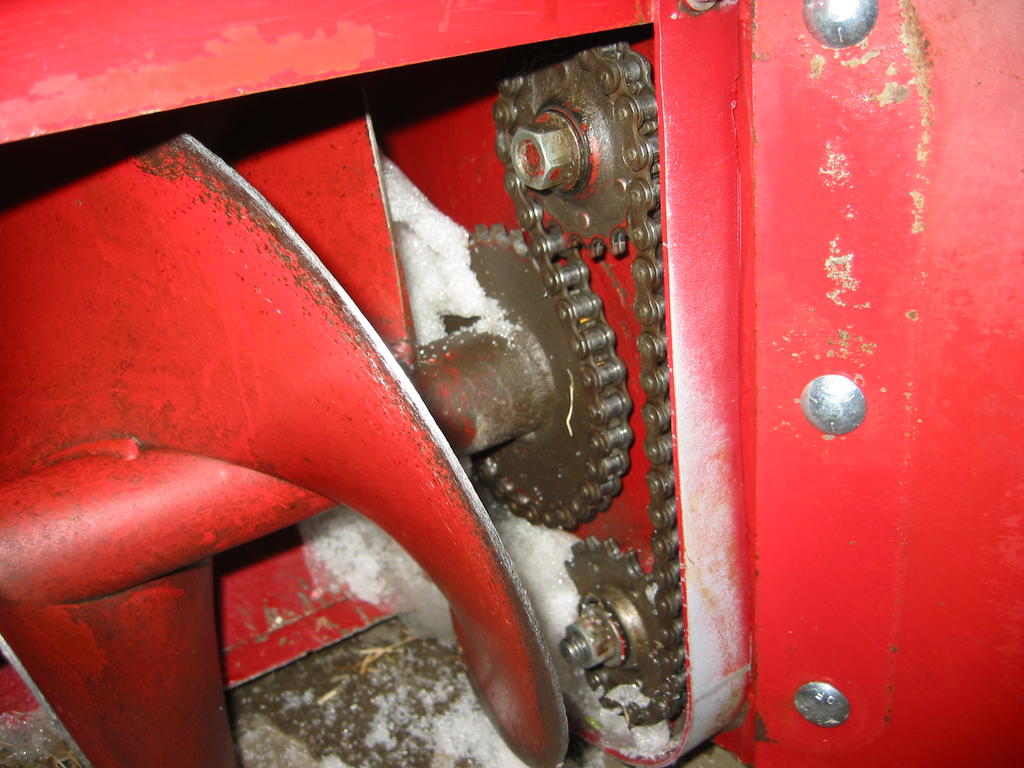

Here is a picture of my 42 inch blower (horizontal shaft engine)  Just used two days ago still has snow in her
Ooops, the direction of rotation is correct in the drawing but you are correct about the chain route around the bottom of the auger gear. Gives more chain contact to the gear too.

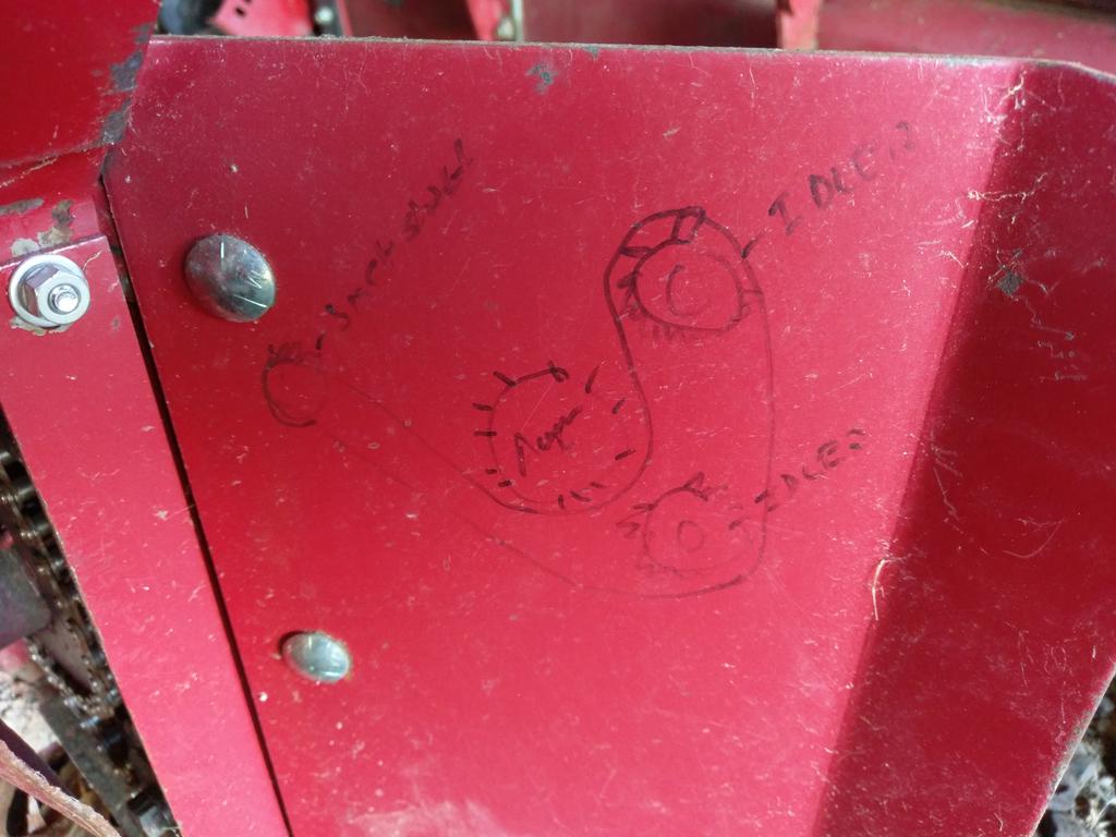

WVHillbilly520H
Easiest way to keep up with the routing is to do this (besides taking pictures)...
