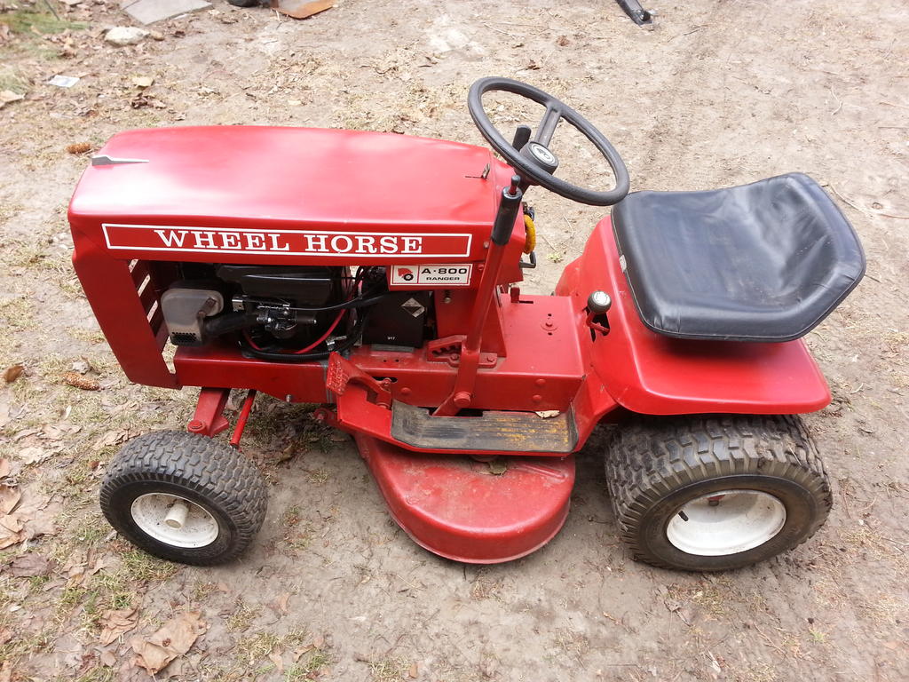

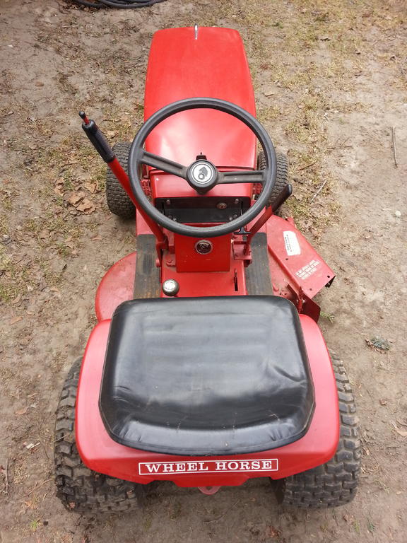

Finished up work on the A800 ranger. Time to figure out the c120.
The ranger got;
Complete rewire. 👍
New points.👍
Re-timed and a new head gasket.👍
Carb rebuild. 👍
Full service. 👍

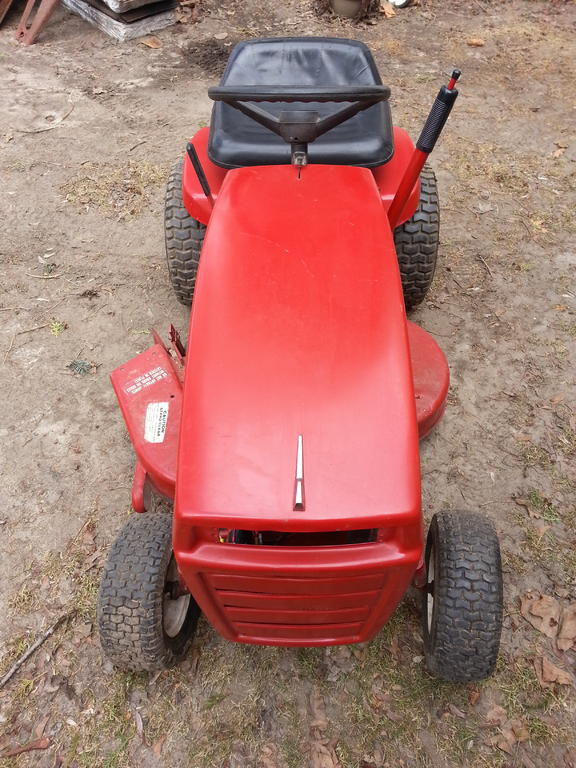

My daughter is gonna use it this year. She has just under 1/2 an acre to cut.

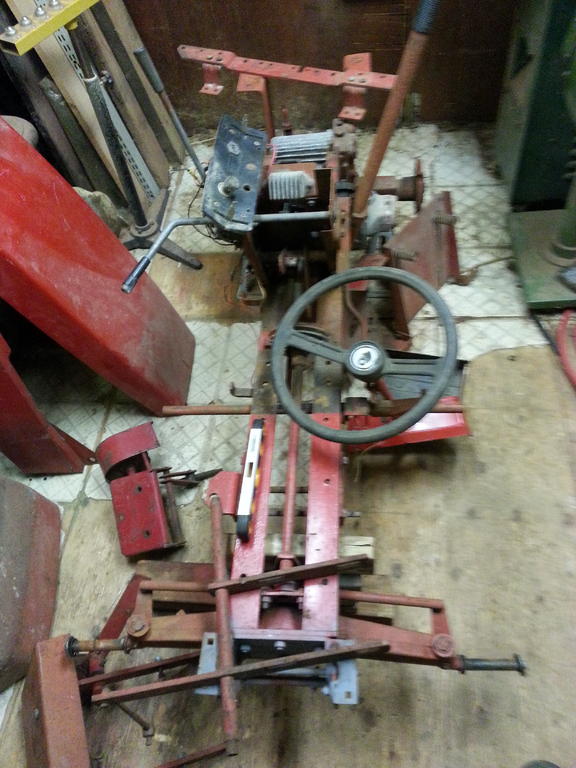

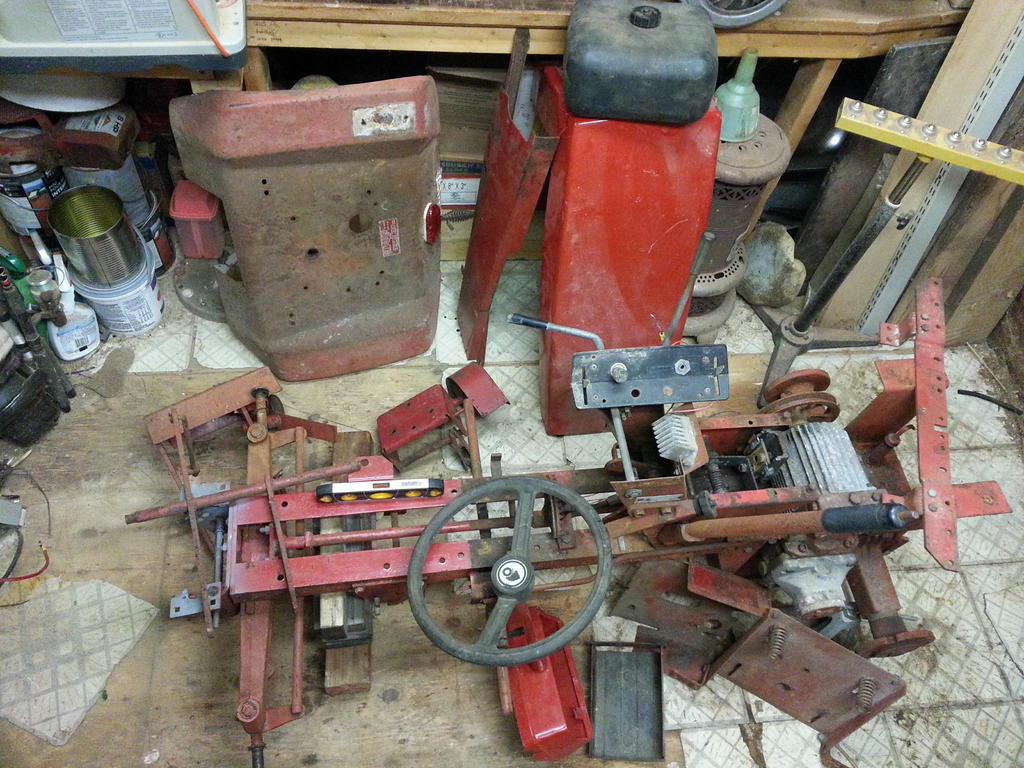

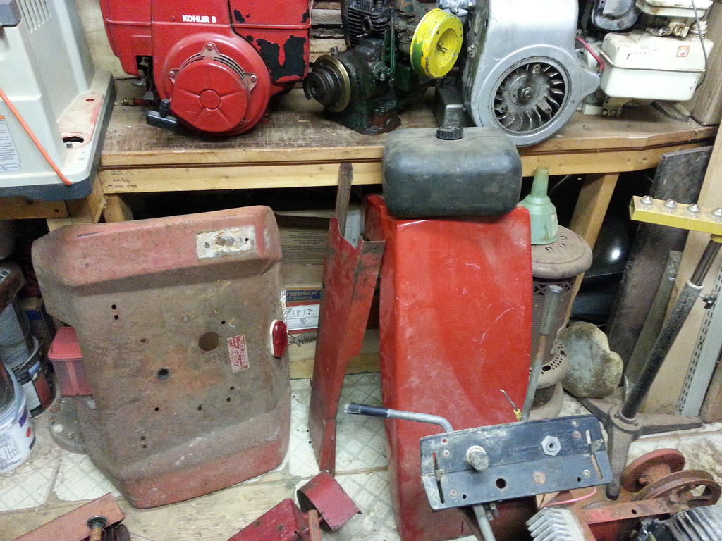

Now the challenge is the c120. Picked this up in Jan. Price was right and I was really just after the motor but the rest of it just had to come home too. Not sure if it's all there but the fun will be in finding out. So far I figure a broken clutch pedal and one rotted tire. The po had already taken it apart to restore but other things got in the way. The motor is stout and roars like a tiger.
I'm  gonna put it all back together first...... fix what I find then tear down to restore. :music-rockon:
It's the transmission I don't know about. Po said it works fine......... Hmmmmm.
Don't know much about them at the moment but "forum" research ans help here I come!!!

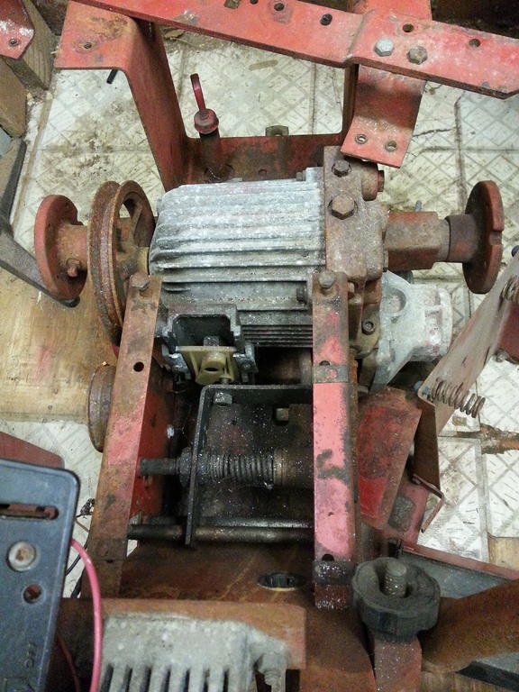

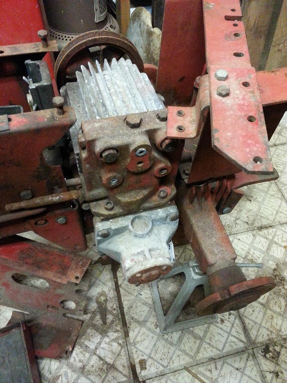

Transaxle oil is low but clean and the tow valve doesn't look like it's been loosened for a while. The frame sat outside for a year.
Thought I might change the oil and run it with an electric motor to see?????
The axles are free and smooth.
Anything I should be careful of?????
pfrederi
It is a piston to piston Sundstrand at least there are some things you can do to fix them up.and some parts are available if needed.  The older hydro gear units were pretty much repair by replacement.

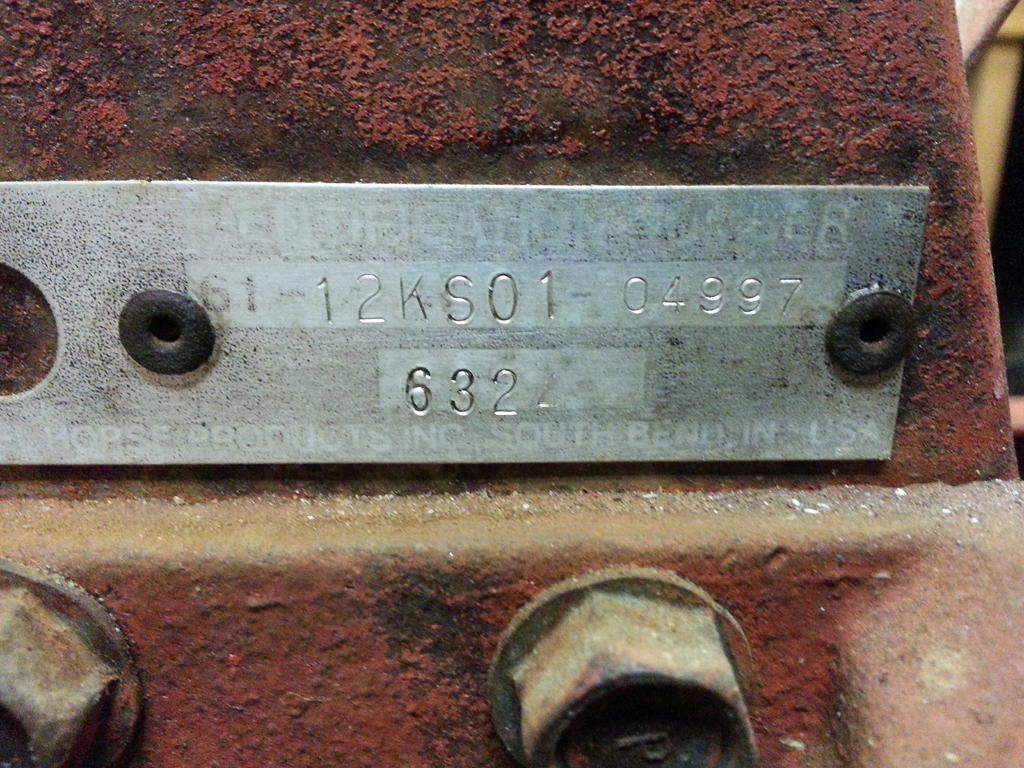

      The k301 for my c120 (bought the tractor literally in pieces but all there I think???? ) is missing the fuel pump. I've check the engine out with the ol  intravenous method and its . Ebay will sell you one for anywhere from $20 - $160. I know you get what you pay for but....... really?????
      Isave tractors has one in the $50 range. Any experience with the plethora  (is that really a word??) of 301 pumps out there?

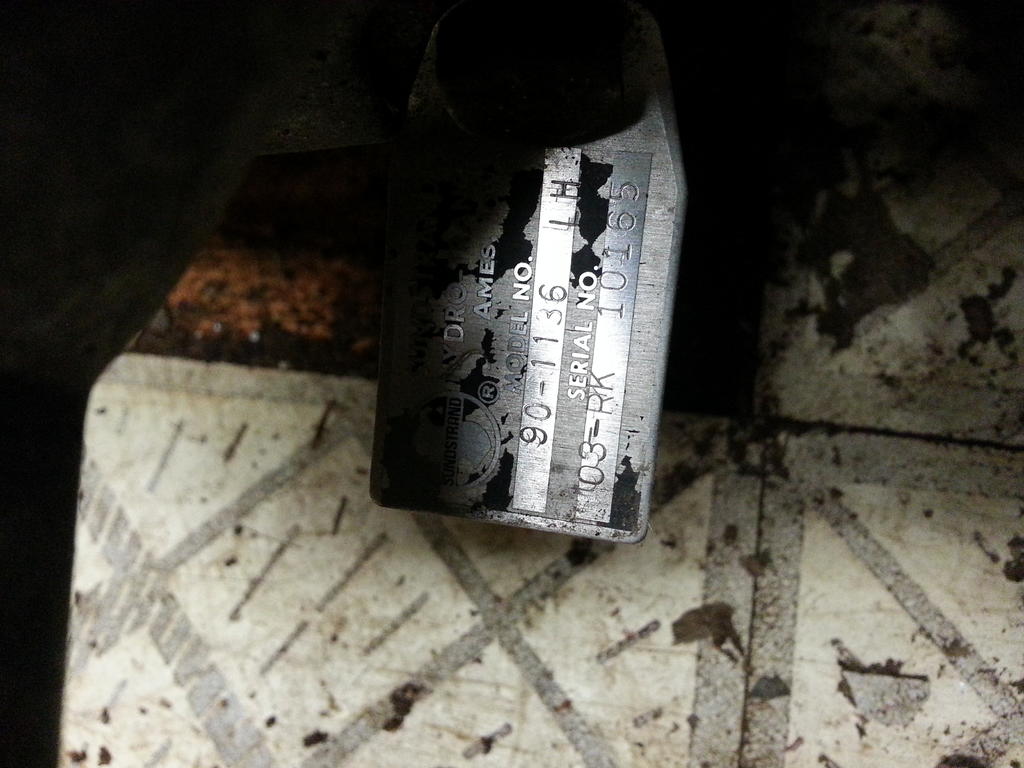

      Just scored what I believe to be a c120. But I'm not sure. It has the 3 speed unidrive, which I know is incorrect. Not sure if it's been swapped or if something else is out of place. It looks the serial number plate was stamped twice!?
