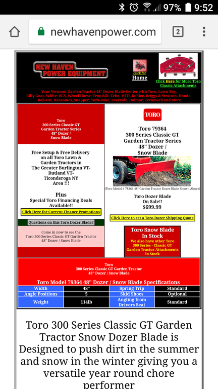

10 hours ago, BOB ELLISON said:
You have a 1997 520h and you can use almost all push blades from 1973 until 1997 but you have to use a extention kit for the blade to work with out hitting the front wheels when you turn.
Along with it really needs to be a 48" moldboard to push out past the tires while angled, and to answer your question of whether you can get a new one yes you can from New Haven Power Equipment in Vermont but like above you would still need the extension kit, Jeff.
