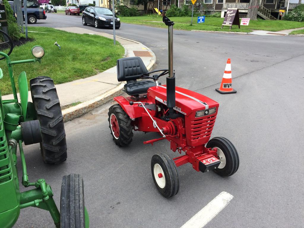

squonk 42,534 #2 Posted February 26, 2018 Eric, I had the darndest time with the noise my 1267 made. It had a pancake to start off with. I tried a couple of stacks and it quieted some but the quietest is this muffler I got from Jim Kemp. After the engine in this tractor went bad it was replaced and the new engine was quieter yet with this muffler. Since then I went with a short stack which is louder but not to the point of being obnoxious so I'm staying with the shortie. This stack pictured will be for sale at the show in PA. If interested PM me and we can talk. 1 Share this post Link to post Share on other sites

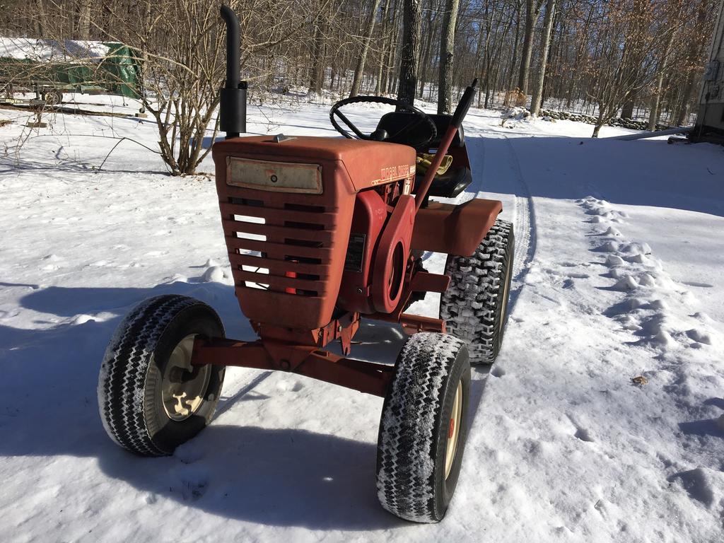

JPWH 6,251 #11 Posted February 27, 2018 @ebinmaine this is what I made for my custom 12. I am going to make a shorter version in the near future. 3 2 Share this post Link to post Share on other sites

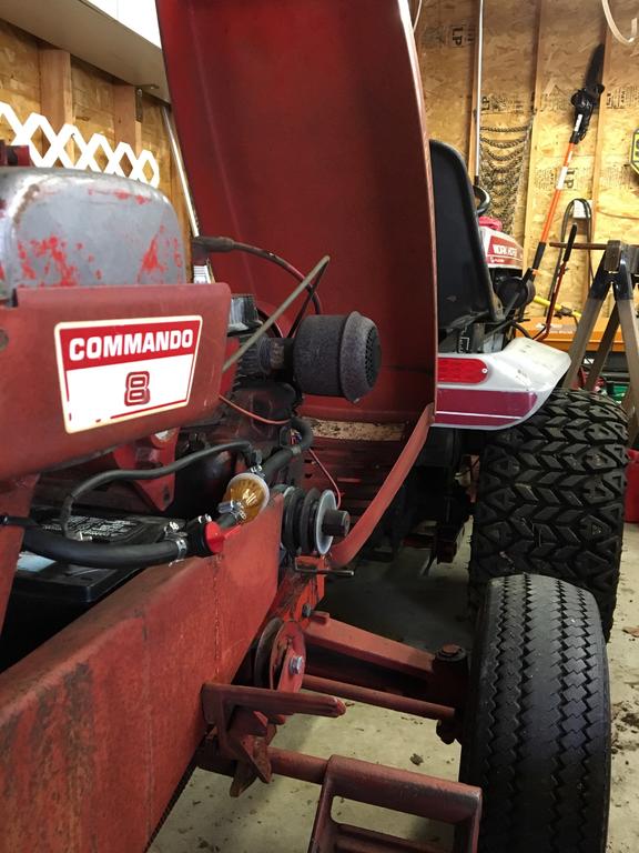

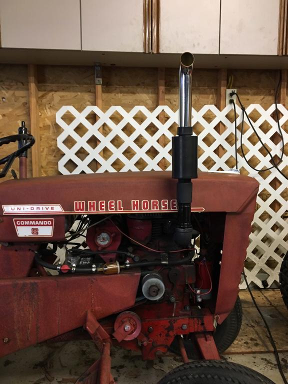

Sparky-(Admin) 22,074 #14 Posted February 27, 2018 The stacks that Bud Andrews was building are nice and quiet. I'm not sure if he is building them anymore. Picked up a couple of brand new ones from Aldon at Stevebo's meet-n-greet this fall and installed the first one on my Commando. Its definitely quieter than the original muffler which was 50 years old and rotted out near the bottom. These have 1" threads so they would work on a C-160....just not sure a 16 would be a quiet as my little 8hp Kohler. I painted the chrome portion with hi-heat black....chrome just didn't look right. 5 Share this post Link to post Share on other sites

squonk 42,534 #17 Posted February 27, 2018 Bush's muffler on a 14 has a little bark to it. The stack I have in my picture is quiter 2 Share this post Link to post Share on other sites
