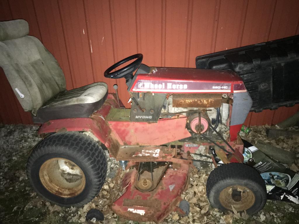

Dave Roach 4 #1 Posted February 24, 2018 I'm new to the forum & new to the pulling sene i have a 520-HC & am thinking of trying to set it up to pull it. Has anybody ever tried pulling a Hydrostat before & if so how do they do? Planning on trying the "Grass Cutter" class first to see how it does. Any imput would be appreciated! Thanks! 1 Share this post Link to post Share on other sites

Ed Kennell 39,735 #4 Posted February 24, 2018 to the Dave. I am not a puller, but I'm sure you will find the hydros are not the best for pulling. The Eaton 1100 in your 520 is a great hydro, but the fact is all hydros requires a significant amount of HP just to run the pump. This is lost HP that never gets to the ground. Due to the HP loss in the WH belt drive system, they are already at a disadvantage against the shaft drive tractors. It does require HP to squeeze the belt into the V pulleys and to pull it out of the Vs when it leaves the pulleys. Someone recently posed the question of using a chain drive or cogged belt to eliminate this loss of power inherent in a V belt drive system. I feel this would work well with the WH where the PTO would be used as the drive clutch. I am kinda kicking myself for not using this drive system when I built my Low Rider Crazy Horse. Guess I'm starting to ramble like @Sarge . There, you have my two scents err sense err cents or however you spell it. I wonder.....when the penny is eliminated from our monetary system, will we still be able to give our 2 cent opinions? FYI, this is a Crazy Horse 3 1 Share this post Link to post Share on other sites

953 nut 56,742 #6 Posted February 24, 2018 I think you will find that nearly everyone uses a gear box rather than hydro for pulling. Check out Brian Miller's site for some inspiration. http://gardentractorpullingtips.com/index.htm 1 Share this post Link to post Share on other sites

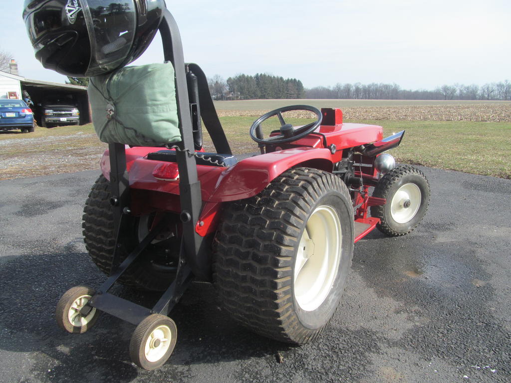

fast88pu 3,324 #10 Posted February 26, 2018 Give it a try. Put wheel weights on the rear an hang a 60" deck under it for weight. Be sure to have a pulling hitch and also wheelie bars for safety. Stock hitch height will not pull. Been there done that lol 1 Share this post Link to post Share on other sites
Dave Roach 4 #11 Posted February 26, 2018 (edited) 2 hours ago, fast88pu said: Give it a try. Put wheel weights on the rear an hang a 60" deck under it for weight. Be sure to have a pulling hitch and also wheelie bars for safety. Stock hitch height will not pull. Been there done that lol Thanks @fast88pu i have heard you need to put a stiffer spring on the bypass valve so when it gets in a hard pull it won’t try to bypass! As you can see it’s gonna take a little TLC just to get it running! But hey if ya don’t try you’ll never know right? Edited February 26, 2018 by Dave Roach Share this post Link to post Share on other sites
Notfishin 64 #12 Posted March 2, 2018 Dave if your going to pull that in grass cutter class , you have to leave the stock hitch on it ! 1 Share this post Link to post Share on other sites
fast88pu 3,324 #13 Posted March 2, 2018 21 minutes ago, Notfishin said: Dave if your going to pull that in grass cutter class , you have to leave the stock hitch on it ! Here it is 10" height max 1 Share this post Link to post Share on other sites
