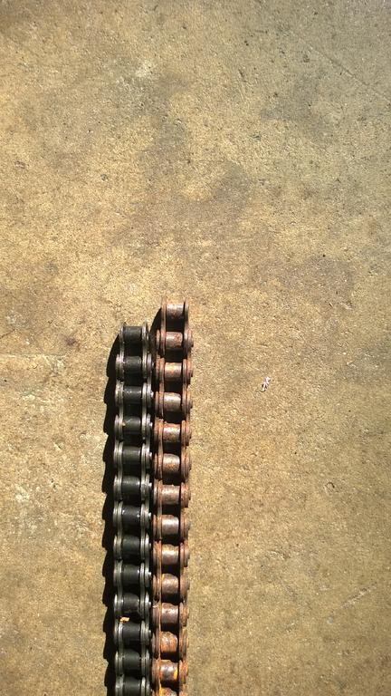

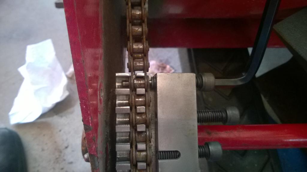

shallowwatersailor
12 hours ago, pfrederi said:
Just to clarify...  Chains do not stretch.  The sprockets can wear down and the chain then sits lower in it making it looser.  To a very small extent the rollers in the chain can wear and the pins can also wear loosening the chain.
It may be just a question of semantics. Here is a photo of a new chain on the left and old chain on the right. They are both 32 links but you can see that the old chain is "longer." It probably was still serviceable but it is best to change out chains every other year. I also included a shot using a chain breaker as I don't care for master links.

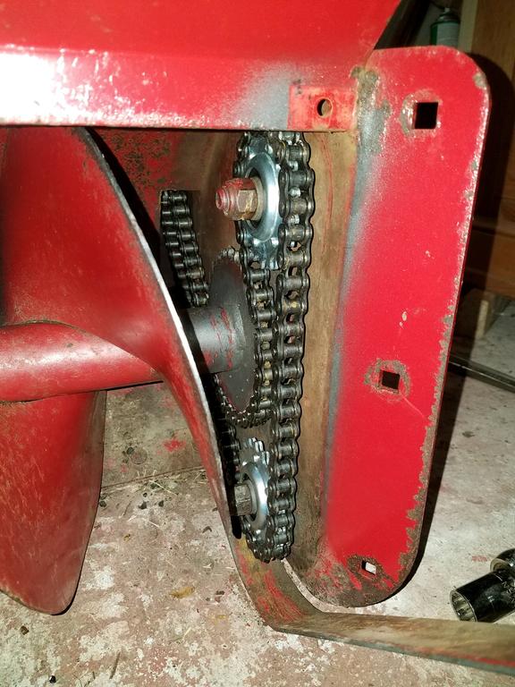

Master link disappeared 10' out into the driveway.  Ended up shoveling 8" of the heaviest snow I've seen.....all 70' of my driveway at 9pm last night.  So angry/sore today..  hahaa  more sore than angry.  I can't get this thing right.  Maybe I'm routing the chain wrong?  Maybe the master link is junk?

cleat
Make sure the clip on the master link faces the correct way so normal rotation forces it on and not off.
They do not normally just come apart on their own.

shallowwatersailor
Sorry for your troubles. It could have been a freak point in the rotation to throw the link off. That is why I used a chainbreaker so all of the links have the same "strength." Master links are fine if the chain doesn't reverse on itself like it does with the snowthrower. Also, a single-stage snowthrower revolves at a a higher rpm than a two-stage snowblower. When I had my Dxi, I use to run at a lower rpm because the diesel had tremendous torque and I had heard would overwhelm the single-stage snowthrower.

Ed Kennell
I had one link come apart before I realized I never slid the clip back, locking it into the groove in the pin.    After I assembled it correctly, I never had a problem.
