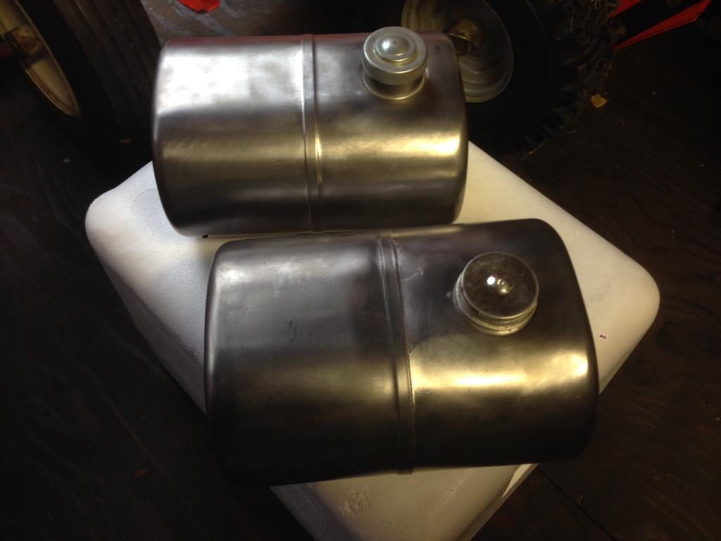

formariz 11,988 #1 Posted February 16, 2018 The RJ fuel tank isnot an easy item to come by. I have however found a few usable ones by looking for vintage go kart fuel tanks. Some are identical to the RJ tank and they do show up once in a while.In the two in the photo , the tanks is exactly the same size and bung location are within 1/2" of RJ tank. Drain holes are also close but those are not as critical.Filler neck is identical in one and slightly higher in the other( its actually a better one to use). I tried them and they work great. These particular two are flawless inside and out . 6 1 Share this post Link to post Share on other sites

formariz 11,988 #4 Posted February 16, 2018 10 minutes ago, WHX14 said: Care to share your source? eBay. I always search for vintage go kart fuel tanks. 1 Share this post Link to post Share on other sites
