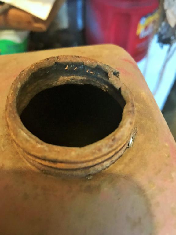

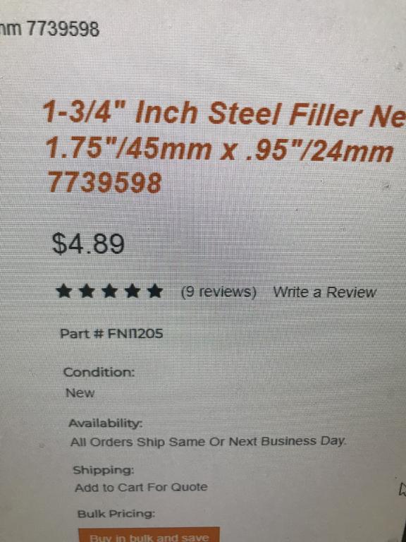

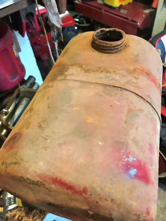

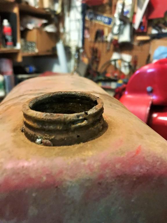

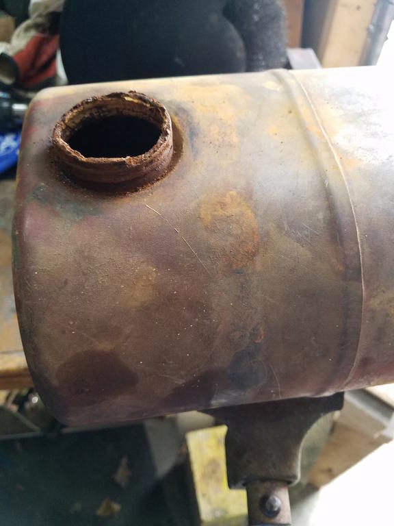

Lane Ranger 11,125 #1 Posted February 15, 2018 (edited) FYI Several folks have asked about replacement filler tubes for their damaged RJ (and other 1 3/4 inch threaded filler tube necks. Here is a source for them . I have two that I ordered last summer but have not placed on the tanks yet. I will be having an expert welder friend do this work for me. I can;t say if welding, brazing or some other technique is best for replaement but these filler tubes are the right size. NOTE: The lenght of the tube is longer than the original RJ gas tank neck. So it possibly could be raised higher or set to original depth. http://www.fillernecksupply.com/1-3-4-inch-steel-filler-neck-1-75-45mm-x-95-24mm-7739598/ Edited February 16, 2018 by Lane Ranger 9 Share this post Link to post Share on other sites

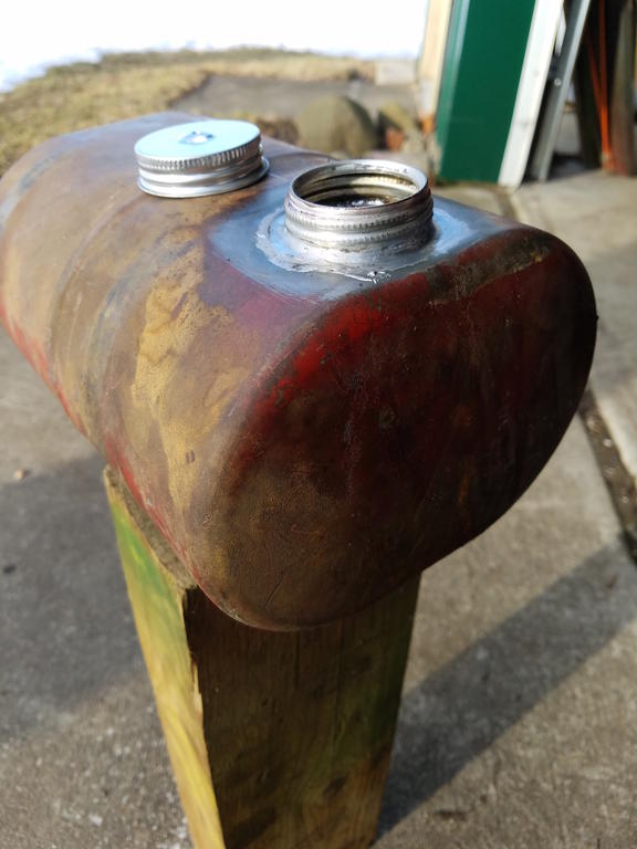

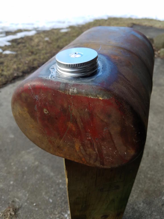

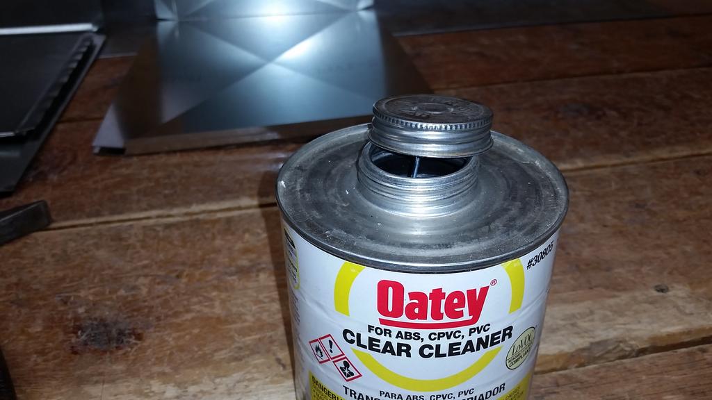

MoreyToo 68 #11 Posted February 16, 2018 I ended up doing some investigation and found the lid of a PVC primer can is the identical opening that is on my RJ gas tank. I soldered it on and it works perfectly. 2 4 1 Share this post Link to post Share on other sites

WHX?? 50,731 #13 Posted February 16, 2018 Yeah real good info there fellas. I go through a alot of these cans. They are a tad short tho. Let me know if there's a need for them I will start hoarding empties! 3 2 Share this post Link to post Share on other sites

MoreyToo 68 #15 Posted February 16, 2018 Here is the final product. 3 6 Share this post Link to post Share on other sites
formariz 11,994 #16 Posted February 16, 2018 Did you trim the flange to fit in recess? Share this post Link to post Share on other sites
MoreyToo 68 #17 Posted February 16, 2018 Yes, I left about an 1/8" flange at the bottom which kept it in shape. I then tinned both the top of the tank and the new neck. I used the typical acid plumbing flux and 50/50 solder with a good size soldering iron. 2 3 Share this post Link to post Share on other sites

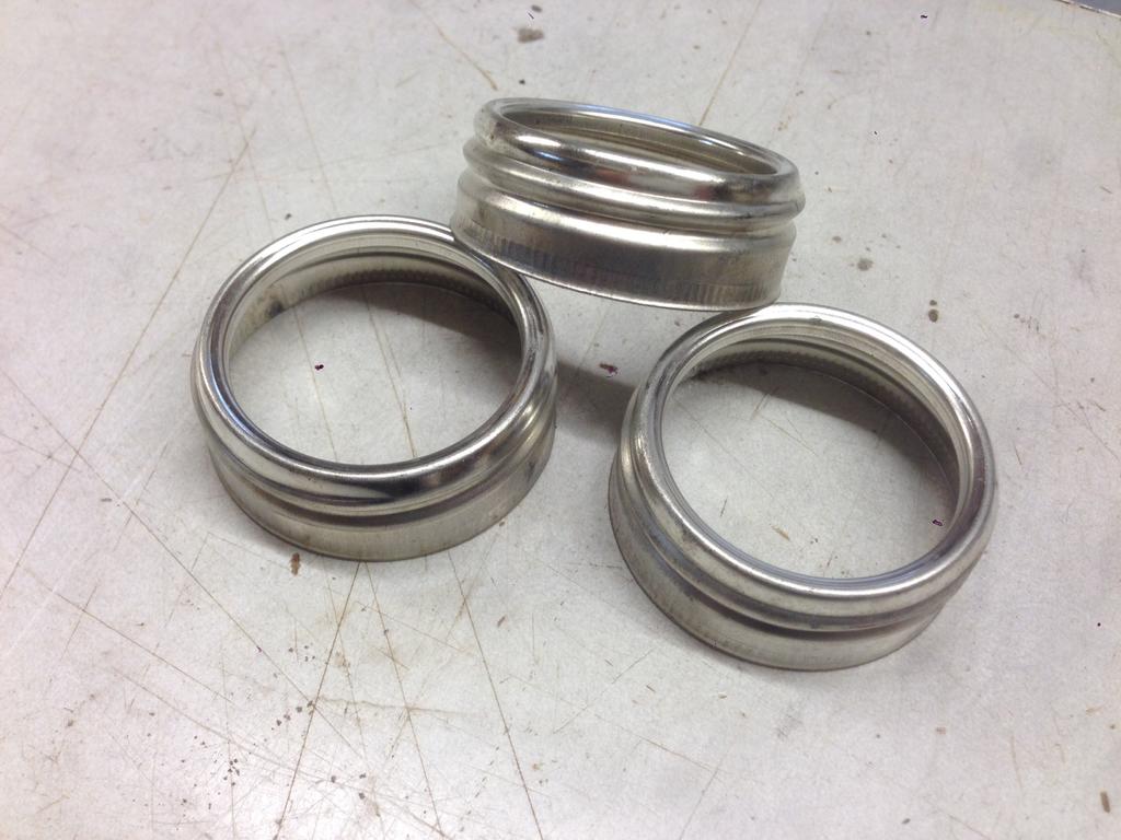

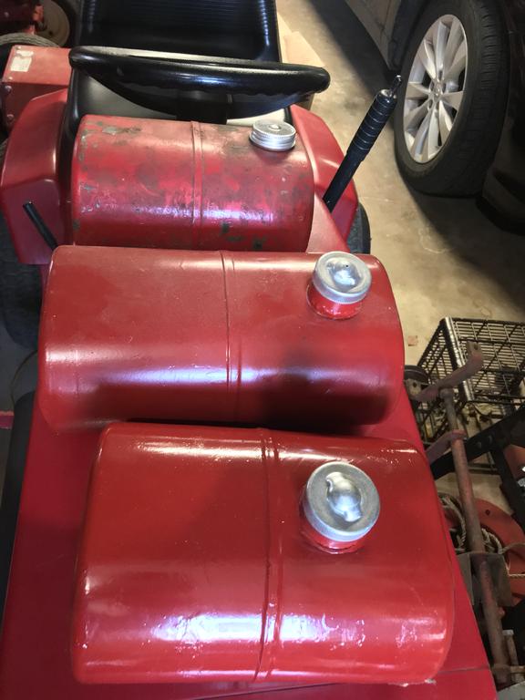

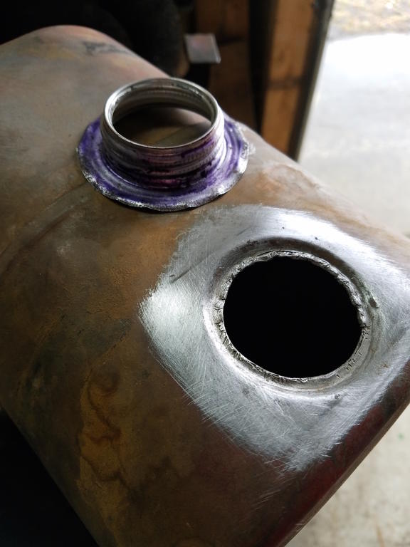

Lane Ranger 11,125 #24 Posted February 14, 2019 (edited) I used the style that was on the 603/633/704 gas tank. I bought mine from Filler Neck Supply, Inc. in Washington State. They were about $4.50 if I recall correctly. https://www.fillernecksupply.com/ They may make the kind formariz used but I do not recall seeing them on their webpages. Here are photos of the ones I used. Two of these tanks have the extended neck. They work great on the RJ hoods. Edited February 14, 2019 by Lane Ranger 1 Share this post Link to post Share on other sites

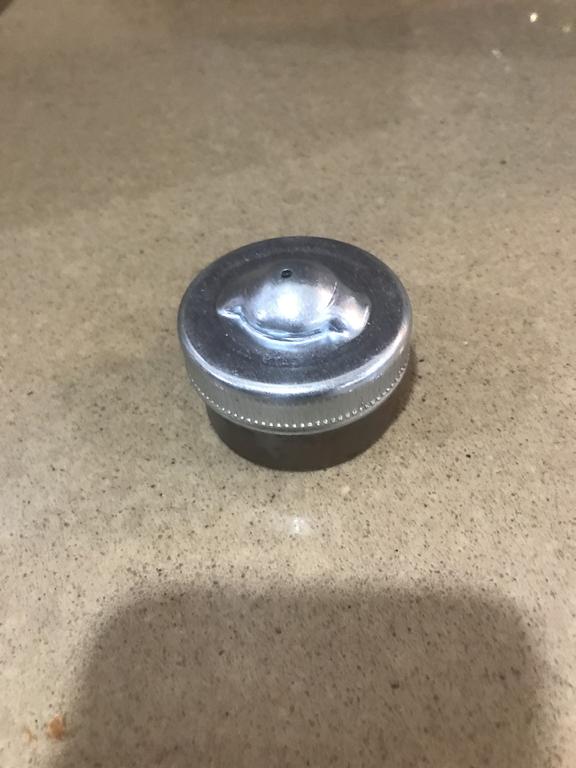

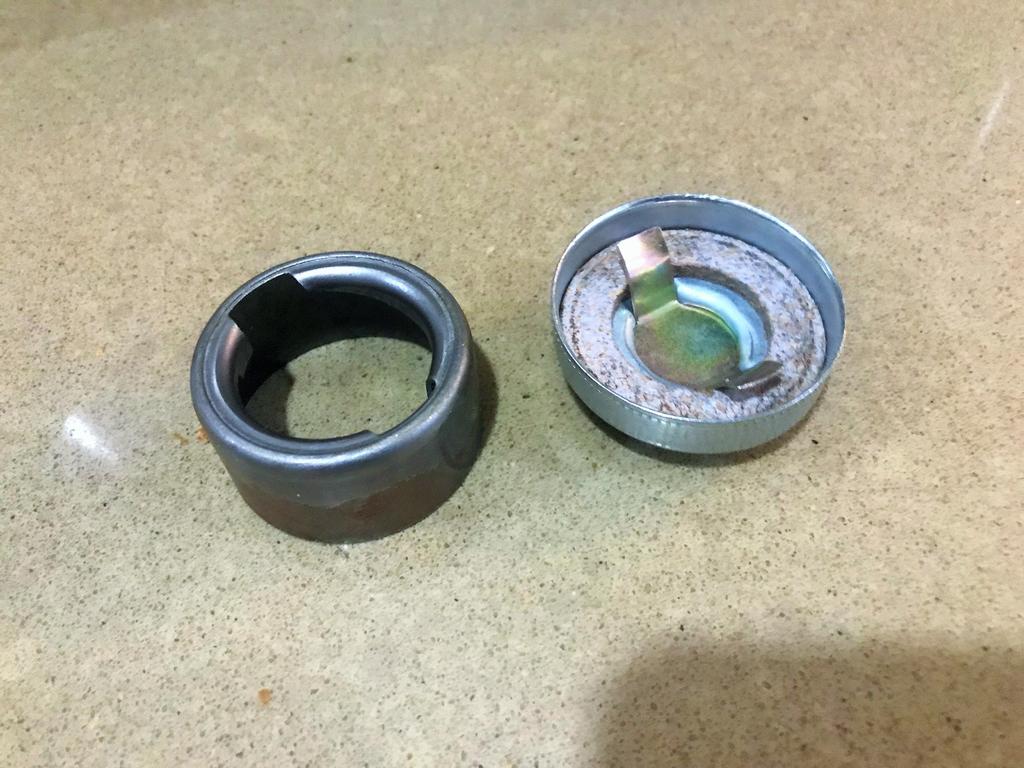

formariz 11,994 #25 Posted February 16, 2019 (edited) @dclarke @Lane Ranger @oliver2-44 FOUND IT! Finally located where I obtained the 1-3/4" tank necks and caps from . http://starboltenginesupplies.com/ Page 27 Item 560C CAPS & NECKS FOR FUEL TANKS 560 A Gas, Cap & Neck 1" --------------------------------- 1.00 560 B Gas, Cap & Neck 1 1/4" ----------------------------- 1.00 560 C Gas, Cap & Neck 1 3/4" ----------------------------- 1.00 Edited February 16, 2019 by formariz 2 Share this post Link to post Share on other sites
