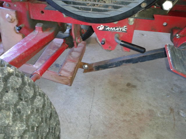

If hell bent on both for one tractor, maybe attaching a modified blade frame to the mid Tach A Matic ?  :twocents-02cents:

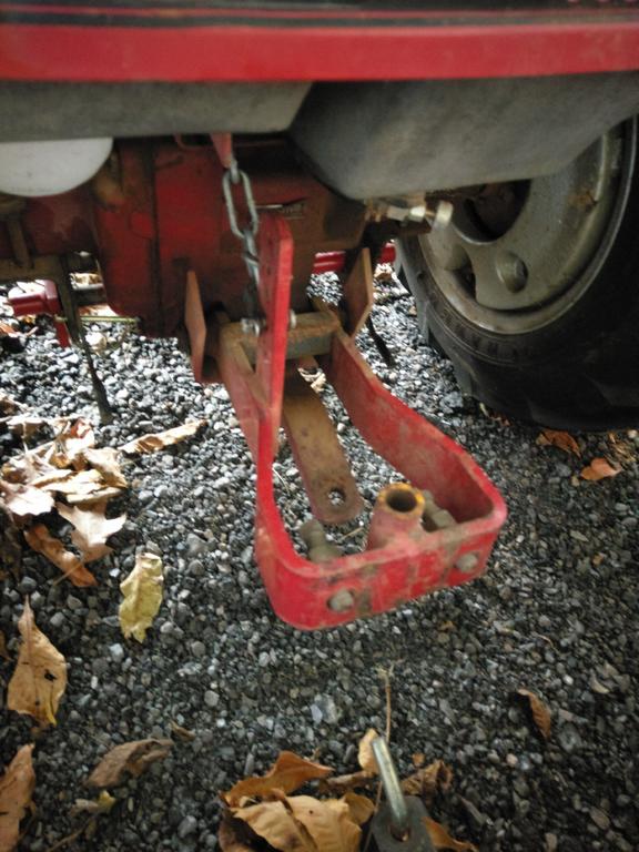

The xi series rear axle bracket is basically what you're talking about, but I'm still not sure it would work as you're wanting, Jeff.

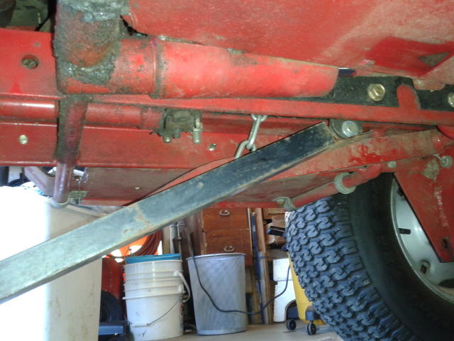

BOB ELLISON

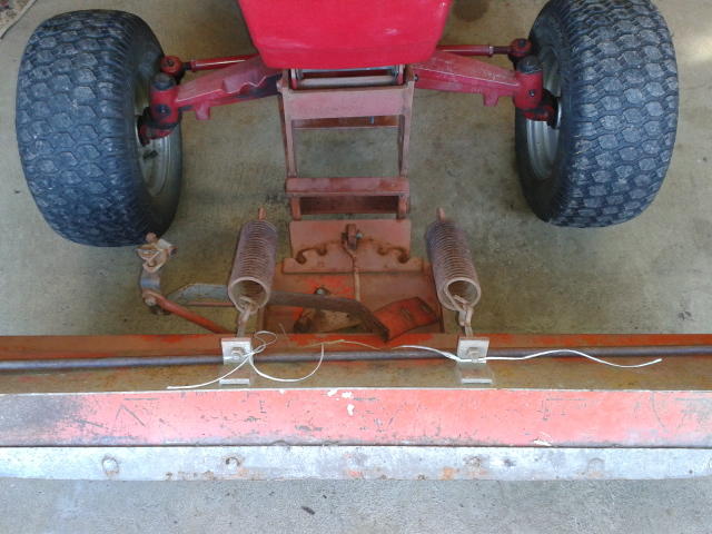

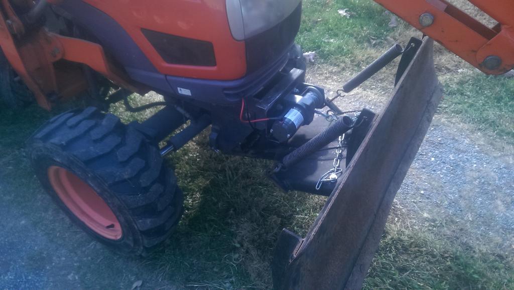

If you had one of these type of blades.
I got this with the 520h and the guy said he used it to plow snow. So I did connect it to the front and it worked like a champ.i even posted it here to see if anyone ever seen this type setup. but I sold the 520h and kept this very heavy blade. But the one thing that you would have to overcome is the lift for both on the cylinder. You would have to put a winch on front for the blade and use the tractor cylinder to lift the tiller. To bad your so far away or I'd sell it to ya
  • Like 3
  • Excellent 1

@WVHillbilly520H Thanks for the info on the XI series hitch. Is it the same width as a 3,4,5 and C series hitch. If so, maybe I could use one of them and not have to reinvent the wheel, or am I missing something?

@oliver2-44, yes I believe the xi hitch is the same width but a bit pricey $130 (shipped)new, and hard to find used, @BOB ELLISON, that front blade you have looks to be originally from a PowerKing as that was my first attempt on my Kioti before I went 4way hydraulic, Jeff.

I've considered doing similar and even splitting the rock shaft system in half so another cylinder could be used on the right side to mirror how the left side is built for hydraulic lifts. That would separate the front and rear attachments but require some heavy solid stock and machining a coupling to hold the two halves together in the hood stand. After a lot of consideration, measurements and like - it's just not worth that much work for what it yields. Doing it this way would give it front/rear separation but the weak design of the hood stand would have to be beefed up to hold the implement weight/force during travel and using either the front or rear attachment. I wanted it for two blades, one front , one rear for dirt and snow work. Using a rear cylinder is a better setup along with a dual spool valve but you're limited at what volume the hydro pump puts out somewhat.
From your description, your weak point is going to become the frame rails themselves and transmission mounting plate. Maybe if the frame was fully boxed which limits it's attachment uses would work but you'd have to tear it down completely to do it right. Me ? I ended up with a D-180 - a C-195 would be even better but none of them can beat a D for it's frame strength from what WH built . What you're describing really needs a heavier tractor to handle that weight/stress - a D will do the job but has it's weak points like the others.

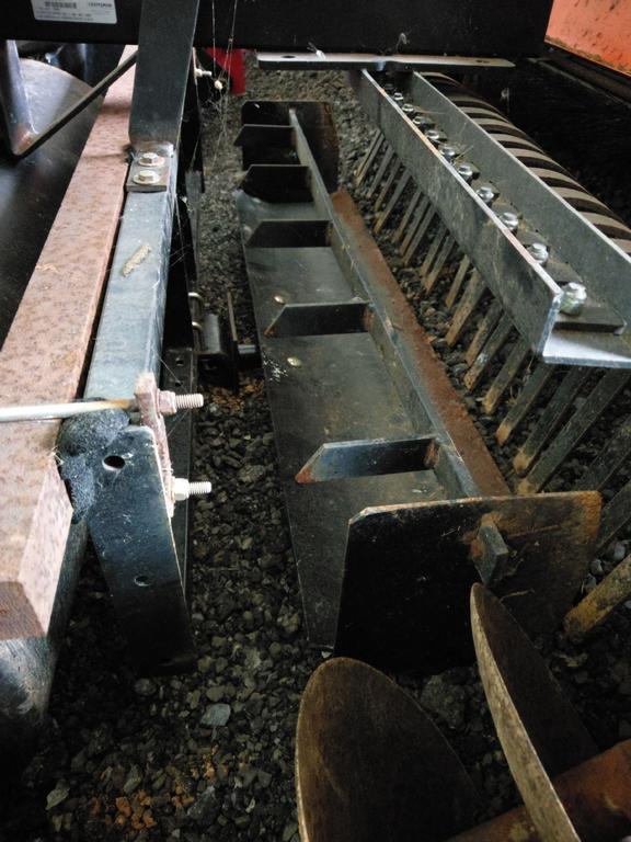

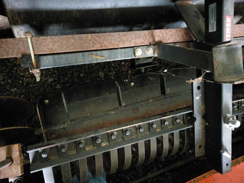

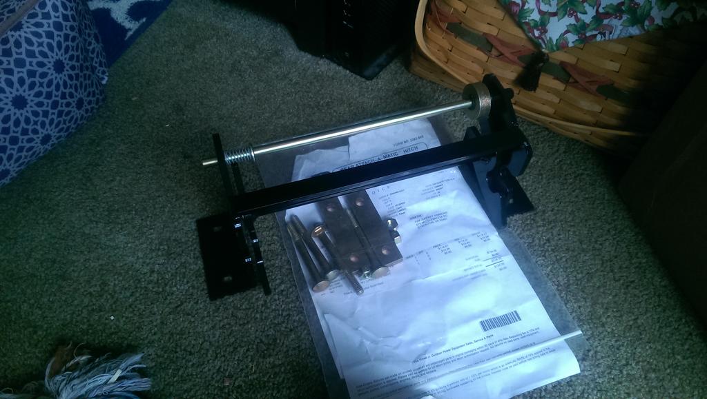

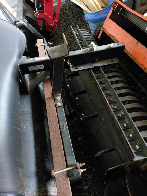

I have that box blade with the ripper teeth brand new. It's made by Brinly takes the Brinly hitch. I always think I'm going to take it to a show on one of my show tractors but after owning it for more than ten years and not doing that I probably would sell it. I can't believe I just said I would sell something!!!
  • Like 2

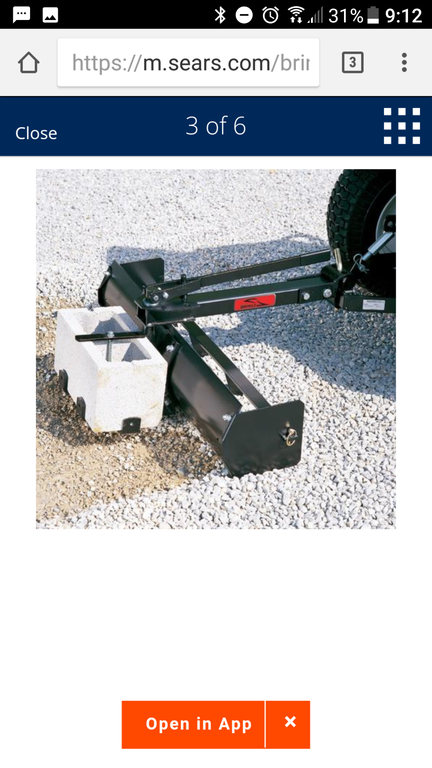

oliver2-44

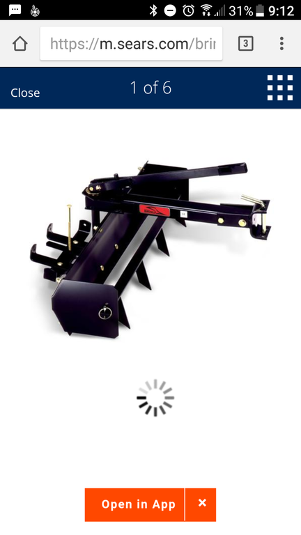

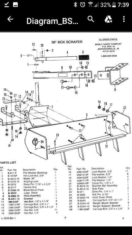

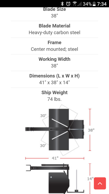

@c-series don I'd appreciate if you could post a deli tires of the box blade with a tape measure in them for reference. I have a Sears rear blade  that came with a non runner WH. I'd like to compare to see if it would be easy to make into a box bladei
WVHillbilly520H

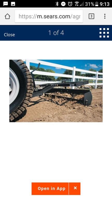

I have the agri-fab(last 2) version it's 42" but Sears and Northern Tool sell both brands Brinly(first 2) and Agri-fab here's a couple pics from their site, anyways with enough weight it does seem to OK, Jeff.
elcamino/wheelhorse
My son purchased the brinly from Northern and it really works well. He used it to level and clear his back yard which was full of fist size rocks partially buried in the soil.
  • Like 1
  • Excellent 1
c-series don
The first picture is the exact one that I have, if you need further dementions I can get them to you.
