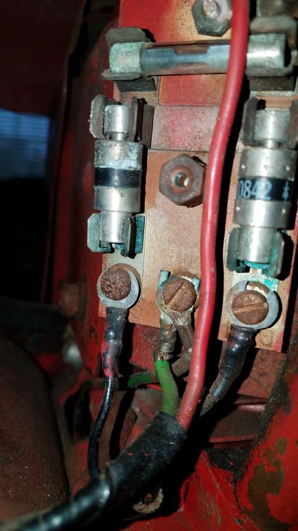

I got my 552 out today and found that the starter just spins and will not engage the flywheel. The battery is fully charged. One other thing associated with I noticed was the volt gauge stays "on." It used to only read volts when the key was turned on.
This particular tractor uses the switch to turn it on and push button to start it. I'm thinking my ignition switch may have gone bad. Any ideas?? Thanks!

Do you have a voltmeter or an ammeter? I suspect you have an ammeter.
The only wire on the ignition switch is the one that grounds the ignition to shut the engine off.
Wiring diagram here - click on the picture and then the small pictures once you get there and they will enlarge.

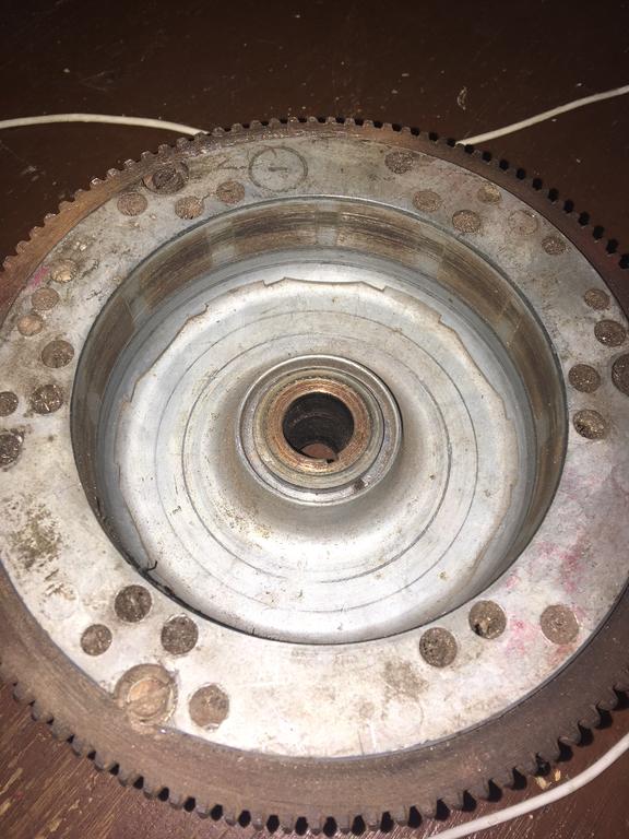

Anyway, the starter and Bendix works fine, I found that the gear on the flywheel is what is spinning. I can't find where a screw or whatever is missing from the flywheel. I am not sure what actually attaches the gear to the flywheel. I suppose I could tack weld it, but it does not appear that is what kept it from spinning to begin with. It actually spins very freely.  Any ideas :scratchead:
The gear spinning on the flywheel
Back of flywheel
None of these holes have threads - if you look into the holes while moving the teeth, there is nothing to engage the teeth ring.

Ring Gears on tractor flywheels are a shrink fit.  Heat the thing in an oven press it onto the flywheel.  I would assume it is the same here.  Why it started spinning is a mystery. I assume it started to slip and wore itself larger or ground down the flywheel.  I think the drilled holes (at least some of them) were part of balancing the flywheel.  Are there any cracks in the ring gear???  Especially from the bottom of a valley.
Since replacement flywheel wheels are not on every street corner I would think a few evenly spaced tack welds would work  Try to keep balance by spacing and size of tacks...

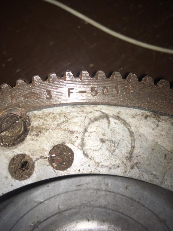

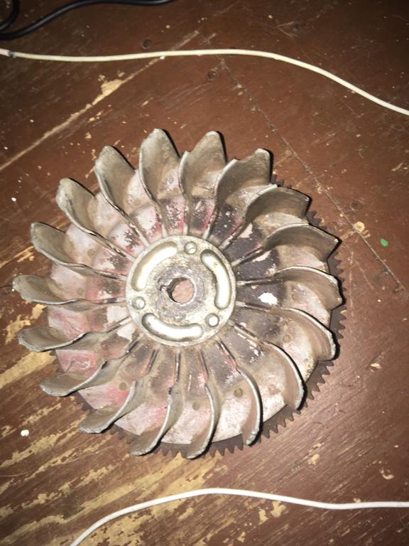

I have a flywheel from a 7hp teccy snowblower engine which you can have if you need it and the ring gear is the same. Magnets probably aren't the same. Guess we could count the teeth if necessary but I'll check to see if that number matches. The engines are deep in a storage area of the shed but they can be pulled out.
Found this stray flywheel on the shelf but the numbers are 3 F 5018 and the ring gear is held on by 3 screws, but think it could work. Unfortunately some of the fins are broke.
