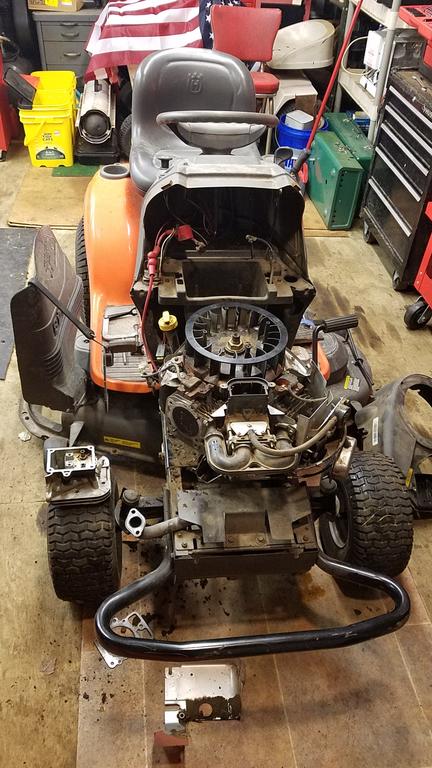

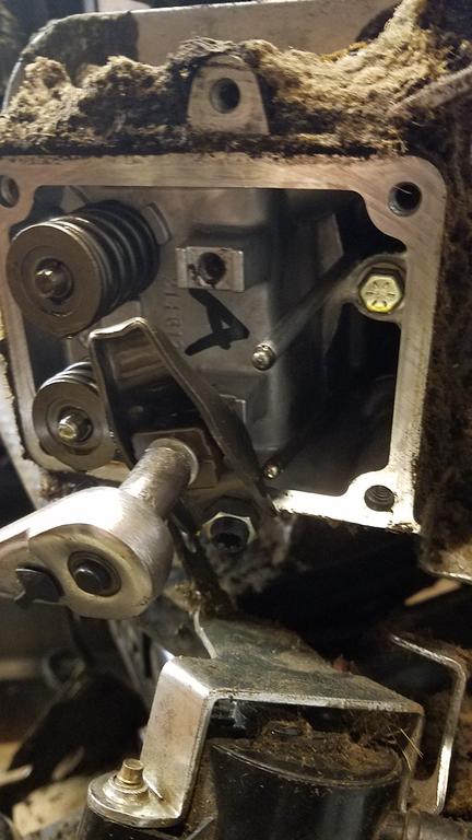

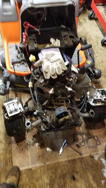

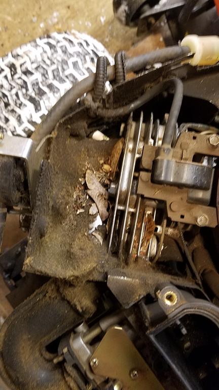

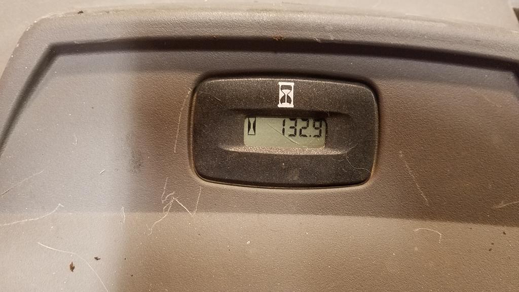

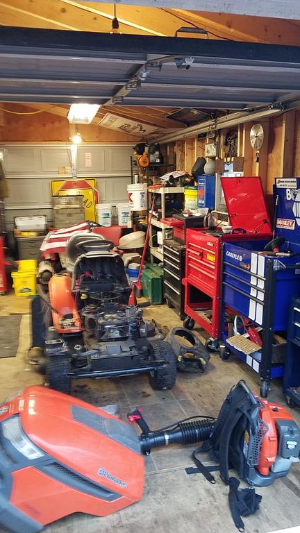

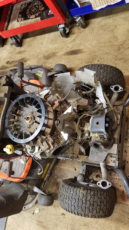

Docwheelhorse 2,684 #1 Posted February 3, 2018 Hello All, Acquaintance of mine bought pair of Husky lawn tractors off local dealer that took them in on trade when customer didnt want to have them repaired. Both running on 1 cylinder and purchased as is... One with gray rear fenders is a 2006 with 133 hrs... other is 2007 with unknown hours. Both have lunched both headgaskets... both full of grass / dirt / oil leaks and crud... both have overheated which caused guides to walk out of head far enough and crash into valve retainer and bend push rods. Gray fender tractor looks like it also suffered from the poor air cleaner design which if not sealed correctly causes the motor to suck dirt like crazy---I think its gonna smoke like a freight train when I get it back together. I agreed to fix both and told owner they may smoke and thats that... he is paying for all parts and I get a very very nice 310-8 with deck in running condition. So far im into it for about 3 hrs labor... going to clean heads, fix guides and order parts and Ill let everyone know how it goes. Guess they dont make engines like they used to... A Kohler K thats 45 odd yrs old still outruns these new fangled ones. Hey Sparky.... remember Claude? Yep there his... Tony 5 1 Share this post Link to post Share on other sites

Docwheelhorse 2,684 #5 Posted February 3, 2018 The inteks seem to hold together in the bottom end... ---but--- the heads are an issue. Get them hot and guides walk out... and crash into retainer. Bends pushrod and walla... runs on one cylinder. I love Briggs but this is a "poopy" setup... there are redesigned heads available but the kit is around $350 for 2 heads, head gaskets, intake gaskets, valve cover gaskets and pushrods. Plus the dealer labor to swap it all...Ill bet its a $750 job. Then theres the air filter base issue which causes dirt to get sucked in and tear the rings up. You would think the engineers could figure these "easy" problems out Tony 2 Share this post Link to post Share on other sites
Sarge 3,464 #6 Posted February 4, 2018 I'm starting to think they just don't care - look at how many of them now plug up the cooling fins so easily while others never plug up . Dunno, either lazy engineering or designed failure, hard telling . Many of the Briggs and even Kawasaki's have that air cleaner issue - generally just a simple re-ring will fix that issue but tearing into these modern units is such a labor-intensive job and just a pain in the butt I'm done dealing with them. Older stuff, sure - I'll work on that but some parts are becoming a problem and the fuel issues with ethanol are testing my boiling point these days. Glad I'm at the age I can just say no and I'm trying to get out of turning wrenches for others in my spare time - I've had enough and modern equipment is just getting worse all the time. For what this stuff costs - it should not be designed to be disposable. Sarge 3 Share this post Link to post Share on other sites

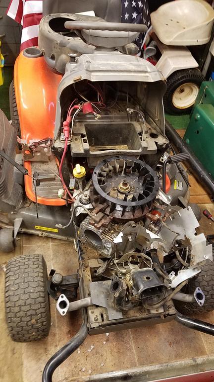

Docwheelhorse 2,684 #9 Posted February 25, 2018 Good Morning, So I cleaned up and repaired 3 pairs of heads while I watched the Daytona 500 last week. Yesterday I finished putting the gray fender 130 hr machine back together and to my amazement there was no smoke! Runs beautiful.... now I need to finish the other one. Tony 20180224_121436.mp4 1 Share this post Link to post Share on other sites
