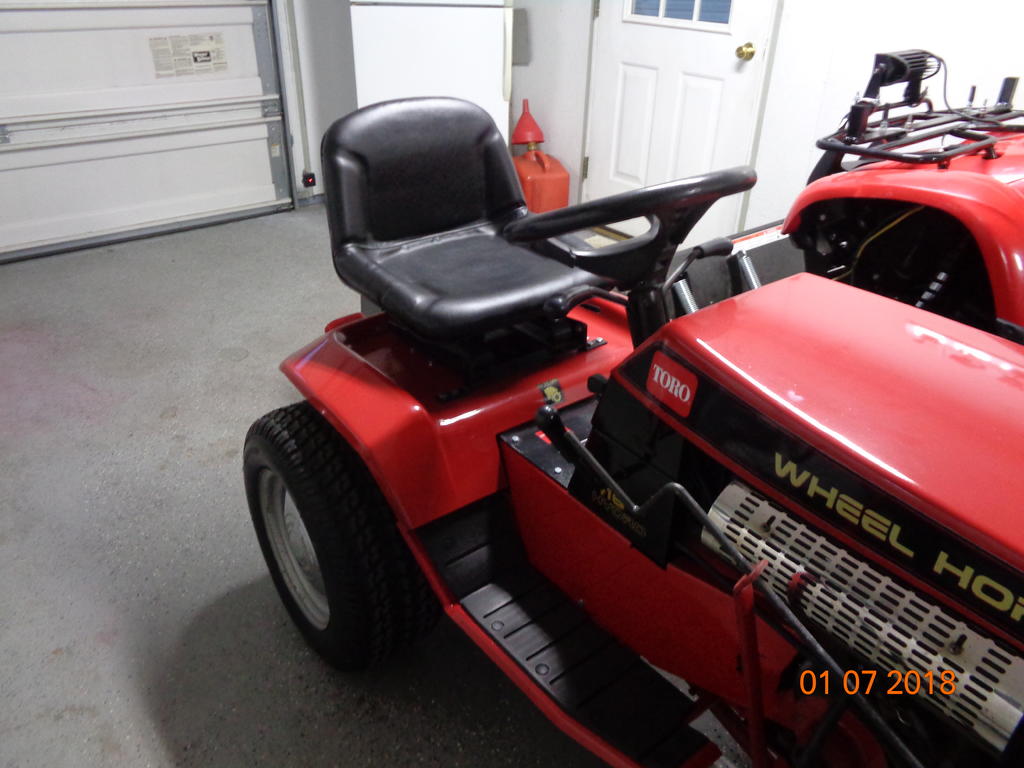

Searcher60 209 #1 Posted January 30, 2018 Can I actually buy just the vinyl and foam for my two Wheel Horse tractor seats? Share this post Link to post Share on other sites
Achto 28,124 #2 Posted January 30, 2018 (edited) 7 hours ago, Searcher60 said: Can I actually buy just the vinyl and foam for my two Wheel Horse tractor seats? This depends on which seat you are talking about. If you have the seat below. I was last able to get the covers for these from a Terry Wolfe 937-548-3781. I'm not sure if he is still selling them or not. For the foam, I layered carpet padding using glue to hold the layers together. Then I trimmed it to size & shape using an electric knife. If your seat is an injected mold style like this. It would be very difficult to reproduce with out some expensive equipment. Edited January 31, 2018 by Achto 2 Share this post Link to post Share on other sites
Ed Kennell 39,645 #3 Posted January 30, 2018 I have rebuilt several two piece seats with materials purchased at a fabrics outlet. 2 Share this post Link to post Share on other sites
chev0545 234 #4 Posted January 30, 2018 i take my seat's to my local upholster for $45 he completely does it over 9 1 Share this post Link to post Share on other sites
