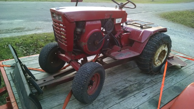

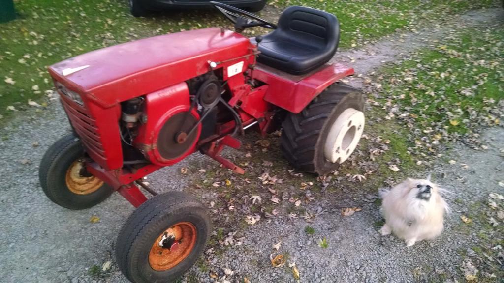

Achto 27,920 #1 Posted January 19, 2018 In Nov. of 2016 I spied this Raider 12 on CL. One thing that really caught my eye on this machine was the edition of a hydraulic lift. The hydro set up is a Century Fox, made by Hein Werner. So for about the price of the wheel weights, I drove it on the trailer and hauled it home. After I got it home, I drove it into the garage & that was where it sat until Oct. 2017. A local show was featuring and I wanted to bring all of mine that were in running condition. I threw a few band aids on the Raider and was able to take it to the show. Later that month @WHX14 was having a plow day so I thought it would be a good time to put this old girl threw some paces. After a few more band aids, a set of ag tires, & extra weights borrowed from @PeacemakerJack and a final inspection from my dog Sophi, she was ready to plow....? Before I was able to put the plow in the ground, the lift cable broke. Jim brazed a nut on the end of the cable & it was ready to go. Then the belt started slipping , a run to town for a new belt & away we go again.Then it was smooth sailing for quite a while until the charging system failed. At this point I gave up for the day. I also noticed that the right rear tire was covered in tranny lube. On a good note though the engine ran smooth and strong. After the holidays were over I decide to fix this thing the best way I know. Tear it down to nothing and start over. It took about 4hrs to get it to the point where Jim says it looks like a bomb went off in it. Then there was the steering wheel. After many hours, some colorful language, and some broken tools the wheel and shaft were finally separated. I have most of the small pieces ready for paint. The holes in the frame for the hood hinges were too far gone to even try to put a bushing in them. After welding them shut, I did some careful measuring and drilled them back to the correct size. Most of the sheet metal had some type of flaws that needed to be addressed. There were so many different seats on this thing during its life that the fender pan looked like swiss cheese. One of my favorite things to do is to make my own parts. After some fun time on the lathe I have a new front axle pin, pivot pin for the slot hitch, a rod for the hood latch, and bolts for the fender pan. Plenty of work left to get this tractor furrow ready. 15 10 Share this post Link to post Share on other sites

WHX?? 49,494 #8 Posted January 19, 2018 Maybe some pics of how that PTO was done off the flywheel side Dan. That's just something you don't see that often on a horse. Was it something homemade or some kind of thing from C-F in a kit form? If I remember right the HY pump mount was homemade? I CRS these days so don't remember how the lift cylinder/rock shaft was set up either? I think the rest of the furrow dogs here can attest to the value of HY lift at the end of a run! 10 hours ago, Achto said: brazed a nut on the end of the cable Reminder to have an extra lift cable on hand! Brazing a nut on the end of Tom's cable did not work so well! 6 Share this post Link to post Share on other sites

Achto 27,920 #12 Posted January 20, 2018 17 hours ago, PeacemakerJack said: I can’t wait to see you work your magic on another fine machine and I will be not only following this thread but hopefully getting my hands dirty at least once on this project if you’ll allow me... You're welcome to stop by any time Josh. You'll have to let me know where you'd like to jump in - body work, wrenching, or what ever. 13 hours ago, Shynon said: Looking good Dan, sure hope it will be ready to plow, not spend the rest of its days on a trailer Queen Thanks for the complement Tom. No worries on it still being a plow tractor, I'm not afraid to get a new set of coveralls dirty. 9 hours ago, WHX14 said: Maybe some pics of how that PTO was done off the flywheel side Dan. That's just something you don't see that often on a horse. I'll be getting to that. I also want to make a belt guard for it, I don't really like the idea of it hanging out there unguarded. 6 hours ago, ACman said: Maybe I should ship you the Cockshutt....at least I no it’d be done right . I don’t think Fastenal world ship it though ! Jeff, if my play cash account was a little larger I would be sending you a PM about getting that beauty into my hands.You're not that far away, heck we went all the way to Niagra Falls for the Cockshutt 20 Deluxe. I would absolutely love to add a diesel powered round nose Cockshutt to my collection. 6 hours ago, PeacemakerJack said: Dan’s not only a craftsman (as seen in this beautiful machine) but he is one nice dude. My kids talked about that for weeks! Dan Thank's Josh, your kids are great. I really like their enthusiasm for tractors. 4 Share this post Link to post Share on other sites

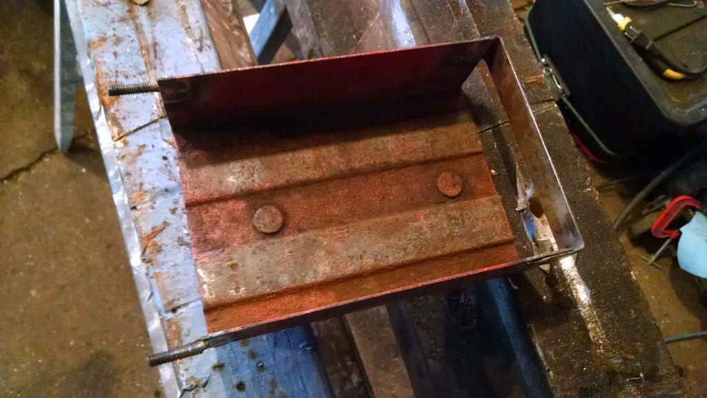

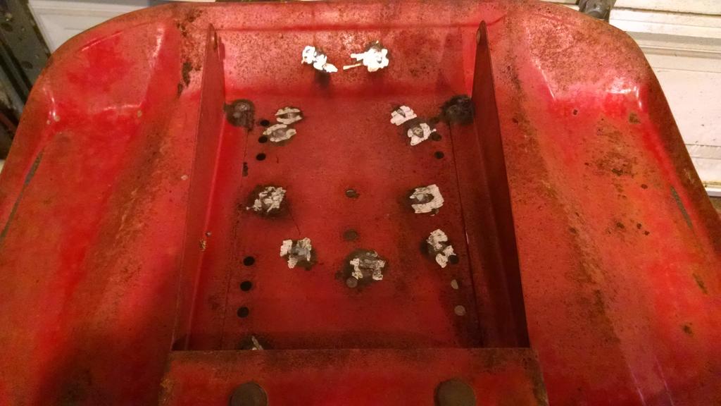

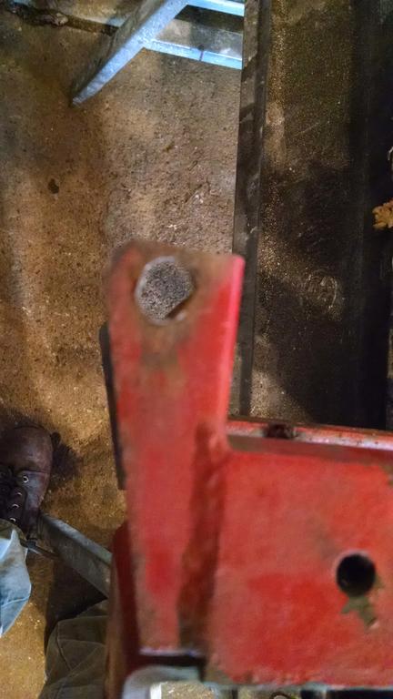

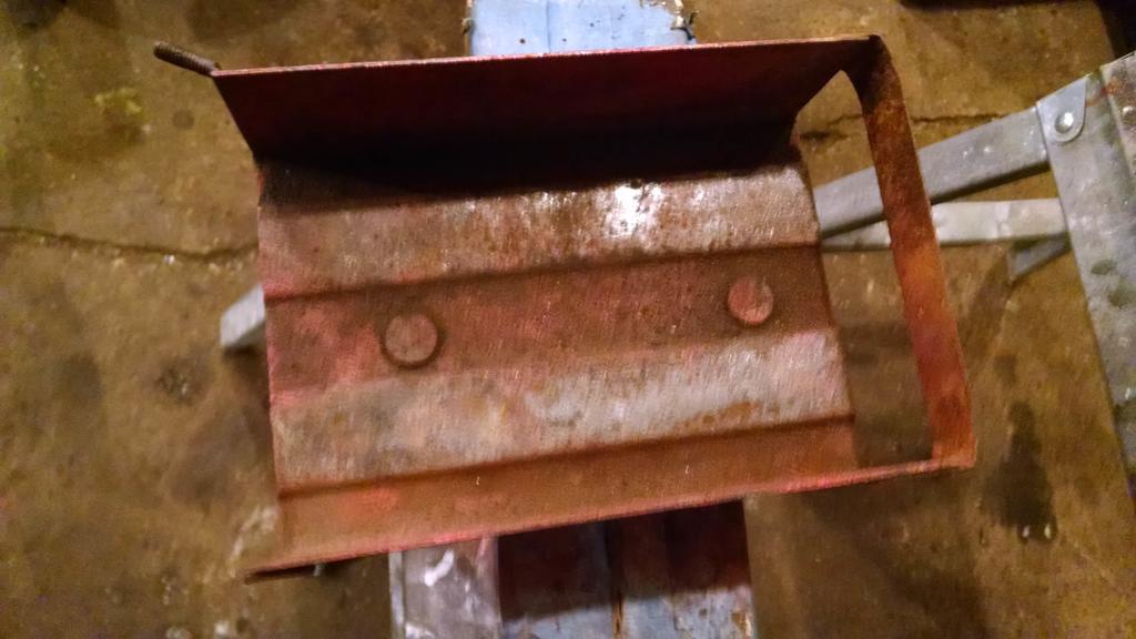

Achto 27,920 #18 Posted January 22, 2018 (edited) I spent some time cleaning up parts, cleaning grease off to make sand blasting go easier, and welding up unwanted holes & cracks. One said project was the battery box. The rear strap was worn pretty thin and there was one of the strap bolts missing. A 5/16" pilot drill bit works great for drilling out spot welds to separate parts. It allows you to only drill through the top piece of metal and not through the second piece. This is the method that I used to remove the old strap from the battery box. After I made the new strap I drilled holes through it at about the location of the old spot welds and did a blind weld through the hole to attach my new piece. For the bolts on the other end I heated some 1/4" stock and flattened about a 1/2" inch on one end. Then cut it to length, threaded it and welded it in place. As long as I was replacing one, I decided to replace them both. After sand blasting the front rims I was graced with this wonderful surprise. Now I have other rims and I could have just as easily chucked this one, but where's the fun in that. Instead I decided to see if I could fix it. Every time that I touched it with the welder, the holes got bigger until I finally found some good metal. I did what I call noodle welding for a while and then I was able to get some good beads going. I was finally able to get the holes closed up and then it was grinder time. It was pretty time consuming, but here's the end result. A couple coats of urethane primer should take out the last little imperfections. I also made a new belt brake for bottom of the guard, some thing that I should have done before disassembly I guess. Which leads me to a question. Does anyone know what the distance from the edge of the guard to the end of the bottom belt brake is? I want to make sure that I have it positioned correctly before I weld it. Now to sit down & watch some of @stevasaurus's video's before I tear the tranny down. Edited January 22, 2018 by Achto 3 5 Share this post Link to post Share on other sites

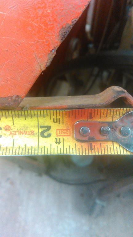

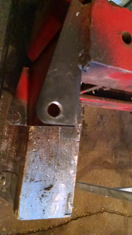

JPWH 6,147 #19 Posted January 22, 2018 Nice job on the repairs. I have found that using a copper backing makes welding the wheels much easier. I can give you the dimension on the break tab tomorrow afternoon. 1 2 1 Share this post Link to post Share on other sites
WHX?? 49,494 #20 Posted January 22, 2018 Same thing on my 1067 battery box Dan, back strap was partially gone by years ago batts but after some cleaning I liked the old school looked of old metal. I just took some 1/4-20's flattened them on the shank end and BRAZED them to the box with your angle hold in! Funny how those rims held air even with tubes.I woulda thought those would have been post cloride days no?? 3 Share this post Link to post Share on other sites
Achto 27,920 #21 Posted January 22, 2018 1 hour ago, WHX14 said: Funny how those rims held air even with tubes.I woulda thought those would have been post cloride days no?? I believe it should be post chloride days. Just years of neglect I guess. 2 Share this post Link to post Share on other sites
PeacemakerJack 10,742 #22 Posted January 22, 2018 Thanks Dan for the detailed explanation of what you did on both repairs—cool! You can mark it down that the battery box area of nearly every tractor more than 15 years old is going to show some damage and often much of the metal below it. Glad you were able to get yours repaired so nicely... 2 Share this post Link to post Share on other sites
JPWH 6,147 #23 Posted January 22, 2018 @Achto the measurement is 2 3/8". 1 4 Share this post Link to post Share on other sites
Achto 27,920 #24 Posted January 23, 2018 1 hour ago, JPWH said: @Achto the measurement is 2 3/8" Thank you for getting this measurement for me!! 1 Share this post Link to post Share on other sites
