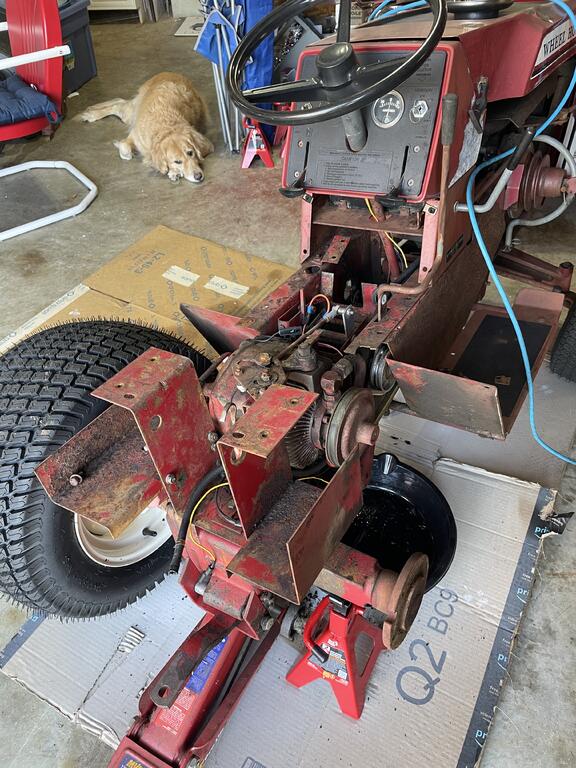

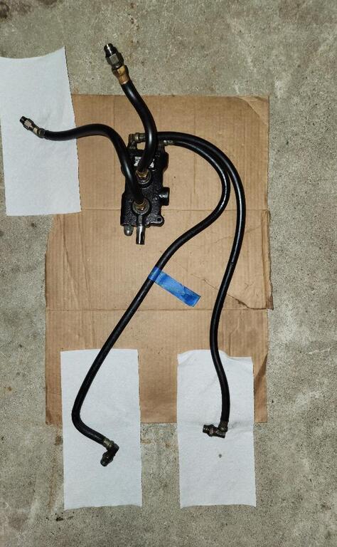

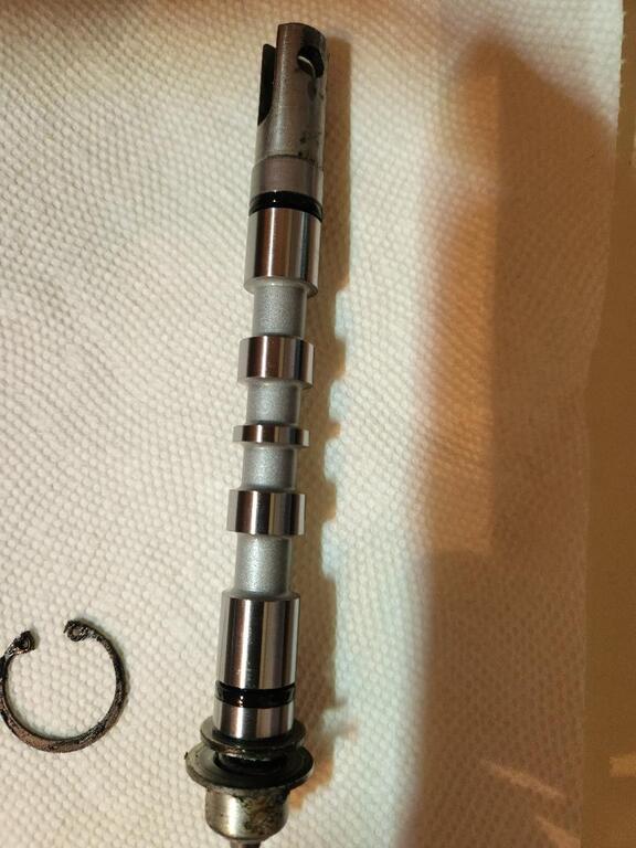

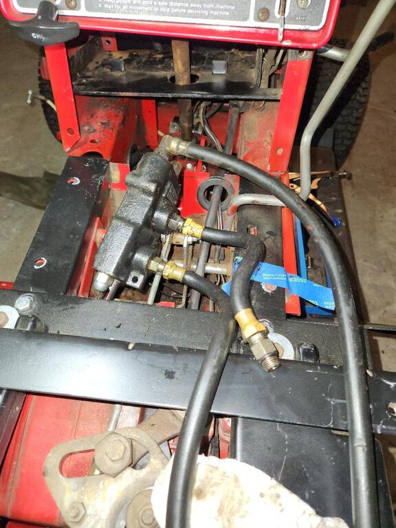

Brockport Bill 1,818 #22176 Posted October 23, 2024 4 minutes ago, Sodaking27 said: Finally after being sidelined for almost 2 months with ankle and Achilles tendinitis was able to spend a little time working on the C175. Removed all the hoses and lift valve. Rebuilt the lift valve. Discovered the rear finder mounting bracket where it normally breaks was in need of welding. Have a friend who has a welding service and he’s going to stop by one evening to take care of it. did the master hydraulic lift valve job on a c175H last year -- absolute nightmare getting that in and out of that location in hoodstand -- replaced the "O" rings and the 4 hoses -- i still have the wounds on my hands from trying to manipulate the unit into that space and remove and then install the bolts -- Unfortunately i have another c175 h that is leaking fluid from the master valve and have to do that job --UGH !!! 3 1 Share this post Link to post Share on other sites

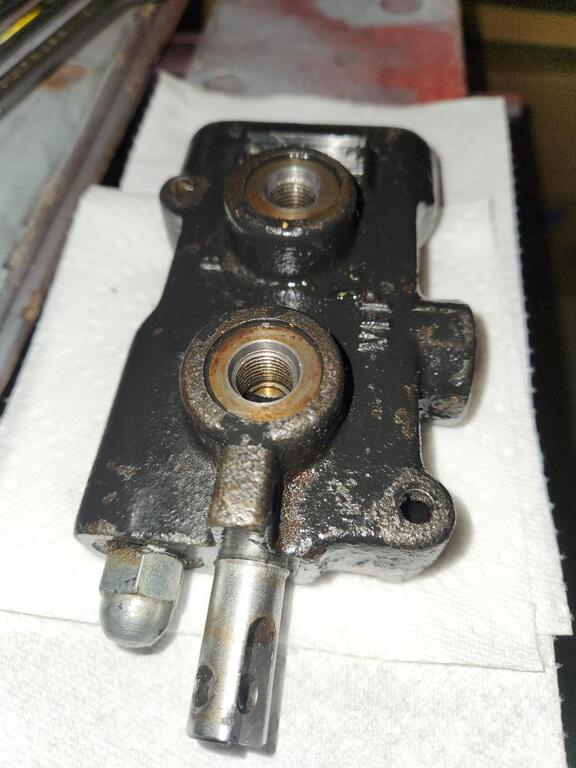

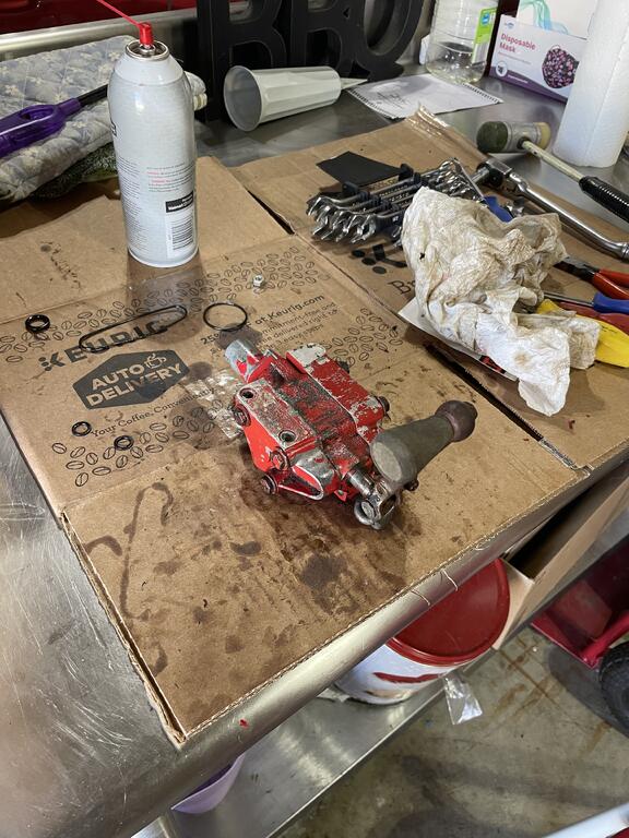

Sodaking27 876 #22177 Posted October 23, 2024 3 minutes ago, Brockport Bill said: did the master hydraulic lift valve job on a c175H last year -- absolute nightmare getting that in and out of that location in hoodstand -- replaced the "O" rings and the 4 hoses -- i still have the wounds on my hands from trying to manipulate the unit into that space and remove and then install the bolts -- Unfortunately i have another c175 h that is leaking fluid from the master valve and have to do that job --UGH !!! I hear you. The long oval seal was a pain to keep in place when putting back together. Hopefully no leaks when I get it all back together. 2 Share this post Link to post Share on other sites
Brockport Bill 1,818 #22178 Posted October 23, 2024 1 hour ago, Sodaking27 said: I hear you. The long oval seal was a pain to keep in place when putting back together. Hopefully no leaks when I get it all back together. actually i was never able to determine what or where was the leak??????? Was it "O" ring leaking at the piston valve -- or a connection of a hose?? so i just went the $130 to get 4 hoses and also do the O ring replacement -- thinking might as well make it right and not have to do job a second time. 4 Share this post Link to post Share on other sites

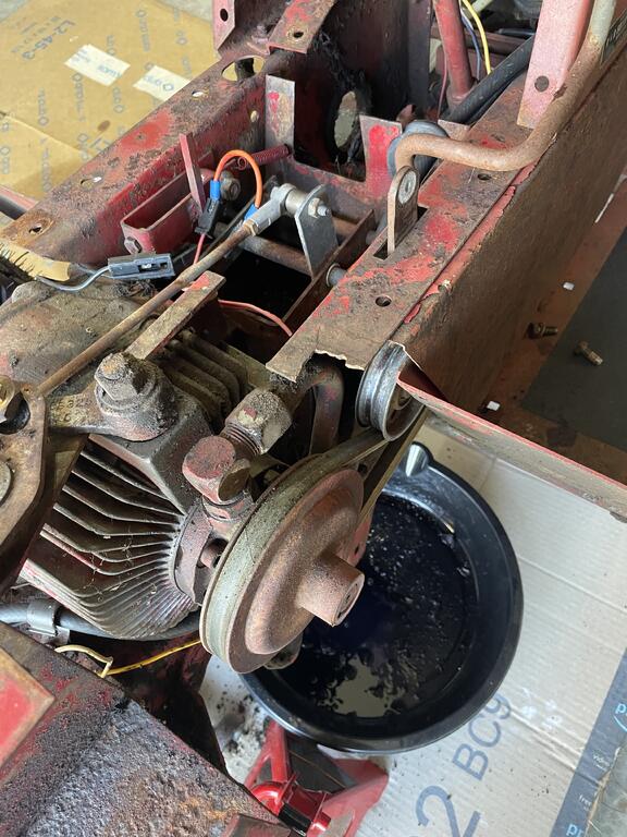

peter lena 9,057 #22180 Posted October 23, 2024 @Sodaking27 noting the belt drive idler pulley , original ? come with a very small bearing that , is known for failure / noise / rough , while you are there , might be worth an inspection and a re fit . since going after anything with a bearing , don't even think about not replacing or RE GEASING IT , is that a wanna be HEIM JOINT on that linkage ? use them regularly , anywhere , pete 2 Share this post Link to post Share on other sites

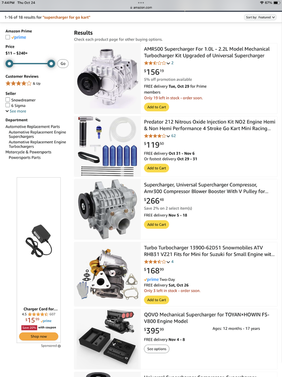

ebinmaine 70,330 #22191 Posted October 24, 2024 There's some engine swapping in the future around here. Cinnamon Horse C160-8 has a ticking I'm not fond of. Also another C160-8 for a future project. Possibly an 8 HP for the BBT. I stopped in to see my small engine repair guy for a minute. Told him what I was looking to do for my two 16 HP Kohlers. Basic mostly stock rebuild but if I can squeeze a couple or five extra HP out, why not? He said he can do everything but turn the crank and may have sources for that. Said he hasn't done one for a while but seemed like he would look forward to messing around with fully rebuildable old iron instead of the disposable garbage he normally does. No balance gears. Milling the head 40 or 50 thousandths. Overbore to be determined... 1 Share this post Link to post Share on other sites
MainelyWheelhorse 930 #22192 Posted October 24, 2024 (edited) @ebinmaine Hey..while your at it Amazon supercharger or eBay turbo one 😎 I haven’t seen that often. Edited October 25, 2024 by MainelyWheelhorse 2 Share this post Link to post Share on other sites
ebinmaine 70,330 #22193 Posted October 24, 2024 A supercharger ehh......? 2 Share this post Link to post Share on other sites
MainelyWheelhorse 930 #22194 Posted October 24, 2024 (edited) It sounds like I’m convincing you…😁 Edited October 24, 2024 by MainelyWheelhorse 1 Share this post Link to post Share on other sites
ebinmaine 70,330 #22195 Posted October 25, 2024 33 minutes ago, MainelyWheelhorse said: It sounds like I’m convincing you…😁 If I was building a "show only" tractor I'd absolutely install a S/C just because..... 1 1 Share this post Link to post Share on other sites

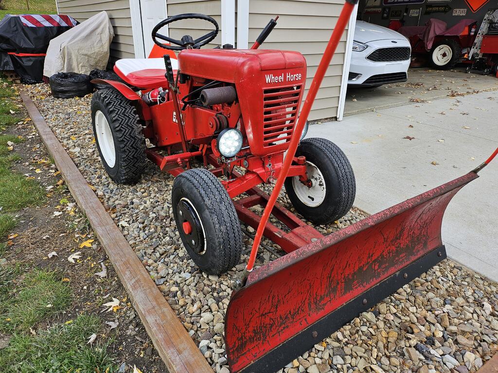

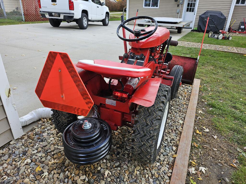

ML3 1,431 #22200 Posted October 26, 2024 (edited) Although it might be early.....got the 654 ready for snow plowing duty. Now that leaves are falling the rear discharge deck doesn't work good for leaf pick up so I'm using my 33" Troy Bilt walk behind mower. Changed oil, greased all fittings, removed mower deck & installed plow, installed weights, & upgraded to led lights. Edited October 26, 2024 by ML3 1 7 Share this post Link to post Share on other sites
