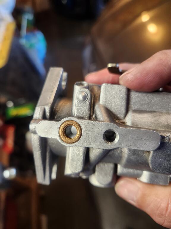

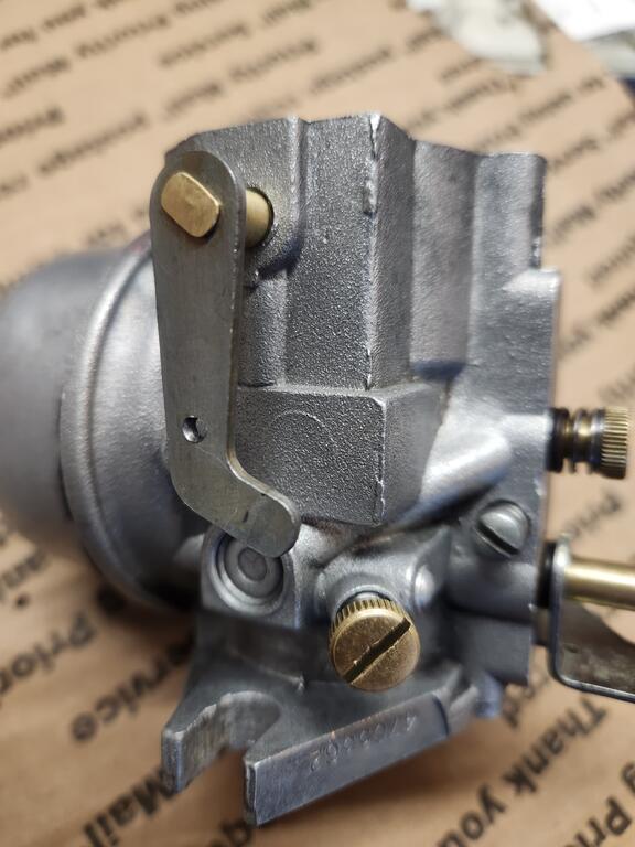

Goldnboy 978 #22001 Posted September 8, 2024 After soaking in Berryman's for a week I did a thorough cleansing and added brass throttle bushings...along with a OEM carb kit... Reinstalled and no more running on choke only@ 8 5 Share this post Link to post Share on other sites

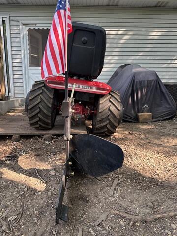

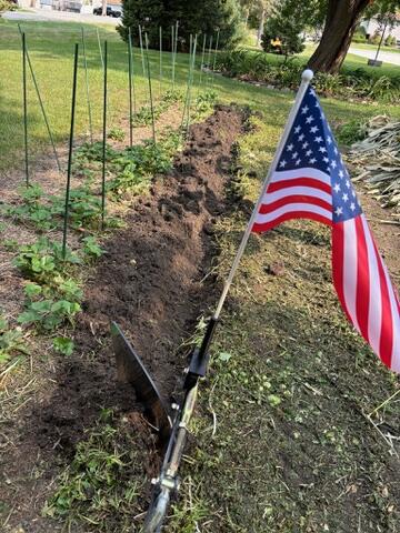

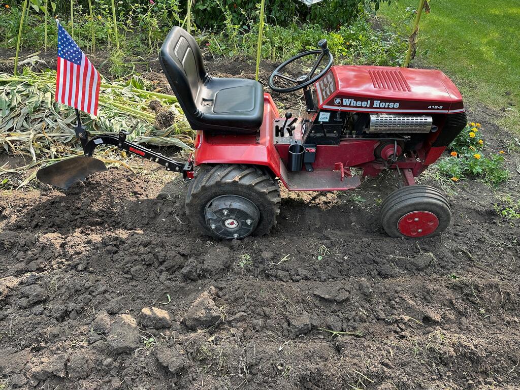

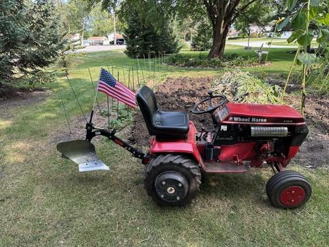

Andy N. 2,241 #22002 Posted September 8, 2024 Got the 418-8 and Brinly plow set up and plowed the garlic patch. 4 11 Share this post Link to post Share on other sites

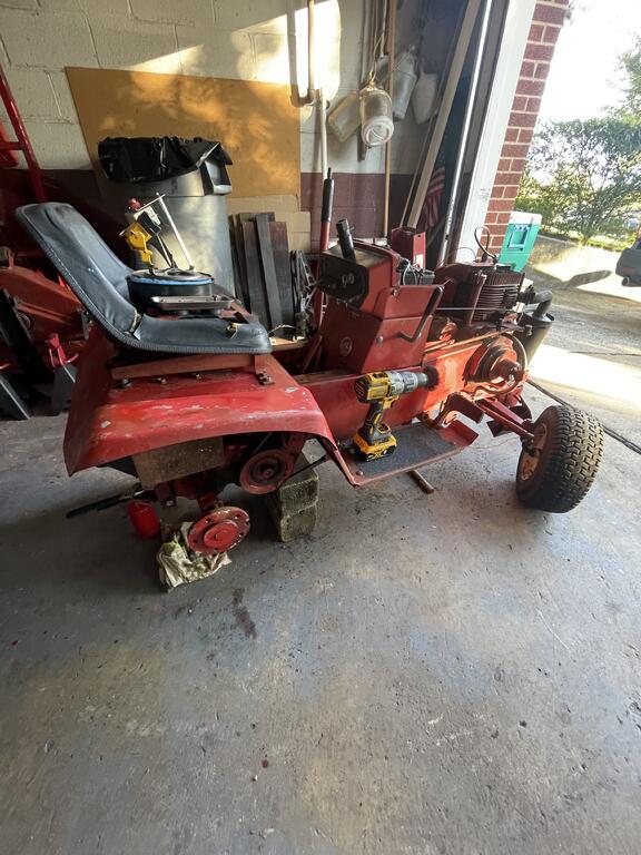

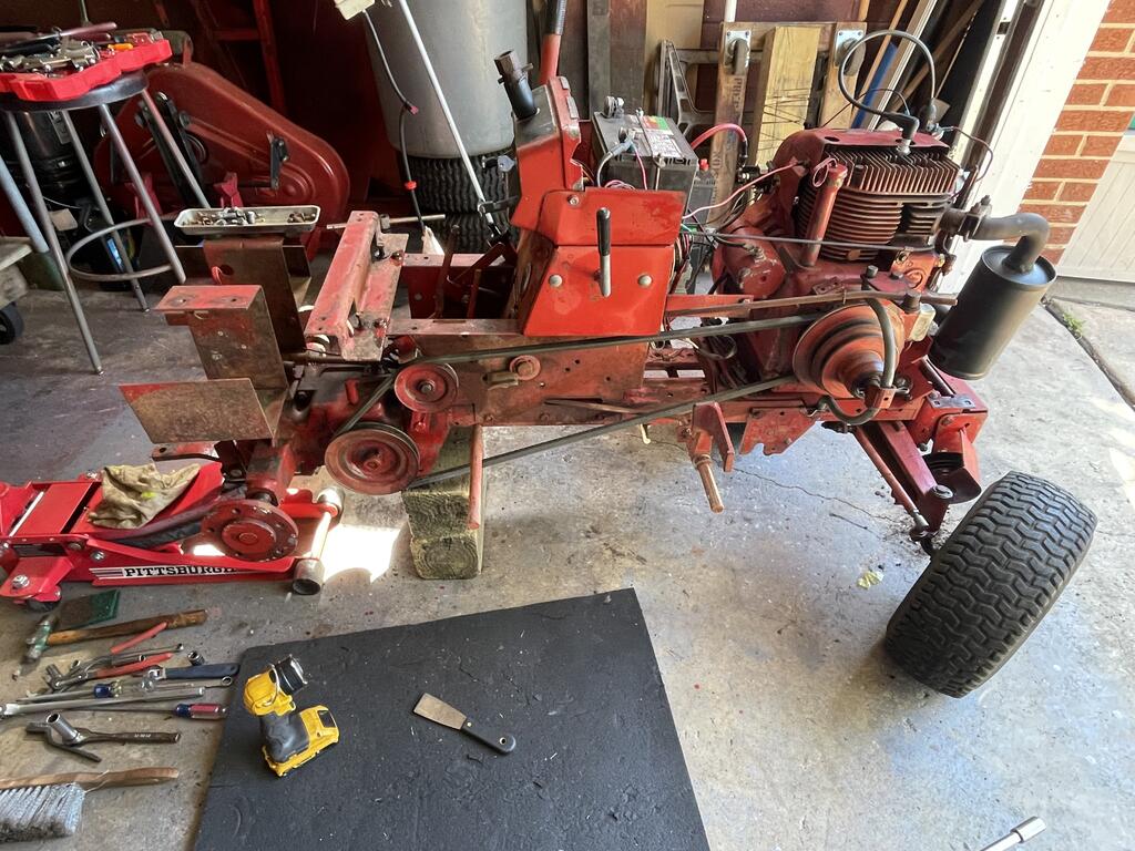

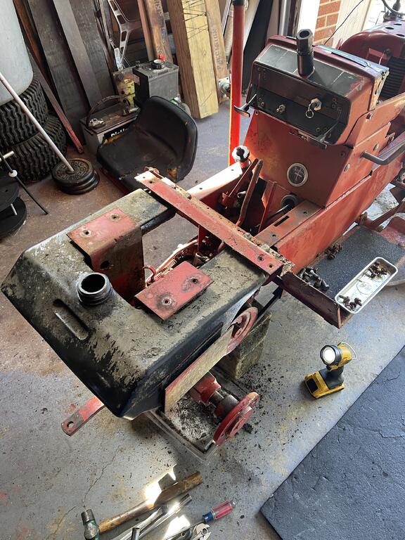

Wheelhorse#1 1,758 #22003 Posted September 9, 2024 This morning I finished removing a few more tins and gas tank to clean and replace bushing. Wile I’m on it I mind as well take care of the axle seals,remove the hubs.I don’t really have a good tool for that yet. Removing hubs is probably my least favorite job,I have a extra one in case I break one. The left side I think maybe was exposed to weather more as the tire was a real pia just to remove the lugs. All in all though this tractor is in pretty good shape for sitting in a corn field for many yrs. Hope I’m not boring 🥱 too many with these post a couple pix 5 3 Share this post Link to post Share on other sites

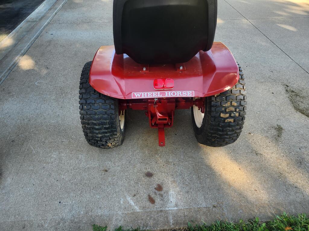

Goldnboy 978 #22004 Posted September 10, 2024 (edited) Frozen slot hitch ...now after weeks of being shot with WD 40, Liquid wrench, and PB blaster( all now empty) I drilled two holes into the slot hitch and sprayed with more PB blaster it broke free!.. I have taped the holes and added grease zerks and a new lift cable and I can use the hitch! The pin doesn't move sideways...but doesn't matter size the slot hitch moves and will not be using a tiller anytime soon. Edited September 10, 2024 by Goldnboy 3 7 Share this post Link to post Share on other sites

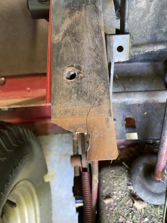

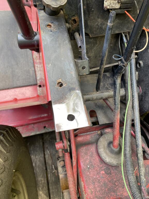

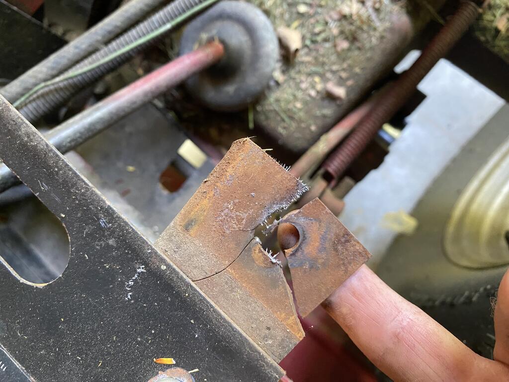

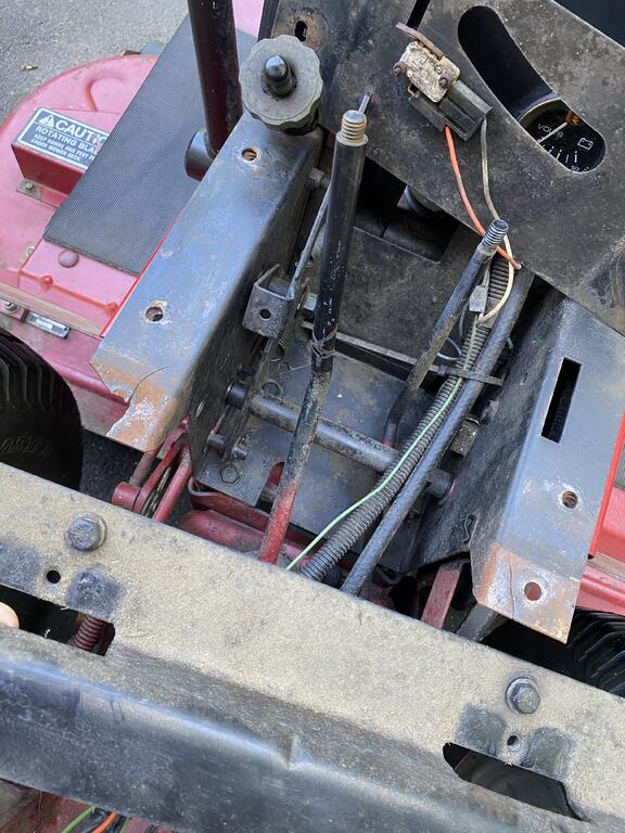

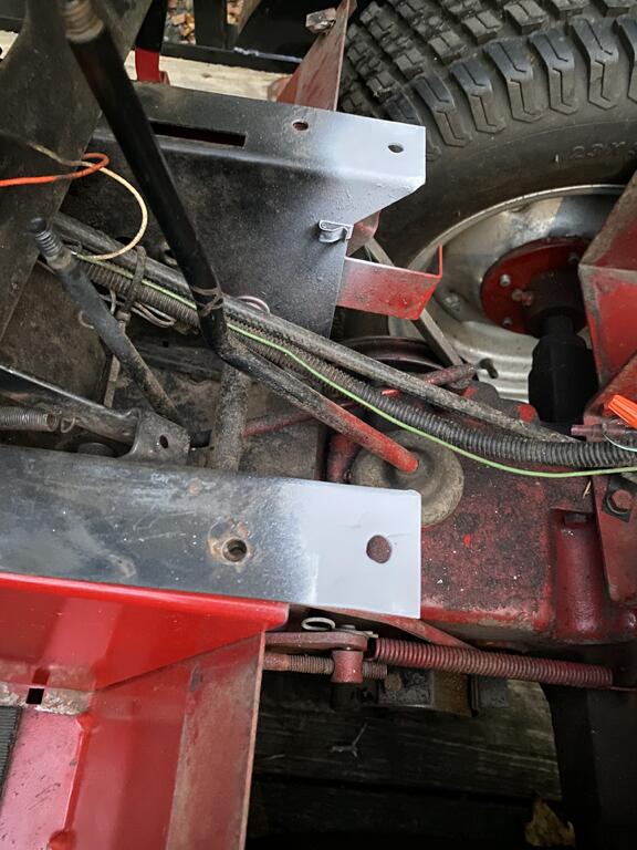

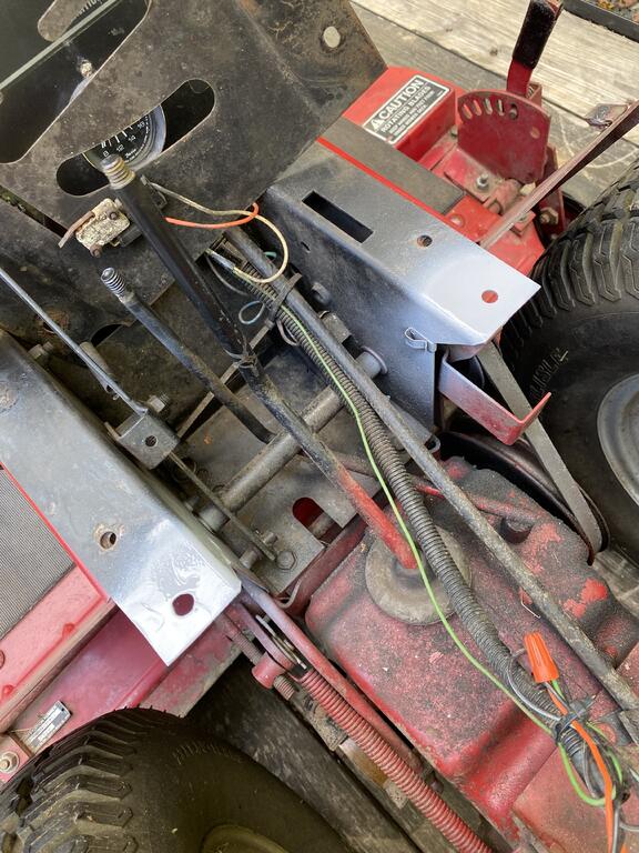

Sparky-(Admin) 21,902 #22013 Posted September 15, 2024 Friend of mine has welding skills (I have none), he welded up the support rails on my 414, which is my favorite mowing rig with the 42RD. Shot em with primer yesterday, will get a single coat of black today and then reassemble. Thanks @Scot 1966 12 Share this post Link to post Share on other sites

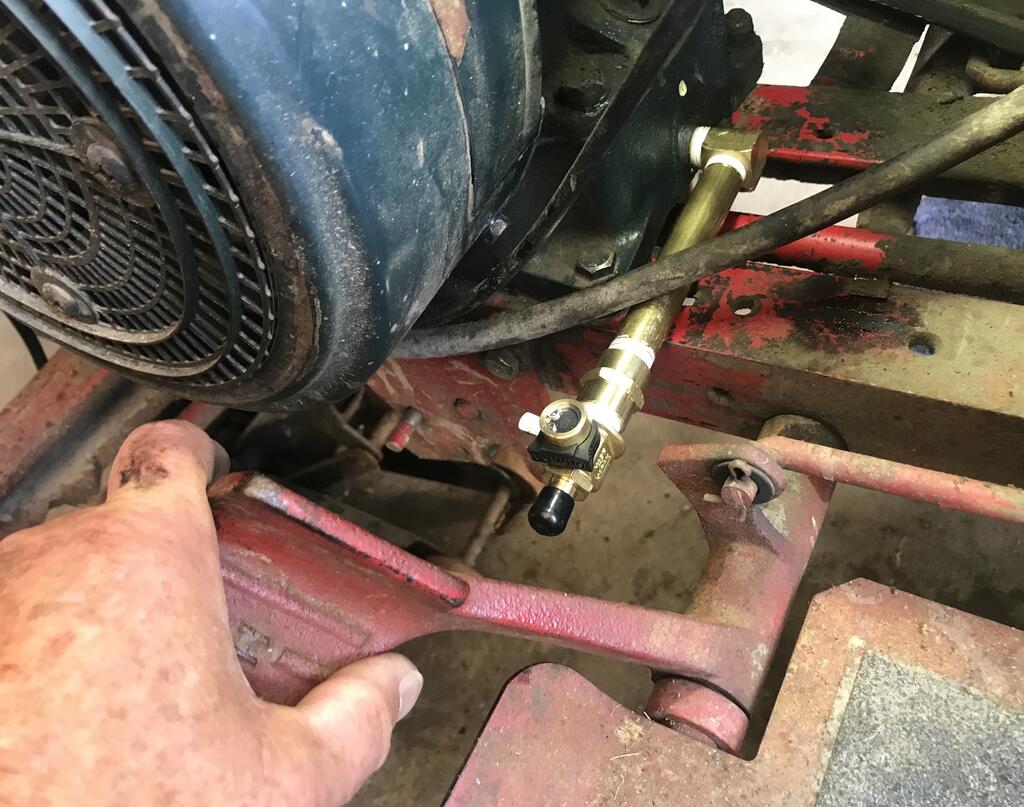

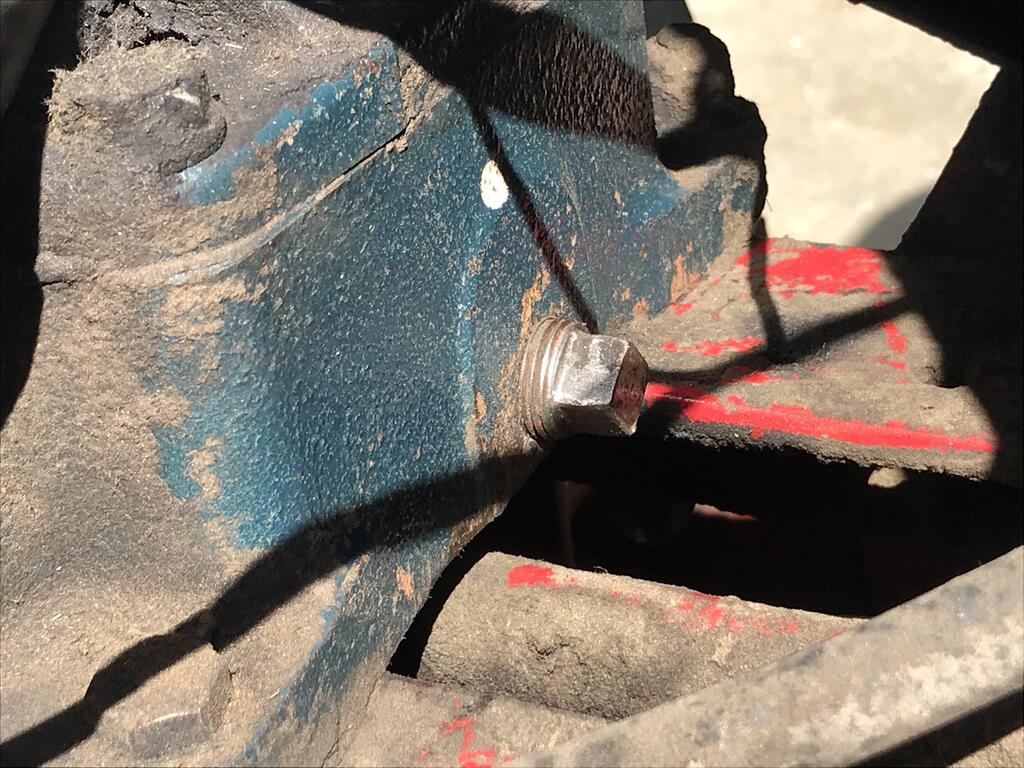

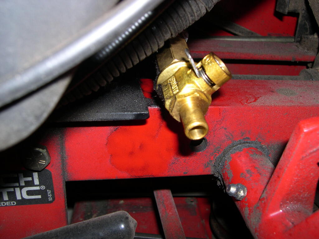

rustyedge1 170 #22014 Posted September 15, 2024 Finally !!! After 10 years of gona get around to it, I got around to it. Don't have to drop the deck anymore to change oil in the old steady user. Went all brass with a Fumoto valve and 5" nipple ( 6" put me out too far ) street elbow screwed in without any issues. Don't know why I waited so long as I use this tractor weekly. 9 Share this post Link to post Share on other sites
Racinbob 11,667 #22015 Posted September 15, 2024 I love the oil drain valves and have been using them for years on everything. I tend to keep them a bit shorter so they don't hang over the frame as far. Only found one vehicle where they would be a bad idea. The drain on my wifes car is centered on the bottom of the drain pan. Clearance is already iffy and I don't want to lose more. 1 9 Share this post Link to post Share on other sites
ebinmaine 70,359 #22016 Posted September 15, 2024 47 minutes ago, Sparky said: Excellent work! I hope you didn't hold your finger there the whole time. Bet that got hot 🔥 🥵 4 Share this post Link to post Share on other sites
MainelyWheelhorse 950 #22017 Posted September 15, 2024 5 hours ago, Sparky said: Friend of mine has welding skills (I have none), he welded up the support rails on my 414, which is my favorite mowing rig with the 42RD. Shot em with primer yesterday, will get a single coat of black today and then reassemble. Thanks @Scot 1966 @Sparky I had that frame issue with my 312-8 as well. I fixed it the same way too. However, in my case I’m thinking that the stress of the second PO being 300+ pounds cracked the frame in that same spot. 3 1 Share this post Link to post Share on other sites

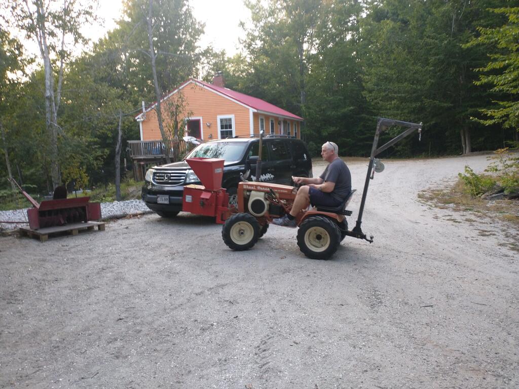

ebinmaine 70,359 #22018 Posted September 15, 2024 I started a crane build several years ago. Got back to it. 1 1 Share this post Link to post Share on other sites
ebinmaine 70,359 #22019 Posted September 15, 2024 The BBT and her Momma spent several hours working on firewood. This is her 867 Pigpen and the 1977 Ohio Steel trailer. My crane... 6 5 Share this post Link to post Share on other sites
mrc 870 #22020 Posted September 16, 2024 hi sparky, that seat support ALWAYS cracks/breaks. not a question of if, just when. repair looks great! regards mike 2 Share this post Link to post Share on other sites

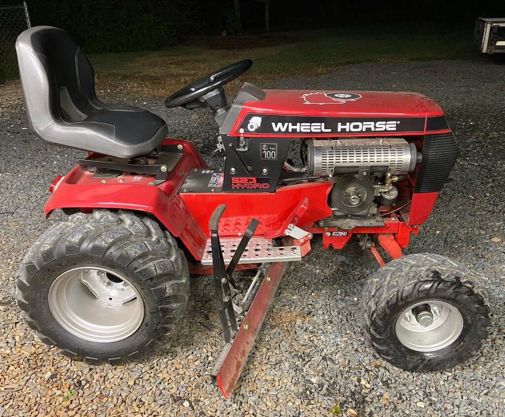

kpinnc 13,492 #22021 Posted September 18, 2024 Gave the 523-H her first oil change today. No glitter in the old oil (5 hours since build), so that was a relief. I was concerned about how dark it was, but then remembered that the assembly lube I used was black. She is dirty already, but ready to work again! 1 12 Share this post Link to post Share on other sites

midpack 959 #22023 Posted September 21, 2024 On 9/15/2024 at 7:47 PM, ebinmaine said: My crane... I have one of those for my truck reciever, it has a lower "foot" that sits on the ground for lifting up to 400 #'s (deer carcass) And it pivots to load in the bed. I never thought of using it on a tractor, can I see your hitch setup? 2 Share this post Link to post Share on other sites
ebinmaine 70,359 #22024 Posted September 21, 2024 1 hour ago, midpack said: I have one of those for my truck reciever, it has a lower "foot" that sits on the ground for lifting up to 400 #'s (deer carcass) And it pivots to load in the bed. I never thought of using it on a tractor, can I see your hitch setup? I'll be adding a scissor jack to the crane mount. I'll get some pics of the hitch later. It's a decent setup for a trailer but I won't be leaving it for permanent use with this crane. Because Cinnamon Horse has tall front tires for the chipper it obviously puts a backward tilt on the crane. I'm going to build a hitch that has the proper vertical orientation and reinforcement to the bottom AND top of a transmission. 1 Share this post Link to post Share on other sites

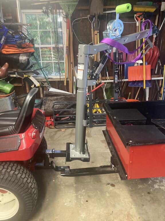

SylvanLakeWH 27,214 #22025 Posted September 21, 2024 @midpack here's my setup. Harbor freight crain and a 2" receiver winch plate mount. Have one of Lowell's 2" hitches on back. Bombproof. 2 6 Share this post Link to post Share on other sites
