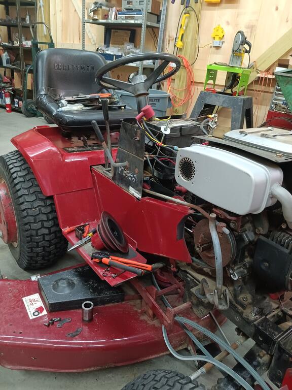

wallfish 16,817 #21676 Posted July 6 59 minutes ago, squonk said: @wallfish Took the guides off and tried to fit the belt guard. It seems the front pulley is too big. I got it from K & B and it was marked an RJ engine pulley. Might explain why I had to use a 31" belt to fit. Could be. Should be a 2.5 inch OD pulley with the set screw in the groove. Brian said he is making more. They do ride tight in there but should leave about 1/8" of space for the belt to release from the pulley groove. Yes, the belt guide fingers would need to be removed to install it and the guard will then guide the belt instead. That belt appears to be riding a little high in the groove but maybe not. Does it seem to go a little faster that it should be? 3 Share this post Link to post Share on other sites

squonk 40,823 #21679 Posted July 6 6 minutes ago, wallfish said: Could be. Should be a 2.5 inch OD pulley with the set screw in the groove. Brian said he is making more. They do ride tight in there but should leave about 1/8" of space for the belt to release from the pulley groove. Yes, the belt guide fingers would need to be removed to install it and the guard will then guide the belt instead. That belt appears to be riding a little high in the groove but maybe not. Does it seem to go a little faster that it should be? I'll have to measure the pulley but the guard doesn't fit over all of the pulleys. Doesn't seem faster than it should be. Share this post Link to post Share on other sites

wallfish 16,817 #21683 Posted July 6 Just now, squonk said: I'll have to measure the pulley but the guard doesn't fit over all of the pulleys. Doesn't seem faster than it should be. There might be bigger holes drilled into the frame which allows the motor to "slide" more. And yes, some of those little nut roasters can be a pain to get the guard on and work correctly Share this post Link to post Share on other sites

squonk 40,823 #21686 Posted July 6 Just now, wallfish said: There might be bigger holes drilled into the frame which allows the motor to "slide" more. And yes, some of those little nut roasters can be a pain to get the guard on and work correctly Engine is back and close to the trans as it can go. It's not a WH spec. Engine so maybe that's got something to do with it. Exhaust port was only 1/2 " and I had to lower the entire exhaust from it's normal height. Had to drill new holes for the pipe hanger. Share this post Link to post Share on other sites

wallfish 16,817 #21688 Posted July 6 4 minutes ago, squonk said: Engine is back and close to the trans as it can go. It's not a WH spec. Engine so maybe that's got something to do with it. Exhaust port was only 1/2 " and I had to lower the entire exhaust from it's normal height. Had to drill new holes for the pipe hanger. I don't remember if they put a plate under the H55 Teccys to raise the shaft for those tractors or not, but don't think so. Maybe Cas @formariz could shed some light about changing from a H55 to K91 and fitting the guard. Share this post Link to post Share on other sites
