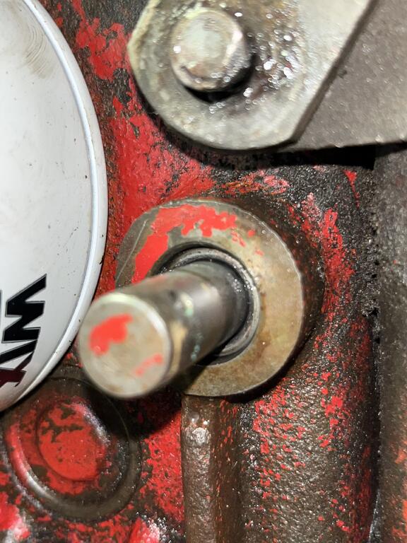

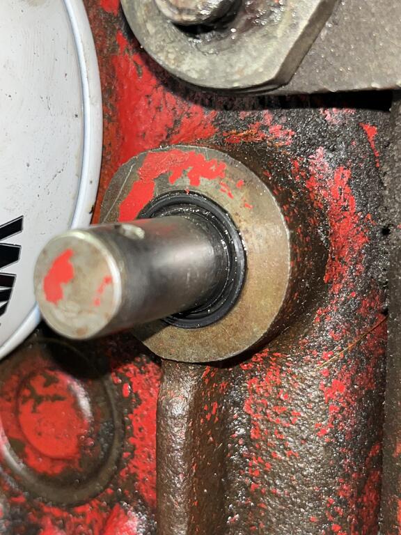

BrianKoch 336 #20901 Posted February 26, 2024 (edited) 23 hours ago, Ed Kennell said: Push the shaft L-R-UP- DN. There should be no movement. No movement to report. That’s good! I don’t know. Maybe I installed the seal inside out, but take a look and let me know what you think… Edited February 26, 2024 by BrianKoch Share this post Link to post Share on other sites
BrianKoch 336 #20902 Posted February 26, 2024 (edited) 9 minutes ago, BrianKoch said: No movement to report. That’s good! I don’t know. Maybe I installed the seal inside out, but take a look and let me know what you think… Ok I may have just figured it out. I flipped the seal and drove it in with a 1/2” copper pipe scrap (straight cut and de-burred) and felt it “seat”. Going to monitor for leakage. Edited February 26, 2024 by BrianKoch 5 Share this post Link to post Share on other sites

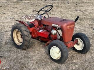

Streetrodchev 845 #20903 Posted February 27, 2024 Changed the throttle cable on the 550 today, then out for a ride. 5 1 Share this post Link to post Share on other sites
Tractorhead 9,087 #20904 Posted February 27, 2024 5 hours ago, BrianKoch said: Ok I may have just figured it out. I flipped the seal and drove it in with a 1/2” copper pipe scrap (straight cut and de-burred) and felt it “seat”. Right decision, it was wrong inserted in the first pic. If you flip it, now it be correct. 1 Share this post Link to post Share on other sites

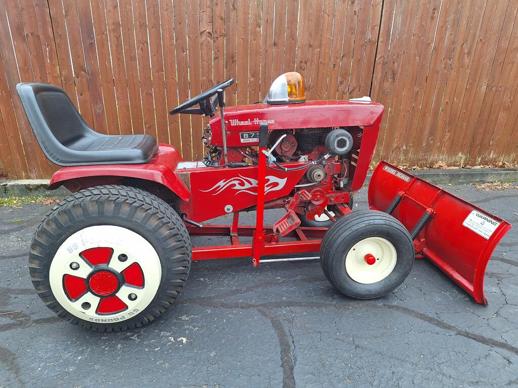

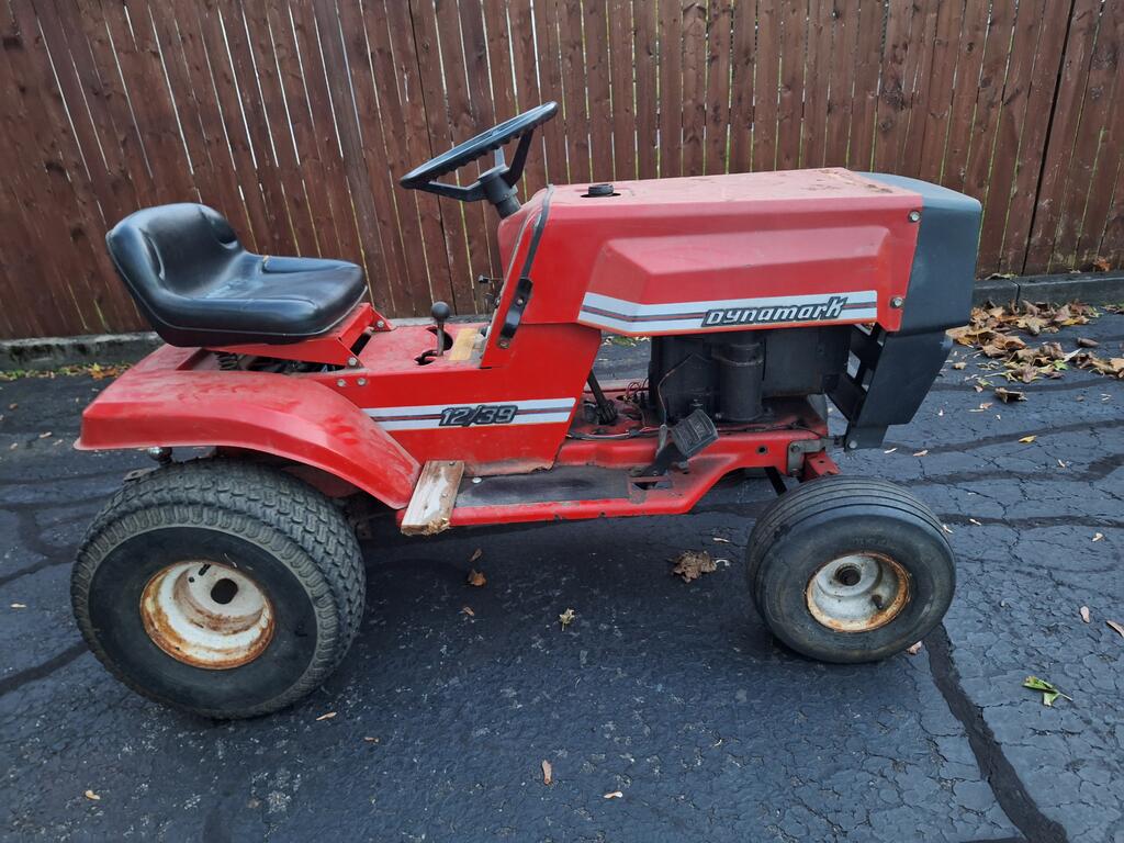

D_Mac 9,086 #20905 Posted February 27, 2024 So in the fall I was given a dynamark riding mower for free. Who can turn down free? It had on the back wheels these wheel weights . I removed them and they been sitting in my garage all winter. So I'm out in the garage today tinkering with my 875 plow tractor when it occurred to me.... put those weights on the front tires !!!!! So I did. Guess I will see if it makes a difference NEXT winter. Gives me time to paint them to match the rears. 9 1 Share this post Link to post Share on other sites

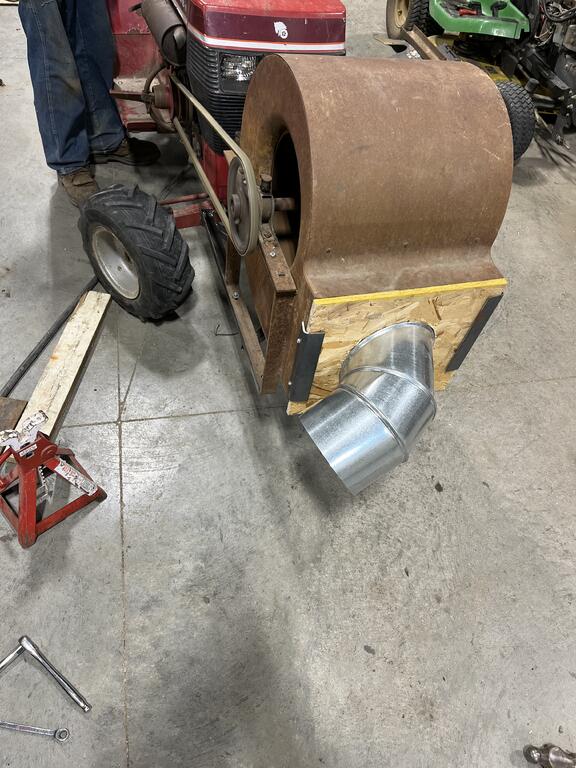

87 416-8 horse 423 #20907 Posted February 29, 2024 (edited) I just finished building a leaf blower for the front of my horse. It moves an insane amount of air! I built a custom frame out of scrap metal to hold it on. You can feel a breeze at 55 feet away. Edited February 29, 2024 by 87 416-8 horse 1 10 Share this post Link to post Share on other sites
Tractorhead 9,087 #20908 Posted February 29, 2024 1 hour ago, 87 416-8 horse said: What was the origin source for that blower? Looks interesting. 2 Share this post Link to post Share on other sites
D_Mac 9,086 #20909 Posted February 29, 2024 Hope you give it a few coats of Regal Red. Nice job. 2 1 Share this post Link to post Share on other sites
lynnmor 7,551 #20910 Posted February 29, 2024 8 hours ago, Tractorhead said: What was the origin source for that blower? Looks interesting. I'll jump in and say that older warm air furnaces used belt drive blowers, you might want to contact some heating contractors for used parts. 1 1 Share this post Link to post Share on other sites
87 416-8 horse 423 #20911 Posted February 29, 2024 10 hours ago, Tractorhead said: What was the origin source for that blower? Looks interesting. I believe it’s out of an old boiler. I put a little smaller pulley on it so it would spin faster. 1 Share this post Link to post Share on other sites
Ed Kennell 40,373 #20912 Posted February 29, 2024 10 hours ago, Tractorhead said: What was the origin source for that blower? Looks interesting. Mine was from a forced hot air heating system. It was a $10 auction buy. The pulley was with it so I only needed to add the adjustable elbow and the belt tensioner pulley. 2 5 1 Share this post Link to post Share on other sites
87 416-8 horse 423 #20913 Posted February 29, 2024 Welp, I got some bad news. I was testing the leaf blower and it blew up. I don’t think it could handle the rpm.💥 1 7 Share this post Link to post Share on other sites
Ed Kennell 40,373 #20914 Posted February 29, 2024 36 minutes ago, 87 416-8 horse said: I was testing the leaf blower and it blew up. I don’t think it could handle the rpm. Yeah, in the heating systems with an 1800 RPM motor with a small pulley and the large pulley on the blower, they run really slow. 2 Share this post Link to post Share on other sites
87 416-8 horse 423 #20915 Posted February 29, 2024 1 minute ago, Ed Kennell said: Yeah, in the heating systems with an 1800 RPM motor with a small pulley and the large pulley on the blower, they run really slow. Yep. I think Im going to pull it apart and a some littel bits of metal to help hold the fins in place. 1 Share this post Link to post Share on other sites
Ed Kennell 40,373 #20916 Posted February 29, 2024 7 minutes ago, 87 416-8 horse said: Yep. I think Im going to pull it apart and a some littel bits of metal to help hold the fins in place. Make sure you keep the rotor balanced, and I would put the large pulley back on and keep the tractor RPM around 1000. 3 1 Share this post Link to post Share on other sites
Tractorhead 9,087 #20917 Posted February 29, 2024 1 hour ago, 87 416-8 horse said: Yep. I think Im going to pull it apart and a some littel bits of metal to help hold the fins in place. In my thinkering i be in first absolutely with Ed‘s. Without any modification firstly reducing dramatically the rpm‘s On the other hand after i looked little closer to the second pic, i see that everywhere where the finns be used as drive in the middle section they be definitely not harmed at all. Therefore i can imagine if the whole fan in the Middlesection becomes an complete outside mounted enstiffening Ring i. Eg. made from a 0,7mm thick 2cm wide little flat that goes outside the fan around the drum Fixed with a small welding spot or with a oneway rivet on two sites together to balance it, it may can improve the rpm‘s. because if the fins than in width be shorter they become more stiffness itself. Question is how much rpm they than can handle with that improvement and if it‘s a win or a fail at all. a gently and slow rev up will show how much rpm it can dealing with. 1 Share this post Link to post Share on other sites
Ed Kennell 40,373 #20918 Posted February 29, 2024 Just another thought, You can run the blower very slow and increase the air velocity by decreasing the discharge area. Something like this could be modified to create a wide high velocity sweeper. 4 1 Share this post Link to post Share on other sites
Tractorhead 9,087 #20919 Posted February 29, 2024 1 hour ago, Ed Kennell said: Just another thought, You can run the blower very slow and increase the air velocity by decreasing the discharge area. Something like this could be modified to create a wide high velocity sweeper. Hi Ed, I be not shure on this Dimension of Blowers what works better, reduce the charge or reducing the discharge Area of the Blower Therefore i have not enough own experiences to be 100% shure in that Dimensions. I just know, on my Shed Heater what work in combination with an Attached 1800cubicmeter Blower, that sucks the Hot air from my Heater and blow it thru a long Pipe to a Place where i need it. It runs fine up to 600 rpm - about 1/4 of max throttle. if i rev it too high, it sucks so strong, that the Pipe between heater and blower begin to collapse because of the suction. but i never try to reduce the outlet. I feared that the pressure increases much and do some other dubious unwanted things internally like whirls or something like that. maybe i‘m wrong in my thinking. Dunno. So i would go primary - as you mentioned earlier - with the bigger Pulley on the Blower for a transmission reducing for the RPM‘s on the Blower, So he can play with the Throttle and see what happens or when it‘s enough „Boost“ Pressure This equation can be calculated much simpler for needed speed. I think you mean a Nozzle at the end to increase speed, do you? 2 Share this post Link to post Share on other sites

953 nut 57,706 #20921 Posted March 1, 2024 18 hours ago, 87 416-8 horse said: Yep. I think Im going to pull it apart and a some littel bits of metal to help hold the fins in place. The likelihood of being able to patch it up and have the fan be balanced well enough to use it is slim to none. Get another fan and keep the rpms reasonable. 9 Share this post Link to post Share on other sites
sjoemie himself 3,072 #20922 Posted March 3, 2024 On 2/29/2024 at 4:00 AM, 87 416-8 horse said: Very good idea and a shame it blew up. As others have said before me I would'nt bother trying to repair this unit. It failed for a reason. Chances are that the spot you repair will hold but then another section will give up. Looking at your exhaust nozzle I can imagine the pressure generated by the fan with the increased rpm's can't exit fast enough causing the fan to buckle under the increased stress. For a second attempt you could try to make the nozzle: - A, bigger or - B, transition smoother to the small diameter. This creates less pressure inside the blower but increases flow and speed at the tip of the exhaust nozzle, where you want it. No blower expert here though just thinking out loud and adding my 1 1 Share this post Link to post Share on other sites
87 416-8 horse 423 #20923 Posted March 3, 2024 1 hour ago, sjoemie himself said: Very good idea and a shame it blew up. As others have said before me I would'nt bother trying to repair this unit. It failed for a reason. Chances are that the spot you repair will hold but then another section will give up. Looking at your exhaust nozzle I can imagine the pressure generated by the fan with the increased rpm's can't exit fast enough causing the fan to buckle under the increased stress. For a second attempt you could try to make the nozzle: - A, bigger or - B, transition smoother to the small diameter. This creates less pressure inside the blower but increases flow and speed at the tip of the exhaust nozzle, where you want it. No blower expert here though just thinking out loud and adding my Yeah, I did some looking at it and tried to straighten it out but it’s way out of wack. I have a friend that works in hvac and sometimes has 1-2 a day. Hopefully I can buy one pretty cheap. Thanks everyone for your advice and input! 1 Share this post Link to post Share on other sites

squonk 42,433 #20925 Posted March 3, 2024 On 2/29/2024 at 5:53 PM, Tractorhead said: Hi Ed, I be not shure on this Dimension of Blowers what works better, reduce the charge or reducing the discharge Area of the Blower Therefore i have not enough own experiences to be 100% shure in that Dimensions. I just know, on my Shed Heater what work in combination with an Attached 1800cubicmeter Blower, that sucks the Hot air from my Heater and blow it thru a long Pipe to a Place where i need it. It runs fine up to 600 rpm - about 1/4 of max throttle. if i rev it too high, it sucks so strong, that the Pipe between heater and blower begin to collapse because of the suction. but i never try to reduce the outlet. I feared that the pressure increases much and do some other dubious unwanted things internally like whirls or something like that. maybe i‘m wrong in my thinking. Dunno. So i would go primary - as you mentioned earlier - with the bigger Pulley on the Blower for a transmission reducing for the RPM‘s on the Blower, So he can play with the Throttle and see what happens or when it‘s enough „Boost“ Pressure This equation can be calculated much simpler for needed speed. I think you mean a Nozzle at the end to increase speed, do you? Those fans are designed to move at a certain speed and move a certain amount of CFM. There is some leeway. But an old crusty fan is compromised. Using an electric motor, if you hop up the pulleys the motor overload will usually kick off before the fan will explode. Using a 14 HP gas engine will certainly overload the fan and cause it to explode. Restricting air in or out will have the same effect. If the fan outlet is restricted, the fan can't push the air out fast enough and the incoming air will increase static pressure to the breaking point. If the inlet is restricted, the suction created will pull the blades right out of the wheel. I saw this happen on a new air handler at a school during covid. The facilities staff decided to put highly restrictive air filters in to "Clean the Air" Blades came out and went through the evaporator coil. Of course they wanted it covered under warranty! NOT! 2 2 Share this post Link to post Share on other sites
