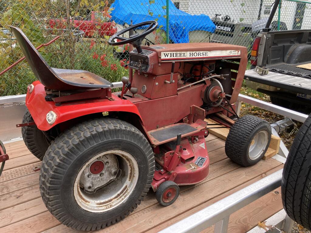

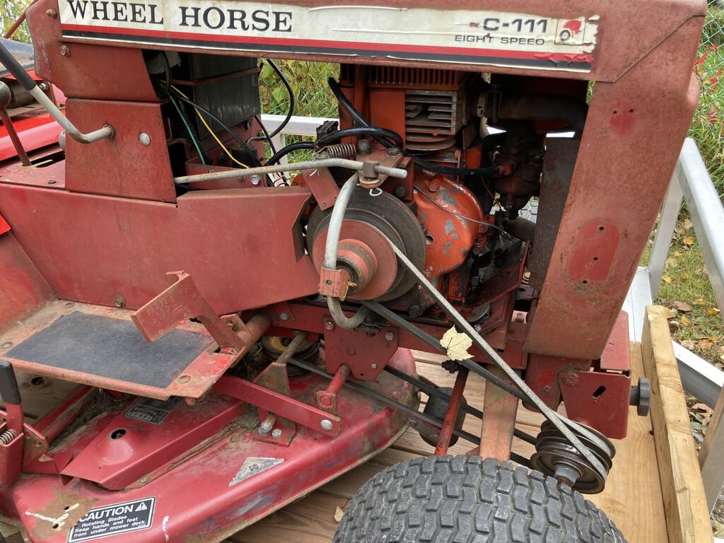

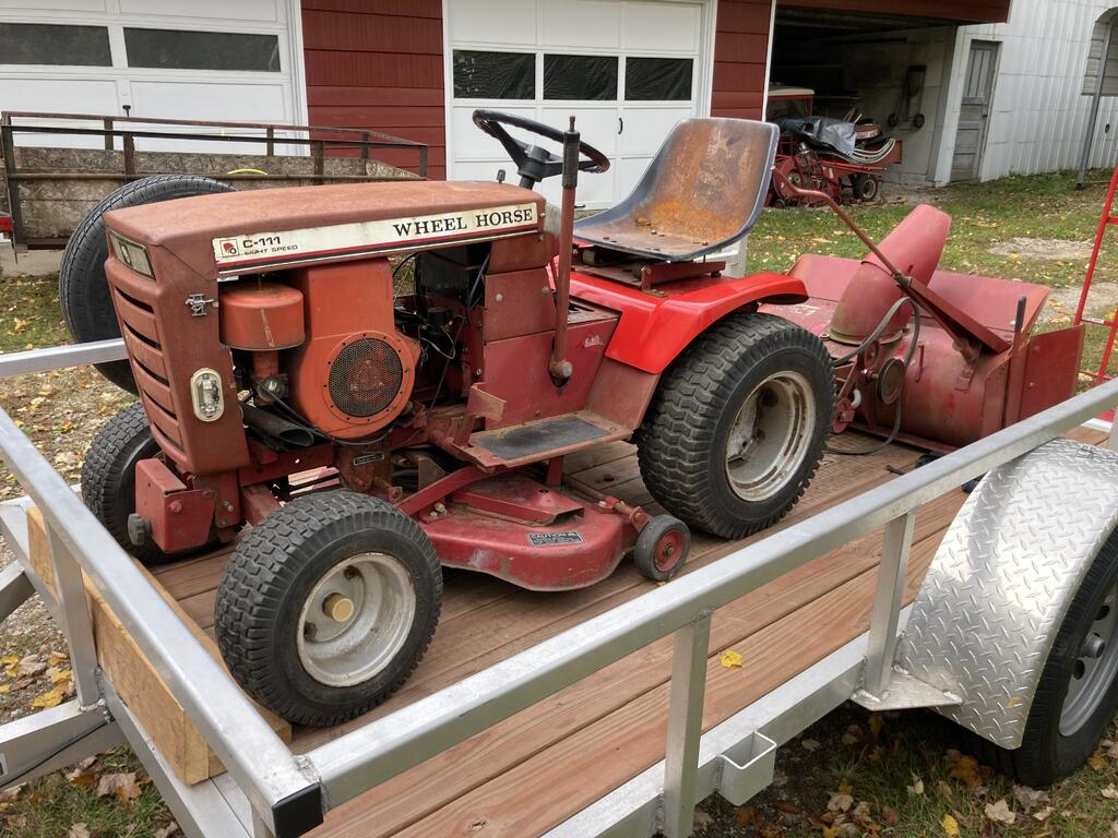

PWL216 916 #20776 Posted February 3, 2024 11HP Briggs n Stratton. Made just 1 year - 1979. Share this post Link to post Share on other sites
Colby G 244 #20777 Posted February 3, 2024 1 minute ago, PWL216 said: 11HP Briggs n Stratton. Made just 1 year - 1979. If they were made only one year, does that mean they are hard to find parts for? Share this post Link to post Share on other sites
Blasterdad 3,025 #20778 Posted February 3, 2024 3 minutes ago, PWL216 said: 11HP Briggs n Stratton. Made just 1 year - 1979. Yep, the story goes that was having difficulty getting 10 hp Kohlers from the factory so the C-111 was "born". Yours does look all original except for the "headlight" . 2 1 Share this post Link to post Share on other sites
PWL216 916 #20779 Posted February 3, 2024 6 minutes ago, Colby G said: If they were made only one year, does that mean they are hard to find parts for? You will have no issues getting parts… Share this post Link to post Share on other sites

Blasterdad 3,025 #20781 Posted February 3, 2024 6 minutes ago, Colby G said: If they were made only one year, does that mean they are hard to find parts for? No, same tractor, same parts, just different engine. Share this post Link to post Share on other sites
Colby G 244 #20782 Posted February 3, 2024 (edited) 1 minute ago, PWL216 said: You will have no issues getting parts… Ok thank God!, and thank you for your info! Edited February 3, 2024 by Colby G Share this post Link to post Share on other sites

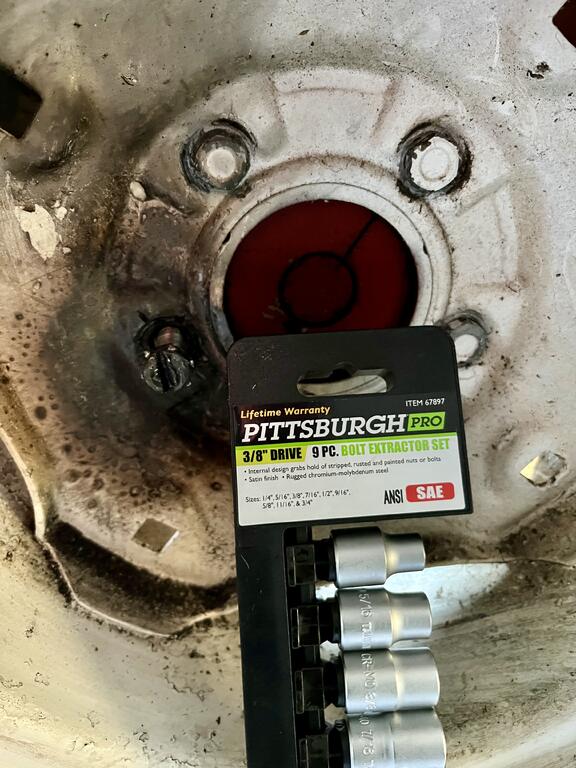

BrianKoch 336 #20784 Posted February 3, 2024 (edited) Gentlemen, Thank you for the suggestions on removing the stuck lug bolt. Today I picked up a bolt extractor kit from Harbor Freight (Pittsburgh Pro 67897) and had it out in no time! Edited February 3, 2024 by BrianKoch 5 8 Share this post Link to post Share on other sites

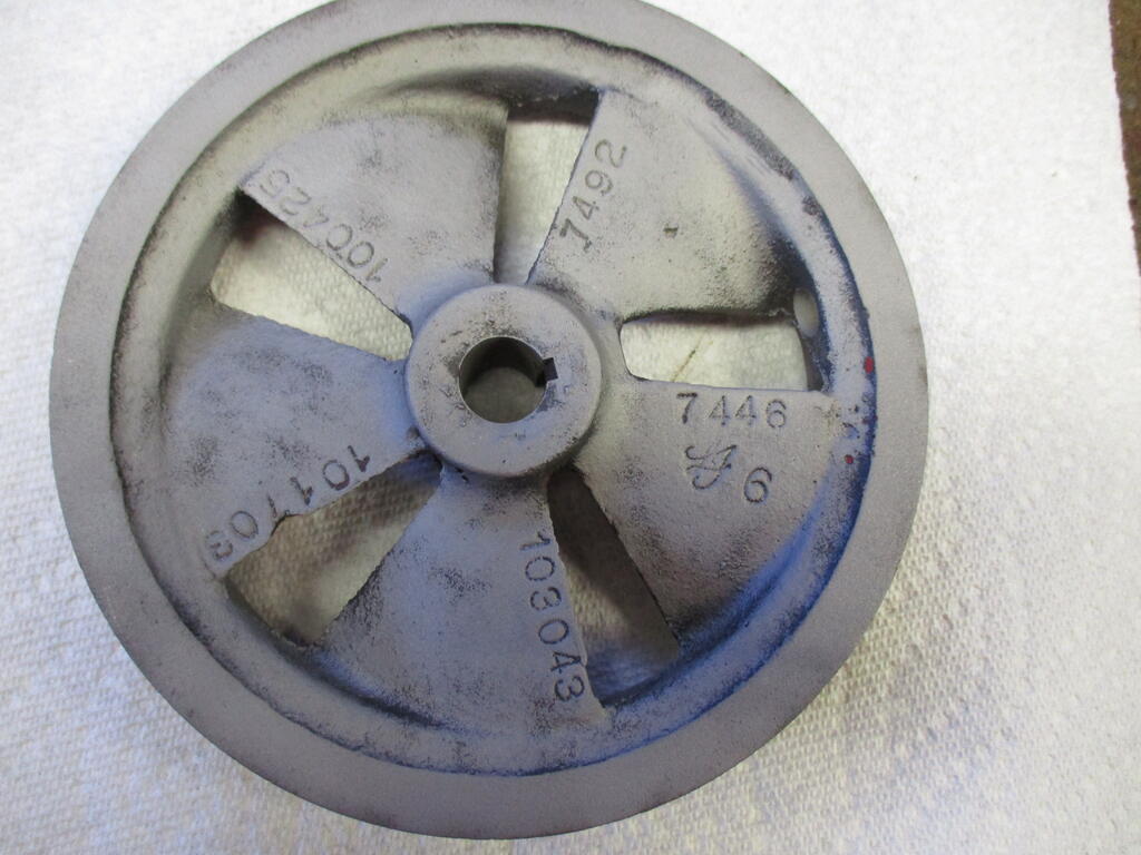

pfrederi 18,314 #20785 Posted February 4, 2024 I think the transmission input from the C-160-8 I am working on has an identity crisis...pick a part number.... 2 7 7 Share this post Link to post Share on other sites

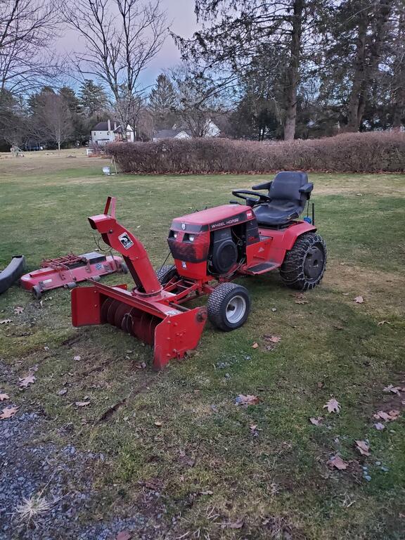

Cody 277 #20787 Posted February 5, 2024 Didn't get much done in the garage today but i did score this 314H today. Watched it on chrigslist for the last week and finally called about it. There was only 1 picture of it and it was poorly taken but the guy Said $400 come and get it. The auger is pretty beat up on the blower but it's fixable. Much to my surprise when I got there he drags out a mint 42" deck and power flow baggers too that were never mentined in the add. Anyday bringing home a new horse is a good day. 7 6 Share this post Link to post Share on other sites
ebinmaine 70,523 #20788 Posted February 5, 2024 6 hours ago, Cody said: Didn't get much done in the garage today but i did score this 314H today. Watched it on chrigslist for the last week and finally called about it. There was only 1 picture of it and it was poorly taken but the guy Said $400 come and get it. The auger is pretty beat up on the blower but it's fixable. Much to my surprise when I got there he drags out a mint 42" deck and power flow baggers too that were never mentined in the add. Anyday bringing home a new horse is a good day. Niiiiice. Looks like you got a GREAT deal there. Share this post Link to post Share on other sites

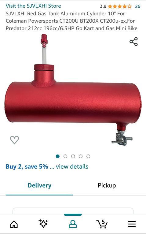

oliver2-44 10,323 #20789 Posted February 5, 2024 On 2/3/2024 at 12:07 PM, ML3 said: Not sure what I'll do now.......probably find another transmission I guess.... Disappointed about transmission You can rebuild that transmission in less time that it would take to drive and pickup another one. Where did you find the cool gas cap with the old school periscope level indicator 1 Share this post Link to post Share on other sites

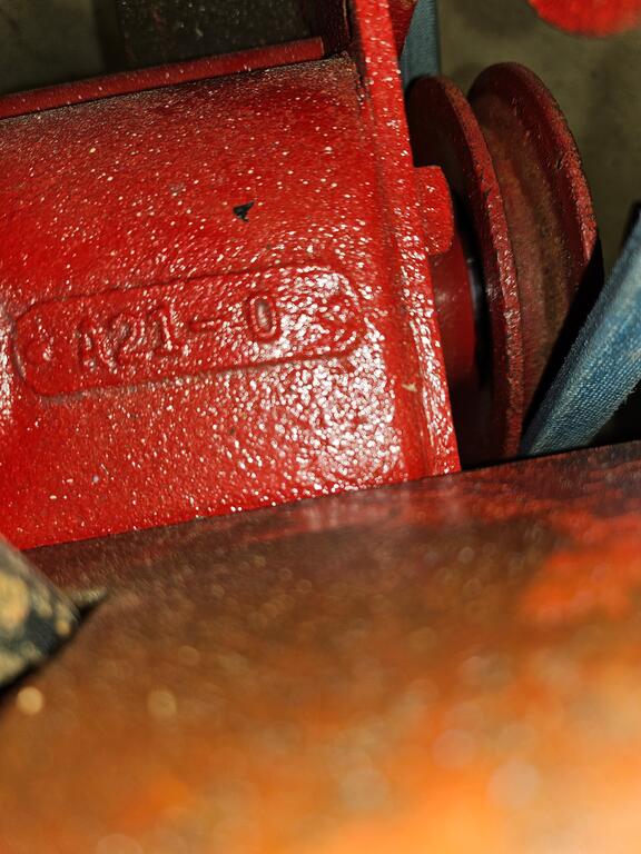

ML3 1,435 #20790 Posted February 5, 2024 1 hour ago, oliver2-44 said: You can rebuild that transmission in less time that it would take to drive and pickup another one. Where did you find the cool gas cap with the old school periscope level indicator I may have to rebuild transmission. Gotta figure out which trans it is to see what parts are available?? Stamped A21-0 on case. I just hate thought of pulling transmission apart. The gas cap is just a vent. It came with fuel tank. Bought it on Amazon. Share this post Link to post Share on other sites

oliver2-44 10,323 #20797 Posted February 5, 2024 (edited) 2 hours ago, ML3 said: I may have to rebuild transmission. Gotta figure out which trans it is to see what parts are available?? The A21-0 is a casting number and means that center casting was made on A=January 21=21st 0=1960 This date would point to it being for a 5010 transmission from a 1960 Suburban. However Wheel Horse was good at using us parts from the previous year model which would have been a 1958-59 RJ 5003 transmission. (You are on that late 59/early 1960 fence) They are essentially the same transmission But WH made some Service Bulletin changes and you won’t know Exactly what you have until you open it up (count the gear teeth on any gears you need to replace). The good thing is most parts are forward compatible and the 2 piece 3 & 4 speed transmission built through the late 1960’s used most of the same gears So lots of years of parts machines to gear gears from. Also if your axles are worn (and a lot of them are) you can flip them end ove end and drill a new roll pin hole, presto new axle bearing and seal surface. Where you would drill is not hardened, even a Texan like me has successfully done it. PS I really like this retrofit fuel tank you found. Original tanks in good condition are getting hard and expensive to find. Edited February 5, 2024 by oliver2-44 1 Share this post Link to post Share on other sites
