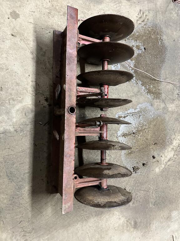

Pullstart 64,388 #20714 Posted January 26, 2024 Realized once again I’m 5 pages behind on this thread… And did some fixing and building on an old disc. I have three, might as well let at least one go… but why not fix it first? 2 5 Share this post Link to post Share on other sites

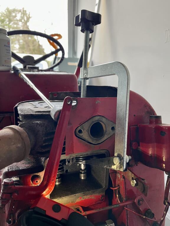

BrianKoch 336 #20721 Posted January 27, 2024 (edited) Gentlemen, Today I installed new valve retainers on the ‘69 Charger 12. Had to upgrade the bolt and lock nut assembly on the valve spring compressor (Lisle 23300) as the wimpy bolt and nut kept allowing the clamp to slide down rendering it useless. After that, I set the lash and now am reassembling the cover. Feels good to have this horse one step closer to running again! Edited January 27, 2024 by BrianKoch 7 1 Share this post Link to post Share on other sites

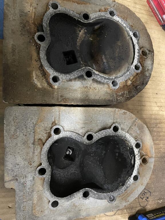

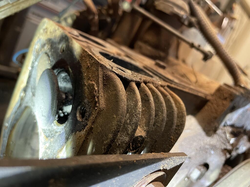

Tuneup 1,433 #20722 Posted January 28, 2024 So, too many dreary, rainy days and haven't gotten outside. Wreck 520 has two exhaust bolts to extract. One of them has a decent size hole I drilled center. One more bit, a cleaning tap, and I'll likely be OK. This has been my 'got no money' method for my whole life but for repairing the 48" deck and working for 40 years, I have a Harbor Freight mig setup. Still living on the cheap! Time to weld a nut. Problem is that the cheap HF helmet is too dang dark. Can't see what I'm doing and got tons of welders' advice - no help. It's just trash. Didn't have this problem in 1977 in welding class! Will invest in something better when I next need it for a significant job but for today, it's off to the races. First, the rear head comes off and may preclude me even having to weld, depending on that intake seat. 2 Share this post Link to post Share on other sites

Tuneup 1,433 #20724 Posted January 28, 2024 31 minutes ago, ebinmaine said: @Handy Don has a great wisdom in reminding all of us that proper safety gear is likely the best investment possible. I have an eye condition that doesn't allow me to adjust from light to dark very quickly at all. I do use a low priced auto darkening helmet. That helps. But my biggest salvation was getting a brighter light above my welded area. Yup, shone a 300 watt bulb on the job. No help. I think the one suggestion that the initial flash that darkens the shade has your eye overreact and over darken and to close the eyes until the flash passes. In related news, the P220 can be saved. Although it's breaking bolts left and right, it apparently has only 512 hours on it. The rear cylinder is burning oil pretty well. The intake area rather grimy so hopefully the seal but I'm going to re-ring it anyway. Intake seat nice and tight. 3 Share this post Link to post Share on other sites
