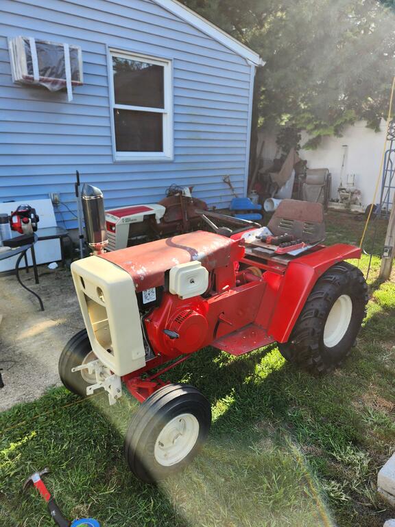

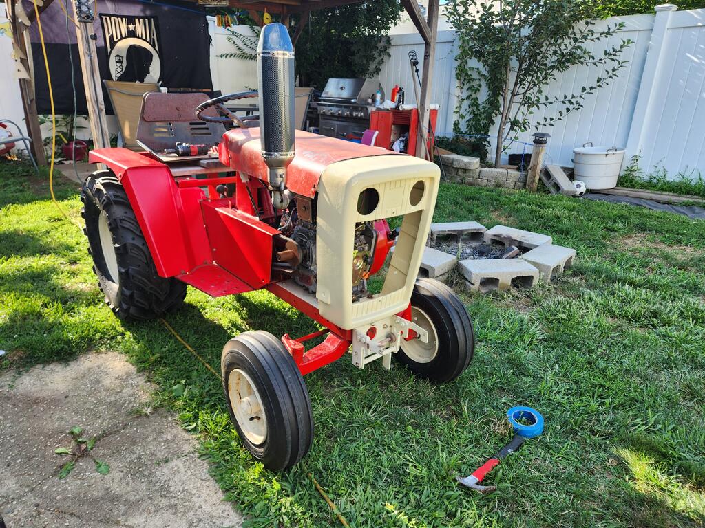

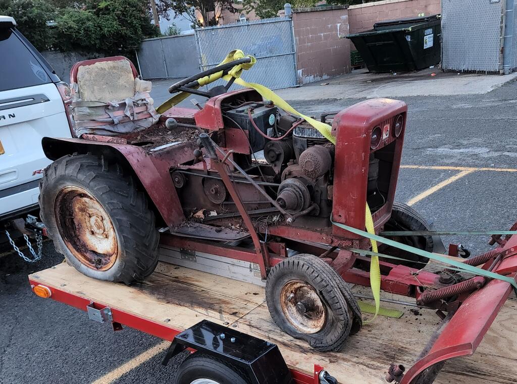

Monstrosity 1,102 #19830 Posted August 19, 2023 Well for $125 and a trip to staten island. Id say its coming along. The piece of stainless steel that she came with for a hood had to shape up and give sharper edges and trim for air cleaner and exhaust. Just need to strip it finish the cut edges and paint it almond. 4 9 Share this post Link to post Share on other sites

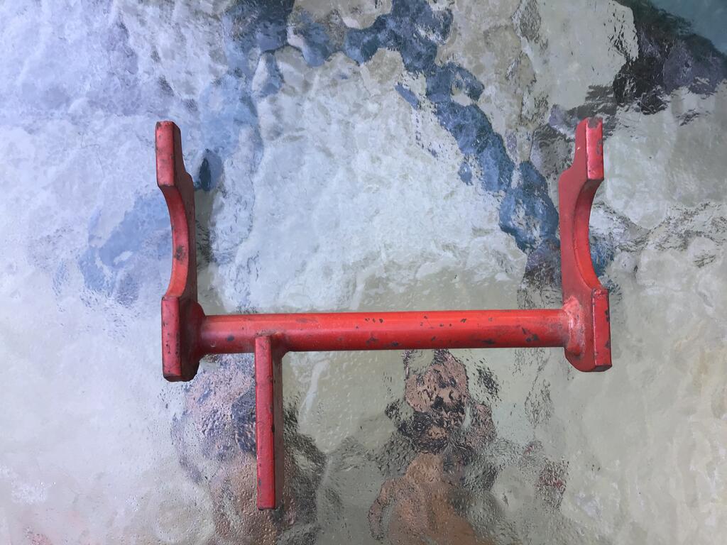

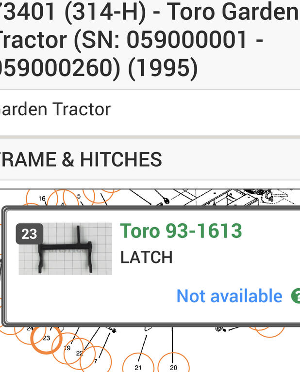

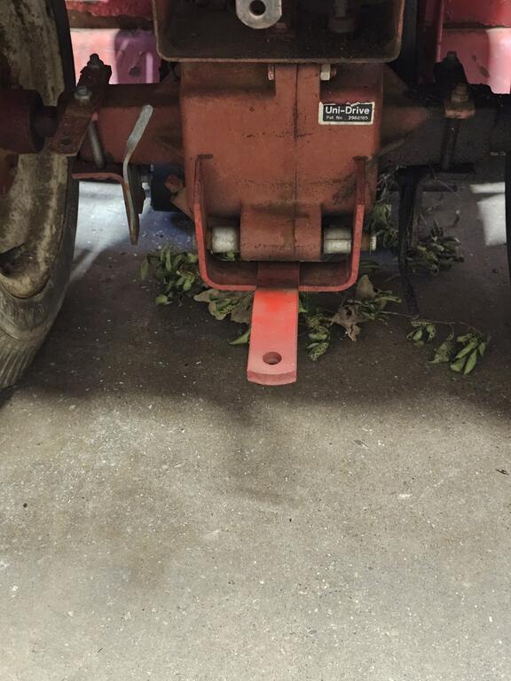

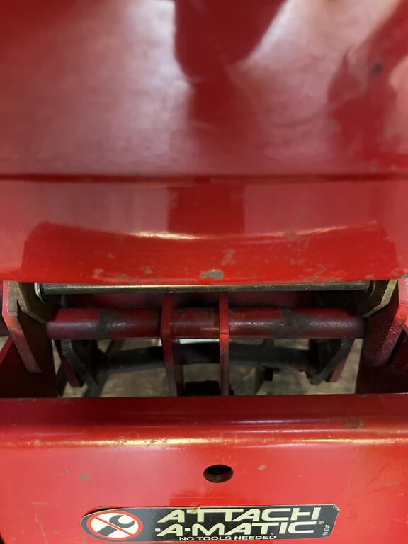

jamessparks 55 #19831 Posted August 22, 2023 Well, I knocked the horse out of gear today and ran into the shed! It bent the arm on my PTO Latch. (Part# 93-1613) Any thoughts on straightening this out or a replacement any one has local @Ed Kennell? Share this post Link to post Share on other sites
johnnymag3 2,508 #19832 Posted August 22, 2023 I believe I have a few of those laying around. Send me a good picture of yours so I can match.👍 1 1 Share this post Link to post Share on other sites
Evguy 554 #19833 Posted August 22, 2023 I bought a tractor with a bent latch, I was able to straighten it with a healthy pry bar while it was in place. I can’t assess the damage to yours, but mine was bent in the middle 2 1 Share this post Link to post Share on other sites

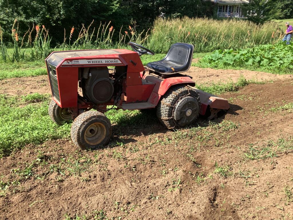

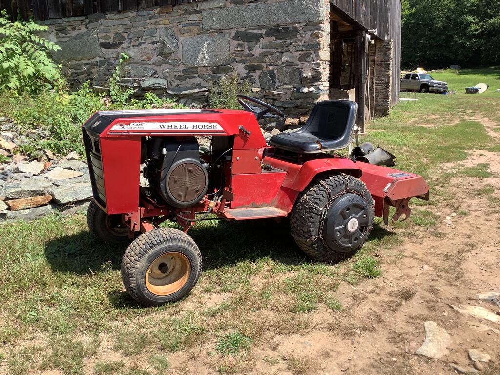

TonyToro Jr. 1,320 #19834 Posted August 23, 2023 Got the C-145 out of the barn today and did some rototiling with it. The gave it a Well deserved bath after. IMG_1364.MOV 5 3 Share this post Link to post Share on other sites

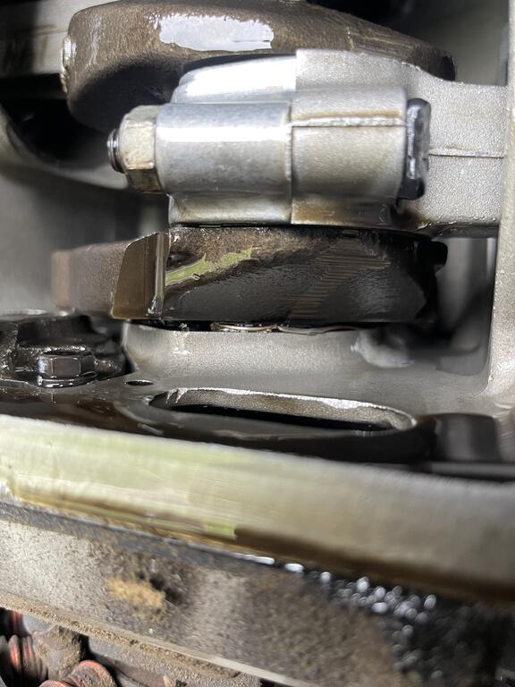

Desko 589 #19836 Posted August 26, 2023 It's been awhile but nothing to really show aside from mowing lawn but unfortunately that came to an abrupt end. The 520 decided to give up the ghost and take out the main bearing and shear the thrust washer off it the flywheel end which is a mystery to me as to why. When I built the engine everything was well within spec on the crank end play and bearing clearance and the pto bell wasn't set too tight. So hopefully it was a fluke thing and I can get away with putting a new bearing into it and resetting the end play. 1 4 Share this post Link to post Share on other sites

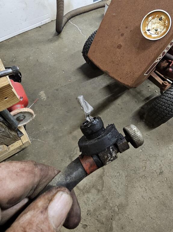

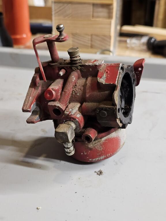

Jayoutdoors 82 #19837 Posted August 27, 2023 today was a hitch, carb cleaning, and discovering the fuel tank grommet was rotted and leaking. not pictured is the frozen choke cable lol 6 1 Share this post Link to post Share on other sites
Ed Kennell 37,492 #19838 Posted August 27, 2023 On 8/22/2023 at 2:11 PM, jamessparks said: replacement any one has local Sorry, I just saw this James. Been busy at the hospital. I'll look this afternoon if you still need one. Share this post Link to post Share on other sites
c-series don 8,529 #19839 Posted August 27, 2023 @jamessparks I have one if Ed doesn’t, I believe it’s NOS! PM me your address and I’ll ship it. Pay shipping and it’s yours, 10 bucks maybe? Share this post Link to post Share on other sites
Ed Kennell 37,492 #19840 Posted August 27, 2023 (edited) Thanks Don. We can also probably press your bent one back to straight James. Stop by If you want to straighten it. Update @jamessparks, I just checked. I only have one front and it is assembled in a complete att-O-mat that I don't want to break up. I have several mid mount a-o-ms, but they won't work on the front. Call me if you want to come straighten your bent one. Edited August 27, 2023 by Ed Kennell 1 Share this post Link to post Share on other sites

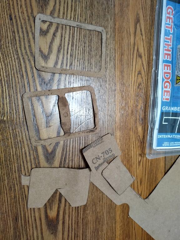

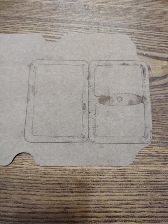

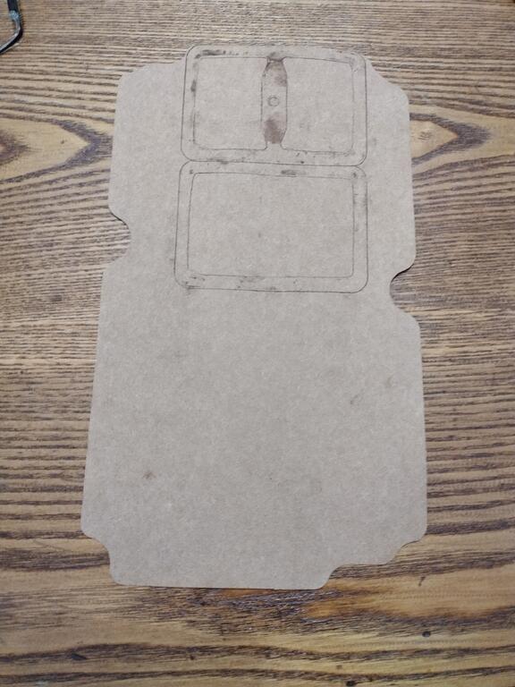

ebinmaine 66,582 #19841 Posted August 27, 2023 Checking valve settings on an M16 today. I didn't have a set of valve cover gaskets so I tried my hand at making some. The material is the center section of an old NOS manual transmission case half gasket. "Use what ya have" Thanks to @Oldskool for the hole punch set I'll use to finish up. 6 5 Share this post Link to post Share on other sites

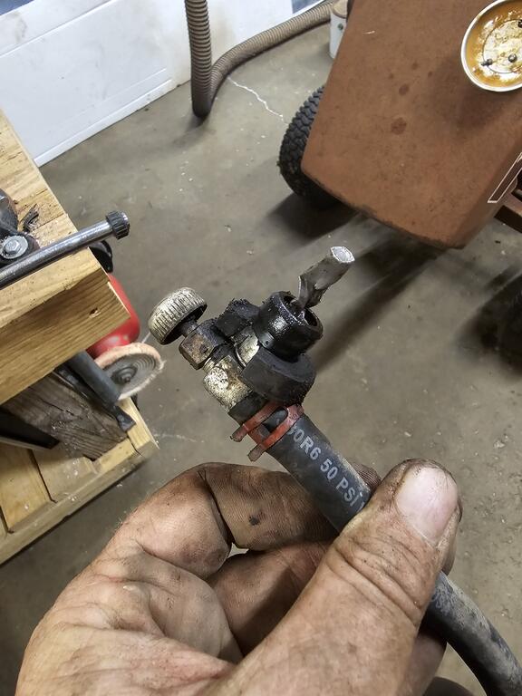

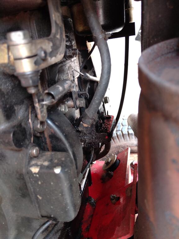

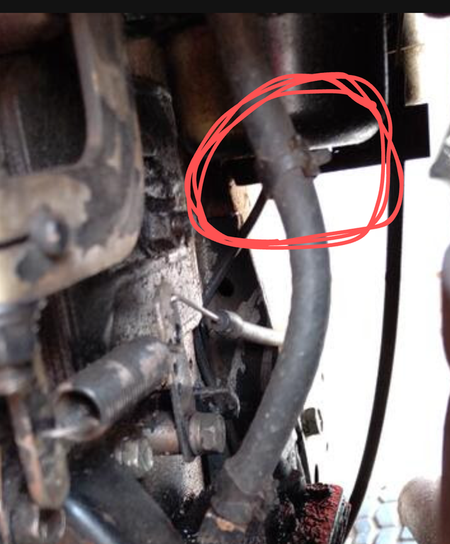

ML3 1,100 #19842 Posted August 28, 2023 Replaced fuel tank grommet/shut off a few weeks ago on C105. Finally got around to actually putting fuel back in tank...... Now the fuel pump is leaking! 🙄 Guess I'll order a new pump today. At least it's an easy fix. 2 Share this post Link to post Share on other sites
ebinmaine 66,582 #19843 Posted August 28, 2023 18 minutes ago, ML3 said: Replaced fuel tank grommet/shut off a few weeks ago on C105. Finally got around to actually putting fuel back in tank...... Now the fuel pump is leaking! 🙄 Guess I'll order a new pump today. At least it's an easy fix. While you're in there it would be a good idea to figure out why this clamp has slid down. Also replace that piece of fuel line because it looks pretty old. 1 Share this post Link to post Share on other sites
ML3 1,100 #19844 Posted August 28, 2023 I noticed that. Probably replace fuel hose & clamps when I do fuel pump 2 Share this post Link to post Share on other sites
ebinmaine 66,582 #19845 Posted August 28, 2023 14 minutes ago, ML3 said: I noticed that. DEFINITELY replace fuel hose & clamps when I do fuel pump With the age of these tractors and the poor fuels most of us have to use nowadays, I make it a point of maintenance. No longer a "possibility"... just has to happen. Share this post Link to post Share on other sites
ML3 1,100 #19846 Posted August 28, 2023 24 minutes ago, ebinmaine said: With the age of these tractors and the poor fuels most of us have to use nowadays, I make it a point of maintenance. No longer a "possibility"... just has to happen. True! I only use ethenol free gasoline in my yard equipment. 1 Share this post Link to post Share on other sites

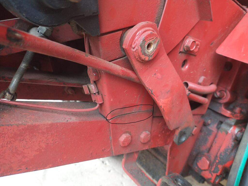

squonk 40,740 #19849 Posted August 28, 2023 I've noticed the hood on my C-160 doesn't always want to fit on the hood stand correctly. The other day when lowering the heavy recycler deck I noticed the hood and hood stand moving in different directions. I knew exactly where I had to look. Hood stand cracked right below the lift arm. Had to remove the running board, brake rod and brake pedal, hyd. lift control and cylinder to get enough access. I have an appt. with Billy Bob the welder on Thursday. 2 4 Share this post Link to post Share on other sites
