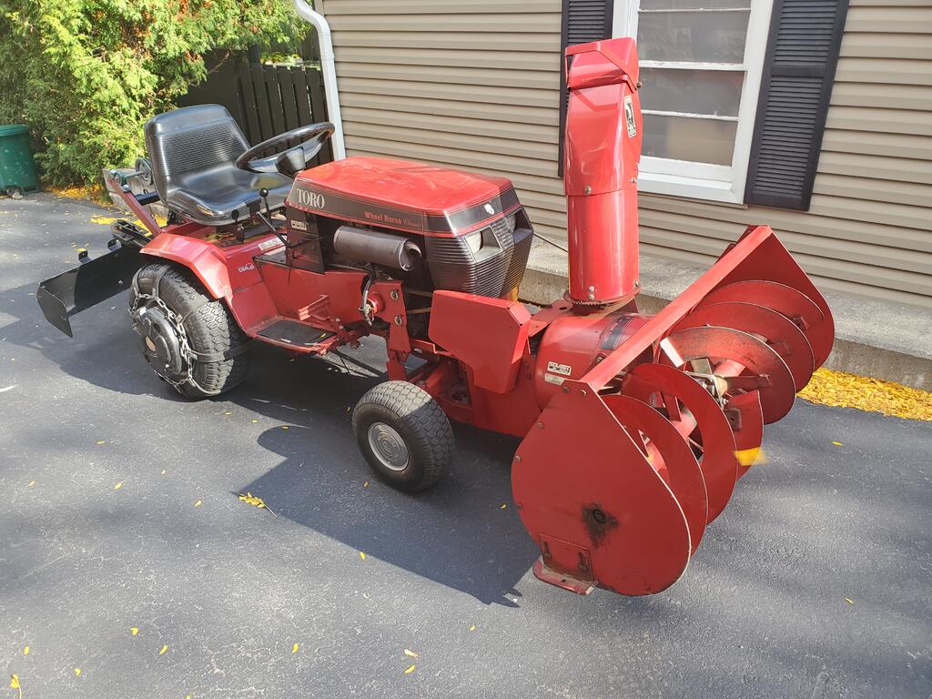

R Scheer 505 #17477 Posted October 26, 2022 Did the fall maintenance, and got it dressed for winter. 7 6 Share this post Link to post Share on other sites

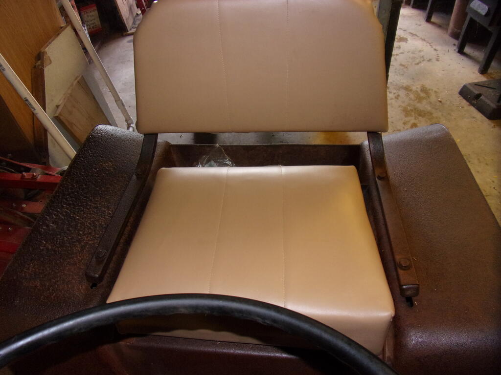

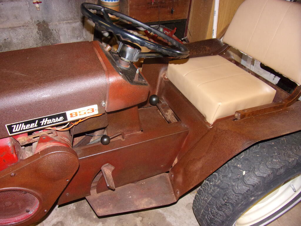

Wheelhorse#1 1,761 #17480 Posted October 27, 2022 5 hours ago, Ed Kennell said: I made a seat for the 953. I know, I know it's not black with a white stripe, but I had this FREE roll of tan vinyl and I actually think it looks good with the brown oil/rust finish. Great use of material.Fantastic job,most importantly cushion for the ars ! 3 1 Share this post Link to post Share on other sites
peter lena 9,092 #17481 Posted October 27, 2022 @Wheelhorse#1 looks good to me , is that an oil soak rub down ? has a familiar paint sheen to me . done that so regularly , don't even think about it , saved my horse paints , pete 1 Share this post Link to post Share on other sites
Ed Kennell 40,500 #17482 Posted October 27, 2022 2 hours ago, peter lena said: is that an oil soak rub down ? I actually rubbed this one with old used transmission fluid. 3 1 Share this post Link to post Share on other sites

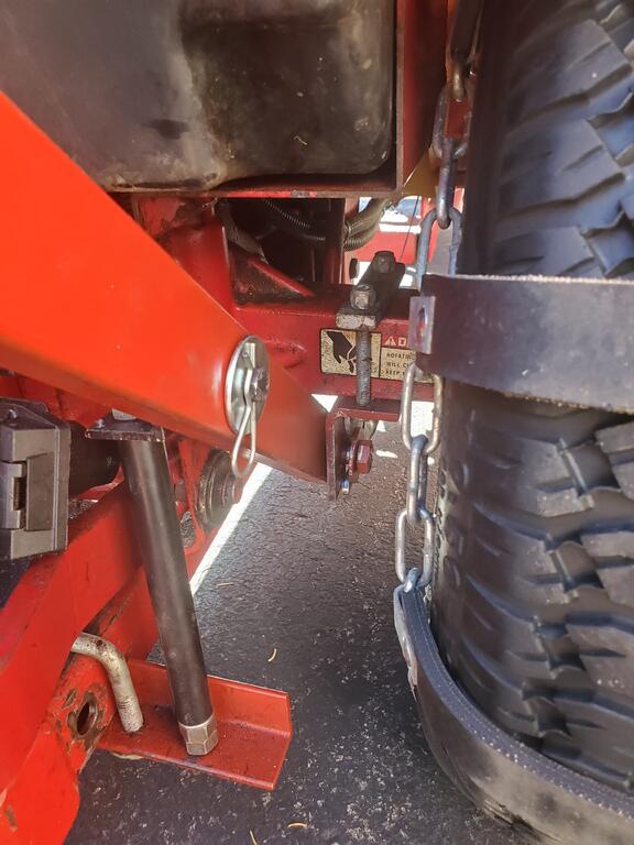

Handy Don 13,340 #17483 Posted October 27, 2022 17 hours ago, R Scheer said: Did the fall maintenance, and got it dressed for winter. Looks formidable! Assuming the winch is holding up the box scraper so the lift is handling the blower. Can you post close up images of how the winch arm is attached and braced, please? 1 Share this post Link to post Share on other sites
peter lena 9,092 #17484 Posted October 27, 2022 (edited) @Ed Kennell never used old atf , but the chemical cocktail of that would make sense , every time I see a faded neglected horse , thats my first thought , a double soak , rub in and dry , usually brings paint back to a recovery stage . then a 6" electric palm buffer and some cleaner wax brings it right out , the de[pth of color and clarity is amazing . stays like a fresh wax job . pete Edited October 27, 2022 by peter lena 1 Share this post Link to post Share on other sites
peter lena 9,092 #17485 Posted October 27, 2022 @Handy Don looks like you are ready , did you lubricate and adjust that , belt driven chain drive off the pto ? specific chain lubricant will stay with it , only a suggestion , pete Share this post Link to post Share on other sites

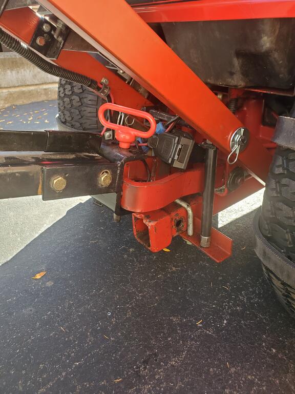

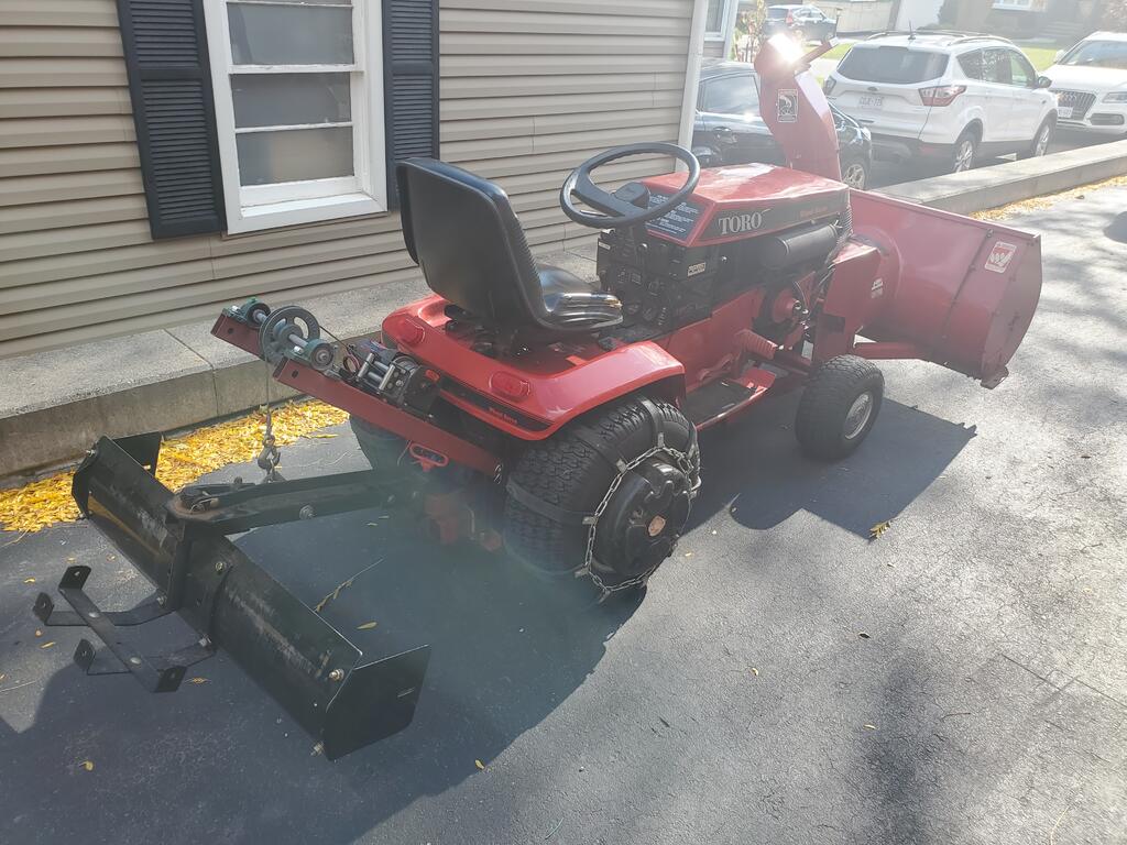

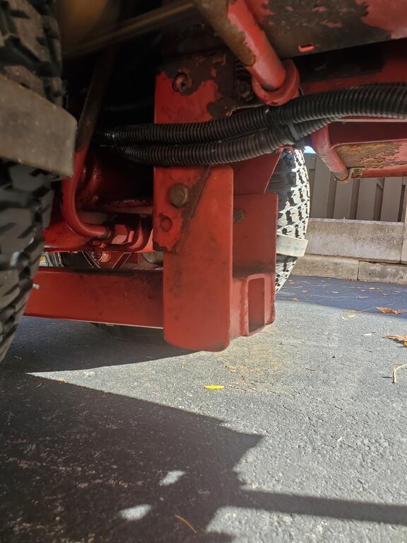

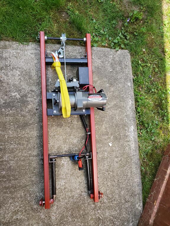

R Scheer 505 #17486 Posted October 27, 2022 2 hours ago, Handy Don said: Looks formidable! Assuming the winch is holding up the box scraper so the lift is handling the blower. Can you post close up images of how the winch arm is attached and braced, please? @Handy Don As requested I put this togethor somewhere I could operate the blade independent of the snowblower. The winch operates the blade and the hydraulics raise/lower the blower. Winch on the ground, this is an older version, the idler wheel and round bar were replaced. Front of ladder frame connected to rear axle using the plow mounts. I installed the plow mounts backwards so the bolts in the frame go against the mount and not the latch if that makes sense. Added angle iron to the receiver using a u bolt. The legs connecting the ladder frame to the angle iron are 1/2" all thread, with 1/2" black pipe to act as a spacer. The back of the tractor evolved over the years, the receiver was the first addition, and everything else was added as time went on. Seems to work so it can't be wrong. The front of the trailer receiver. Let me know if you need more pictures. 5 4 1 Share this post Link to post Share on other sites
sjoemie himself 3,076 #17487 Posted October 27, 2022 @R Scheer that is a clever setup you've got there. I especially like the use of the tach-o-matic for the drawbar/reciever. You are ready for snow for sure 2 Share this post Link to post Share on other sites

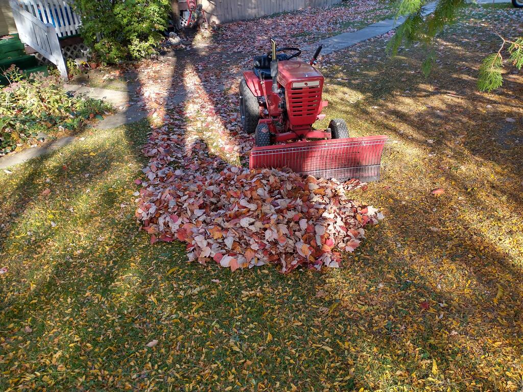

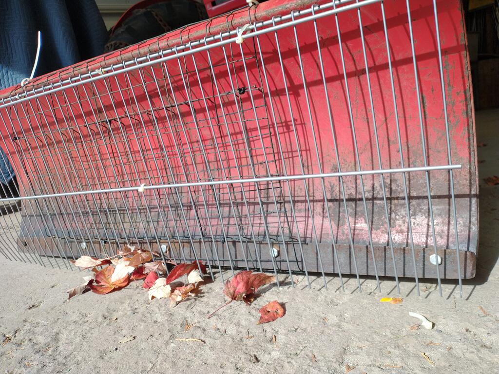

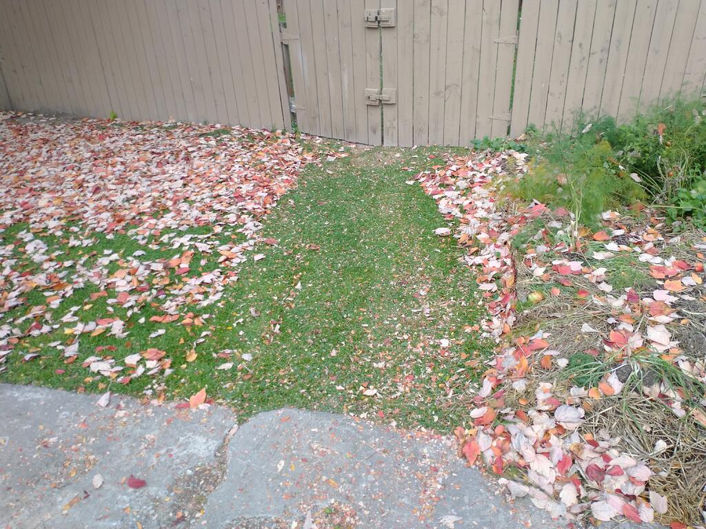

squonk 42,571 #17488 Posted October 27, 2022 We've had great weather for leaf grinding. I try to get out before it gets to thick. So every day a new blanket of leaves by my maple. Made an extension for my leaf blower and got the gutters. Then plowed the leave to a new spot in the yard for grinding. Do like my recycling deck! 6 3 Share this post Link to post Share on other sites
elcamino/wheelhorse 9,360 #17489 Posted October 27, 2022 @squonk What is that wire grid on your blade. Any better pictures ? 1 Share this post Link to post Share on other sites
squonk 42,571 #17490 Posted October 27, 2022 31 minutes ago, elcamino/wheelhorse said: @squonk What is that wire grid on your blade. Any better pictures ? There are 2 different pieces of mesh. Inner is what attaches to the blade. Old piece of shelving from the wife's green house. Outer piece is a piece of shelving from you favorite blue box store! I trimmed off an edge to give it a "rake effect" Drilled 2 holes in the blade and used zip ties for now. I can get you pics tomorrow 3 1 1 Share this post Link to post Share on other sites

Evguy 556 #17492 Posted October 27, 2022 10 minutes ago, squonk said: There are 2 different pieces of mesh. Inner is what attaches to the blade. Old piece of shelving from the wife's green house. Outer piece is a piece of shelving from you favorite blue box store! I trimmed off an edge to give it a "rake effect" Drilled 2 holes in the blade and used zip ties for now. I can get you pics tomorrow I like! I’m going to make similar device to scoop my fallen apples, tried plow but some would roll under and make applesauce. 2 Share this post Link to post Share on other sites

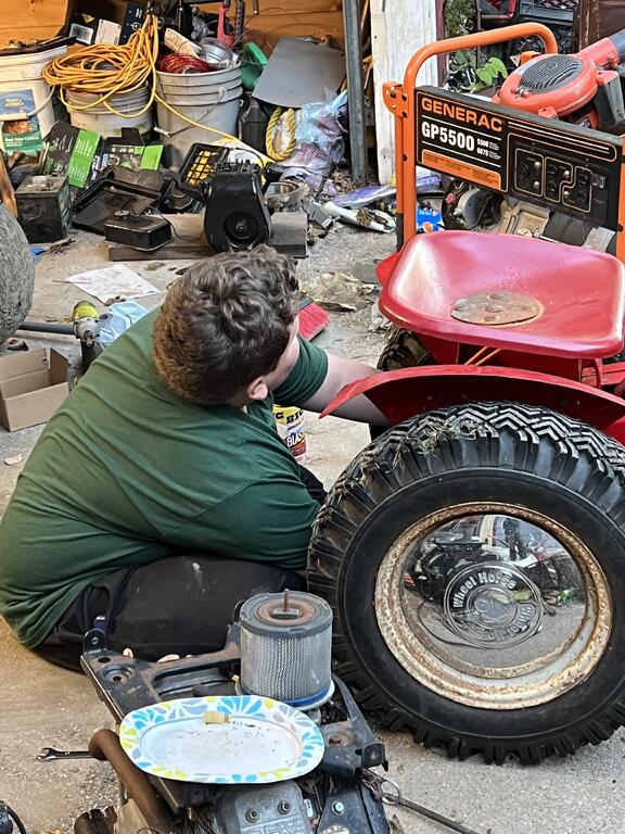

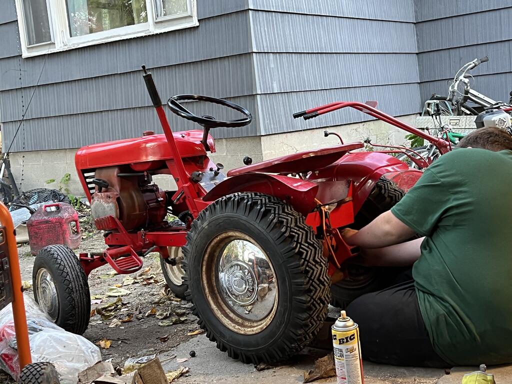

WheelHorse_Kid 355 #17493 Posted October 28, 2022 Today I put the plow bracket on my 604.I went into the shed and my dad showed me what plow was the right one out of all the plows we have. 10 4 5 Share this post Link to post Share on other sites
Heatingman 971 #17494 Posted October 28, 2022 7 hours ago, squonk said: We've had great weather for leaf grinding. I try to get out before it gets to thick. So every day a new blanket of leaves by my maple. Made an extension for my leaf blower and got the gutters. Then plowed the leave to a new spot in the yard for grinding. Do like my recycling deck! You have the lift stop set just to kiss the ground with that, or full weight of the plow? Pretty clever. 1 1 Share this post Link to post Share on other sites
Lee1977 7,041 #17495 Posted October 28, 2022 11 hours ago, R Scheer said: @Handy Don As requested I put this togethor somewhere I could operate the blade independent of the snowblower. The winch operates the blade and the hydraulics raise/lower the blower. Winch on the ground, this is an older version, the idler wheel and round bar were replaced. Front of ladder frame connected to rear axle using the plow mounts. I installed the plow mounts backwards so the bolts in the frame go against the mount and not the latch if that makes sense. Added angle iron to the receiver using a u bolt. The legs connecting the ladder frame to the angle iron are 1/2" all thread, with 1/2" black pipe to act as a spacer. The back of the tractor evolved over the years, the receiver was the first addition, and everything else was added as time went on. Seems to work so it can't be wrong. The front of the trailer receiver. Let me know if you need more pictures. .Different receiver hitch, I have done two types one clamped on the a the axle and braced to the transmussion pin. The other clamped on the axle and braced on the top of the transmission. If I get another Wheel Horse I'll nuild one similar to yours. 1 1 Share this post Link to post Share on other sites
ebinmaine 70,784 #17496 Posted October 28, 2022 14 hours ago, R Scheer said: trailer receiver. Man! That is slick. Where's the rear attachment welded on? At the stock cross hitch pin? Share this post Link to post Share on other sites
squonk 42,571 #17497 Posted October 28, 2022 7 hours ago, Heatingman said: You have the lift stop set just to kiss the ground with that, or full weight of the plow? Pretty clever. Lift stop is set so plow blade is about an inch off the ground. Tines extend down below edge. 3 Share this post Link to post Share on other sites
R Scheer 505 #17498 Posted October 28, 2022 3 hours ago, ebinmaine said: Man! That is slick. Where's the rear attachment welded on? At the stock cross hitch pin? Yes, it's welded to the bottom of the standard hitch. Undo the bolts at the front, pull the hitch pin, and the receiver drops straight down. Only issue is that it's a bit lower than I'd like. 1 Share this post Link to post Share on other sites
ebinmaine 70,784 #17499 Posted October 28, 2022 1 hour ago, R Scheer said: Yes, it's welded to the bottom of the standard hitch. Undo the bolts at the front, pull the hitch pin, and the receiver drops straight down. Only issue is that it's a bit lower than I'd like. The lack of clearance wouldn't permit me to use that on most of the tractors we have but I really like the idea. My half witt thought for a hitch on Colossus runs under the transmission like that but I was going to attach it a hair more forward on the frame. That way ALL the weight is divided between the wheels a little better but that's not really a huge issue on these tractors so I likely won't go that way. 1 Share this post Link to post Share on other sites
squonk 42,571 #17500 Posted October 28, 2022 19 hours ago, elcamino/wheelhorse said: @squonk What is that wire grid on your blade. Any better pictures ? Shelf is trimmed to create tines. Blade is about an inch off the ground. Still a work in progress 7 2 Share this post Link to post Share on other sites
