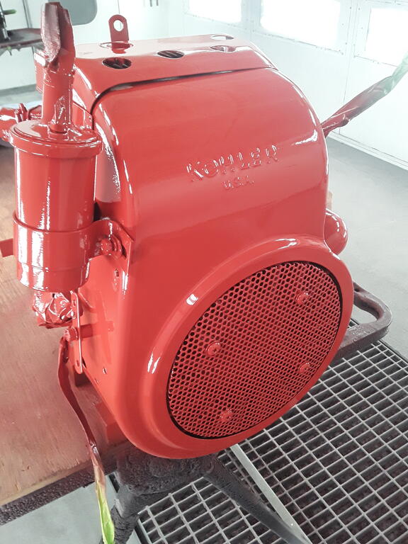

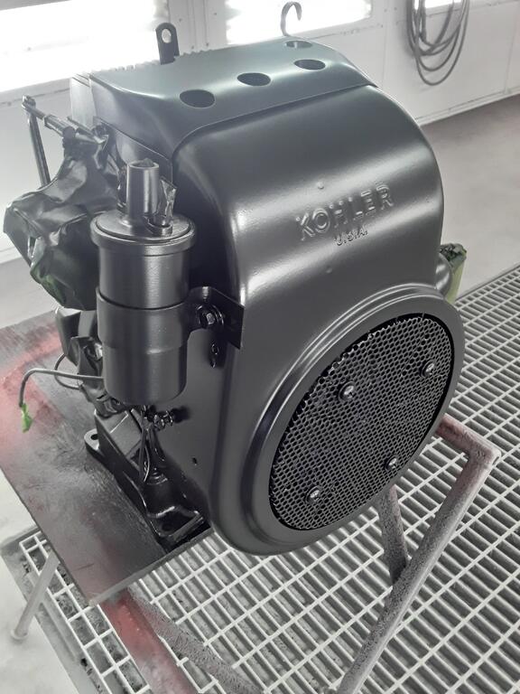

76c12091520h 3,788 #14902 Posted March 13, 2022 I painted 24 horses today 4 9 1 1 Share this post Link to post Share on other sites

ebinmaine 70,792 #14906 Posted March 13, 2022 7 hours ago, 76c12091520h said: I painted 24 horses today Were these 24 horses all in that one single cylinder Kohler?? 1 Share this post Link to post Share on other sites
Ed Kennell 40,513 #14907 Posted March 13, 2022 2X12=24 1 1 Share this post Link to post Share on other sites

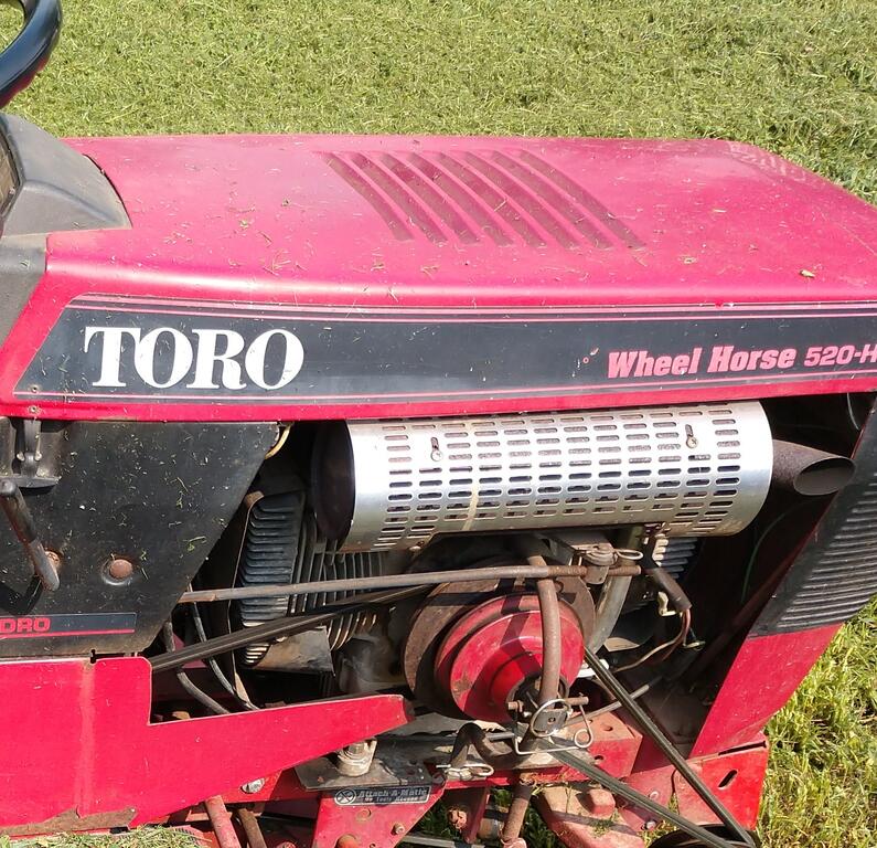

peter lena 9,092 #14908 Posted March 13, 2022 @Chestnut years back , we had a 27 " snow fall in April , that you don't forget , but our weather has been favoring the coast blow by direction , so you get what you get , question on the onan , FEL , ever consider adding some vent holes on the belt guard , to help that rear cylinder cooling ? lots of related pictures on site . like this , pete 1 Share this post Link to post Share on other sites

76c12091520h 3,788 #14910 Posted March 13, 2022 1 hour ago, Ed Kennell said: 2X12=24 10+14=24 1 Share this post Link to post Share on other sites
peter lena 9,092 #14911 Posted March 13, 2022 @76c12091520h 3x8= 24, where is this going ? pete 2 Share this post Link to post Share on other sites
Chestnut 315 #14912 Posted March 13, 2022 1 hour ago, peter lena said: @Chestnut years back , we had a 27 " snow fall in April , that you don't forget , but our weather has been favoring the coast blow by direction , so you get what you get , question on the onan , FEL , ever consider adding some vent holes on the belt guard , to help that rear cylinder cooling ? lots of related pictures on site . like this , pete I've seen a few of the threads about adding vent holes and I'm considering it. As for the early and late season storms, I've lived them. Trying to forget, but I was in SE New Hampshire for the April fool's storm. More vivid memories of the more recent trick or treat storm. Parts for the snowblower are due Monday and the repair won't wait. Just concerned about tearing up a muddy lawn to get to the drive and walkway if we get a late storm. 3 Share this post Link to post Share on other sites
kpinnc 13,770 #14913 Posted March 13, 2022 3 hours ago, peter lena said: ever consider adding some vent holes on the belt guard , to help that rear cylinder cooling ? Or just open the belt guard completely. The bracket that supports the top of the belt guard is restrictive by itself. And little holes make very little difference. 4 Share this post Link to post Share on other sites
peter lena 9,092 #14914 Posted March 13, 2022 @kpinnc I,M good with that , the less restrictive the air flow exhaust the better . keep it breezy , pete 2 Share this post Link to post Share on other sites

Lee1977 7,044 #14916 Posted March 13, 2022 1 hour ago, peter lena said: @kpinnc I,M good with that , the less restrictive the air flow exhaust the better . keep it breezy , pete I went just a little more, the guard isn't needed like on an eight speed. 6 1 Share this post Link to post Share on other sites
johnnymag3 2,559 #14917 Posted March 13, 2022 8 hours ago, ebinmaine said: Were these 24 horses all in that one single cylinder Kohler?? Why paint coils???? And accessories??? ..........have I been doing it wrong for 50 years? 1 Share this post Link to post Share on other sites
ebinmaine 70,792 #14918 Posted March 13, 2022 23 minutes ago, 8ntruck said: I'm thinking more along the lines of a combination of paint remover and Scotch Brite type of abrasives This is exactly the plan for ours. We have "abrasive sponge" type wheels for the 4" side grinder. Be VERY attentive. They really do work well. 1 Share this post Link to post Share on other sites
ebinmaine 70,792 #14919 Posted March 13, 2022 13 minutes ago, johnnymag3 said: Why paint coils???? And accessories??? ..........have I been doing it wrong for 50 years? Looks from here like the carb and fuel pump are blocked/masked off. I'd do the same, or remove them. I like a plain no paint carb. The coils I've seen both painted and not. I can't speak for what Wheelhorse did originally across all years. I believe that's a matter of personal preference. If I had a coil that's all scratched up and weathered you bet I'm painting it. 1 Share this post Link to post Share on other sites

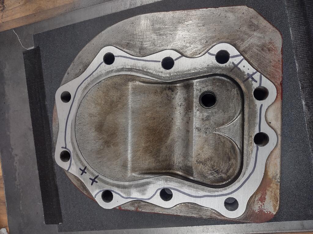

ebinmaine 70,792 #14921 Posted March 13, 2022 Been working on hand sand planing the cylinder head for the C-160 Automatic. You can see in the picture after me spending a fair amount of time already that the opposite corners where I put a black X still aren't even all the way out to the edge of the gasket surface... 2 2 Share this post Link to post Share on other sites
