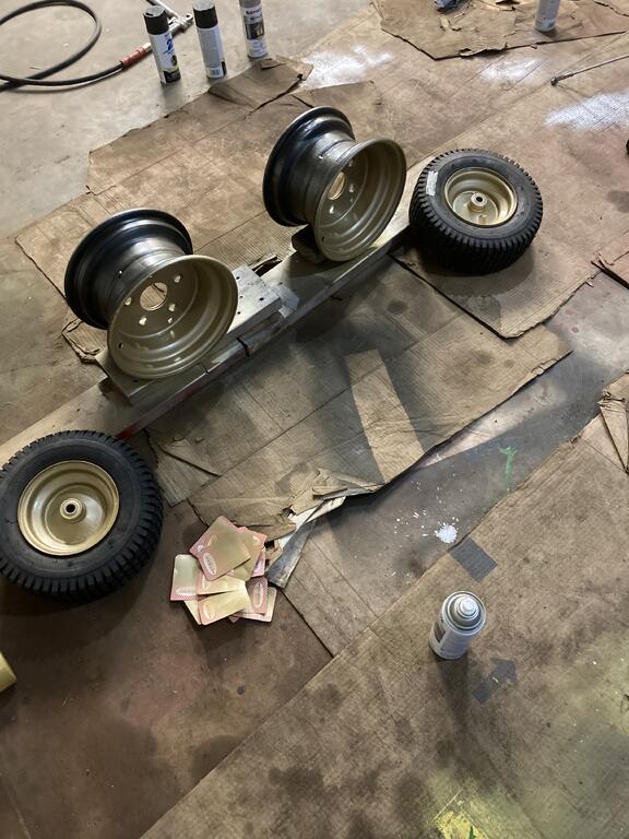

TonyToro 1,101 #14812 Posted March 3, 2022 Well…we aren’t working on a WheelHorse but we are working on WheelHorse parts for the gokart project. The rims came off a Commando V8. They are 10” rims. if anyone wants the factory 10” WheelHorse branded tires let me know. 4 Share this post Link to post Share on other sites

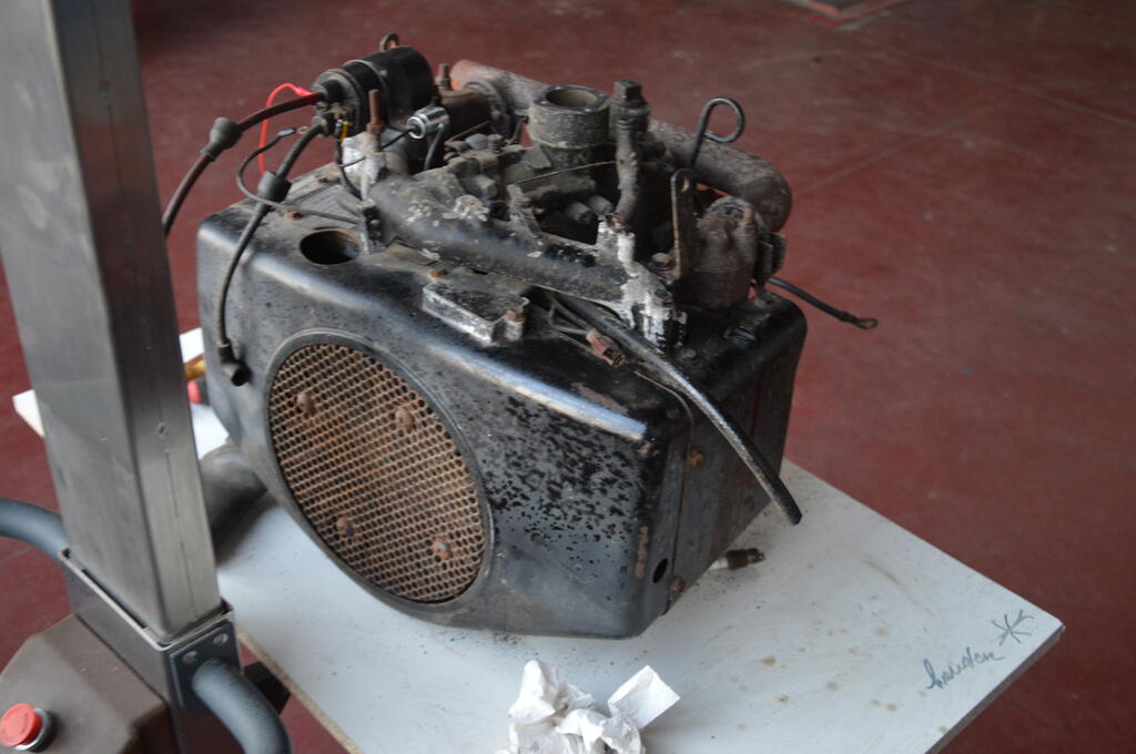

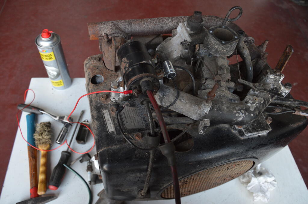

Maxwell-8 4,366 #14813 Posted March 3, 2022 (edited) 23 hours ago, Maxwell-8 said: I will start on getting the KT-17 running tomorrow. Well bad news. One cylinder is getting oil in it., it's seeping thru the rings. and shooting out when it cranks with the sparkplugs out. (You can see the oil on the enginecover. The pushrod for the points was stuck, so I had to hammer it down. Moves freely now. points adjusted, new condenser, new wiring, still no spark, so I guess a bad coil. This engine is 69 units older then the KT17 in my C175 hydro Looks like I will have to put the M16 in my C175-8 Edited March 3, 2022 by Maxwell-8 6 Share this post Link to post Share on other sites
pfrederi 18,339 #14814 Posted March 3, 2022 Based on what it cost to overhaul my M-18 I would say your KT-17 will make a nice doorstop 3 Share this post Link to post Share on other sites
Maxwell-8 4,366 #14815 Posted March 3, 2022 10 minutes ago, pfrederi said: Based on what it cost to overhaul my M-18 I would say your KT-17 will make a nice doorstop I am going to do a compression test and then take of the heads to see in which shape the bore is. Or just throw a Harley coil on it and pray it's just a stuck ring. I think WH only used 1 series KT17 on the C-175's which are weak engines. Share this post Link to post Share on other sites
kpinnc 13,784 #14816 Posted March 3, 2022 (edited) 19 minutes ago, Maxwell-8 said: think WH only used 1 series KT17 on the C-175's which are weak engines. The method of distributing oil around inside is the weak part. Magnum twins are almost identical, but have full pressure lube and an oil filter. Many parts will interchange between the two. Just nothing with an oil port on it. I have a "short block" M18 that I'm gearing up to rebuild, and then robs as much as possible from a complete KT-17 that I have with weak compression. Edited March 3, 2022 by kpinnc 2 Share this post Link to post Share on other sites
ebinmaine 70,802 #14817 Posted March 3, 2022 2 minutes ago, kpinnc said: The method of distributing oil around inside is the weak part. Does your experience with these series 1 engines tell you that they are inferior in general build to the series 2 or is it just that the distribution system doesn't allow for any kind of tilt during operation? 1 Share this post Link to post Share on other sites
Maxwell-8 4,366 #14818 Posted March 3, 2022 (edited) 2 minutes ago, ebinmaine said: Does your experience with these series 1 engines tell you that they are inferior in general build to the series 2 or is it just that the distribution system doesn't allow for any kind of tilt during operation? even then, Belgium is as flat as a pancake lol The C175-8 didn't come with an hour meter, meanwhile my c175 hydro did. That original kt17 lasted only 1000hours Edited March 3, 2022 by Maxwell-8 1 Share this post Link to post Share on other sites
kpinnc 13,784 #14819 Posted March 3, 2022 2 minutes ago, ebinmaine said: Does your experience with these series 1 engines tell you that they are inferior in general build to the series 2 or is it just that the distribution system doesn't allow for any kind of tilt during operation? My experience ends at what I can dig up on the web, and the fact that I just have one of each. I've read the horror stories same as everyone else, but have nothing much to add to them. Kohler says the KTs can operate on pretty high angles- so this might be in the same situation as 'Onans and the rear valve seat'. Might all be best guesses and theories based on proper maintenance or lack thereof. Translation: I only know what everyone else says... 2 Share this post Link to post Share on other sites
ebinmaine 70,802 #14820 Posted March 3, 2022 2 minutes ago, Maxwell-8 said: That original kt17 lasted only 1000hours Not to argue one way or the other .. just pointing out the fact that a lack of maintenance will easily wipe out many types of engines after a thousand hours. 1 Share this post Link to post Share on other sites
kpinnc 13,784 #14821 Posted March 3, 2022 1 minute ago, ebinmaine said: lack of maintenance will easily wipe out many types of engines after a thousand hours. Or only 100 hours... 2 Share this post Link to post Share on other sites
Maxwell-8 4,366 #14822 Posted March 3, 2022 Just now, ebinmaine said: Not to argue one way or the other .. just pointing out the fact that a lack of maintenance will easily wipe out many types of engines after a thousand hours. You would be surprised how very few of these engines get new oil every 25 hours. 1 1 Share this post Link to post Share on other sites
kpinnc 13,784 #14823 Posted March 3, 2022 3 minutes ago, Maxwell-8 said: You would be surprised how very few of these engines get new oil every 25 hours. Single cylinder Kohlers can tolerate poor maintenance for a while- and no, I'm not condoning it. But those KT twins do not! 2 Share this post Link to post Share on other sites
Maxwell-8 4,366 #14824 Posted March 3, 2022 3 minutes ago, kpinnc said: Single cylinder Kohlers can tolerate poor maintenance for a while- and no, I'm not condoning it. But those KT twins do not! The fact that the Honda on it now is also worn to the bone, tells me the previous owner doesn't know what maintenance means. 2 Share this post Link to post Share on other sites
ebinmaine 70,802 #14825 Posted March 3, 2022 9 minutes ago, Maxwell-8 said: You would be surprised how very few of these engines get new oil every 25 hours. Unfortunately I would not be all that surprised. It's flabbergasting to me how many people will buy something of good value and quality and treat it like it was a dollar store purchase. 1 3 Share this post Link to post Share on other sites
