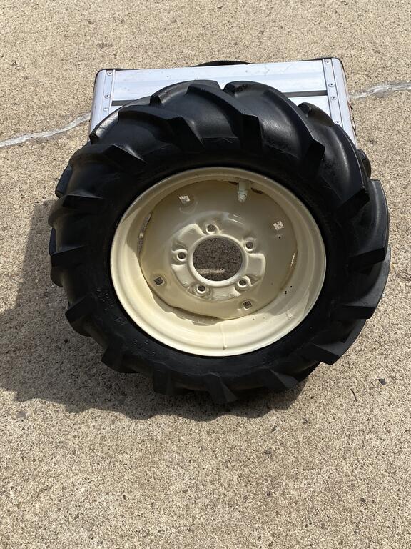

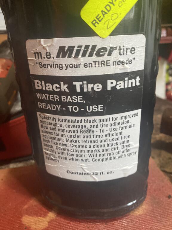

Lane Ranger 10,968 #8252 Posted December 21, 2020 (edited) Old tires always look better with M. E. Miller Tire paint. One or two coats on 60 year old tires will surprise even the most particular restorer to the quality look achieved ! The attached ag tire photo is of an original 1958 RJ tractor tire! I have used it for years and highly recommend its use. Edited December 21, 2020 by Lane Ranger 6 5 Share this post Link to post Share on other sites

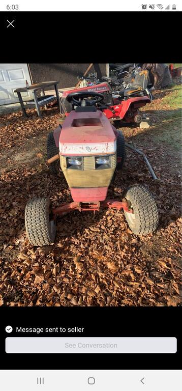

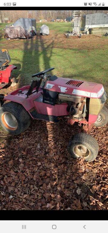

Jhook 849 #8253 Posted December 21, 2020 Hoping to add this 520h to the collection. Havent seen it in person but its cheap enough to take a gamble on. The pros from what i see are:mostly complete, good looking tires, i believe a forward swept axle, and the seller has more than 1 horse in the photos which is always a plus. Cons would be that its a non runner but seller says it turns over at least. Let me know what you guys think of it 2 Share this post Link to post Share on other sites
WVHillbilly520H 10,373 #8254 Posted December 21, 2020 16 minutes ago, Jhook said: Hoping to add this 520h to the collection. Havent seen it in person but its cheap enough to take a gamble on. The pros from what i see are:mostly complete, good looking tires, i believe a forward swept axle, and the seller has more than 1 horse in the photos which is always a plus. Cons would be that its a non runner but seller says it turns over at least. Let me know what you guys think of it Definitely not the original muffler, other horse is a gear drive you could make a 520-8?, engine turns over , take a wrench pull the plug's checks for compression could be 1 or both cylinders broken rods bad valve seats usually the rear one next to steering wheel, look over wiring harness IDK why most people who leave them set out like that have already cobbled that up, not hard to fix but adds to your overall cost, yes swept forward axle and most likely gear reduction steering, depending on price you can always recoup from parts? Go for it. 4 Share this post Link to post Share on other sites

Jhook 849 #8256 Posted December 21, 2020 24 minutes ago, WVHillbilly520H said: Definitely not the original muffler, other horse is a gear drive you could make a 520-8?, engine turns over , take a wrench pull the plug's checks for compression could be 1 or both cylinders broken rods bad valve seats usually the rear one next to steering wheel, look over wiring harness IDK why most people who leave them set out like that have already cobbled that up, not hard to fix but adds to your overall cost, yes swept forward axle and most likely gear reduction steering, depending on price you can always recoup from parts? Go for it. Will def do a compression test if i go and see it. I would keep it a hydro if i bought it. What catches my eye is 4 nice wheels and tires, that swept axle, and hopefully gear reduction steering. If the motor ended up being junk thats fine. But if i could get it running thats even better. What should compression numbers be on the 520 onan? Also whats the procedure? Both plugs out? Full throttle? I know bikes and jetskis need to be full throttle, never compression tested a tractor luckily i havent had anything but good runners yet. 1 Share this post Link to post Share on other sites

WVHillbilly520H 10,373 #8259 Posted December 22, 2020 12 minutes ago, Jhook said: Will def do a compression test if i go and see it. I would keep it a hydro if i bought it. What catches my eye is 4 nice wheels and tires, that swept axle, and hopefully gear reduction steering. If the motor ended up being junk thats fine. But if i could get it running thats even better. What should compression numbers be on the 520 onan? Also whats the procedure? Both plugs out? Full throttle? I know bikes and jetskis need to be full throttle, never compression tested a tractor luckily i havent had anything but good runners yet. Anything 100 and above, less than that could be anything from stuck rings and loose valve seats or carbon hanging a valve, I would do one plug out at a time and do both throttle closed and open and record, just be warned that back one is tight to get to. I am an ONAN fan but the looks of that 1 don't get your hopes up go in with low expectations and hopefully it turns out better. 2 Share this post Link to post Share on other sites

Jhook 849 #8261 Posted December 22, 2020 35 minutes ago, WVHillbilly520H said: Anything 100 and above, less than that could be anything from stuck rings and loose valve seats or carbon hanging a valve, I would do one plug out at a time and do both throttle closed and open and record, just be warned that back one is tight to get to. I am an ONAN fan but the looks of that 1 don't get your hopes up go in with low expectations and hopefully it turns out better. Well worst case i will keep the axle and steering components and the rims and tires. Sell the hood and fenders and other parts and should make the money back if i buy it for what i want to pay. Will see what the seller says tomorrow if he gets back to me 2 Share this post Link to post Share on other sites

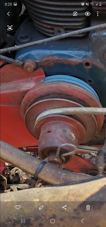

Jhook 849 #8262 Posted December 22, 2020 Can anyone tell me off the top of their head what size this outermost pto pulley is? I believe its 1/2 inch wide but i need the diamter. The loader is buried in the snow currently and im wanting or order a new hydro pump and pulley but need to know the size so i can order the proper pulley for the new pump. If not i can measure it tomorrow evening possibly. Its on a 1968 charger 12 the one with the brown belt. 1 Share this post Link to post Share on other sites

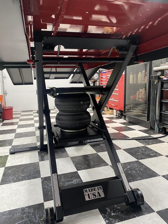

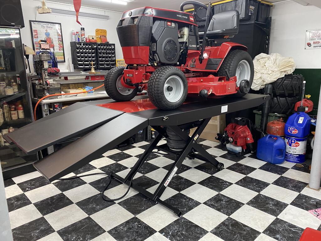

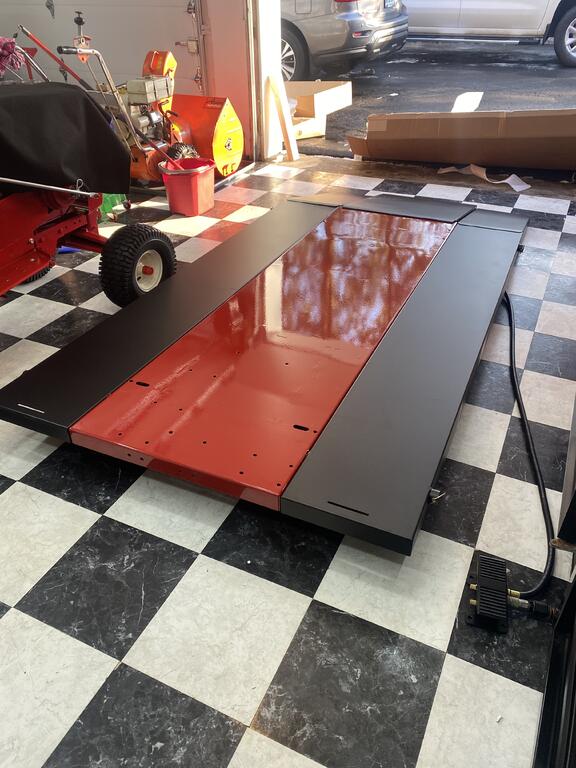

whtractors24 3,116 #8268 Posted December 22, 2020 Assembled my new USA made lift table for the horses. No more working on the ground . 6 8 Share this post Link to post Share on other sites

lynnmor 7,306 #8271 Posted December 22, 2020 14 hours ago, WVHillbilly520H said: Anything 100 and above, less than that could be anything from stuck rings and loose valve seats or carbon hanging a valve, I would do one plug out at a time and do both throttle closed and open and record, just be warned that back one is tight to get to. I am an ONAN fan but the looks of that 1 don't get your hopes up go in with low expectations and hopefully it turns out better. I doesn't matter where you have the throttle, the governor will open the throttle plate far enough for a compression check, of course a high throttle setting will insure that does happen. The rear plug can be easily reached using a very long extension with your 3/8" ratchet. Some handheld compression testers will not fit into the tight space. Removing both plugs would be a bit easier on the battery and starter, just be sure that the choke is open. Onan says that compression below 75 warrants engine work. 3 1 Share this post Link to post Share on other sites
WVHillbilly520H 10,373 #8272 Posted December 22, 2020 1 minute ago, lynnmor said: I doesn't matter where you have the throttle, the governor will open the throttle plate far enough for a compression check, of course a high throttle setting will insure that does happen. The rear plug can be easily reached using a very long extension with your 3/8" ratchet. Some handheld compression testers will not fit into the tight space. Removing both plugs would be a bit easier on the battery and starter, just be sure that the choke is open. Onan says that compression below 75 warrants engine work. Thank you sir, I was just trying to get him in the ballpark for a quick 1st time evaluation before he made up his mind to buy or not as the OP said the engine does not run now, I should have also mentioned to take a cheap spark tester along for checking that as well. 3 Share this post Link to post Share on other sites
pfrederi 17,739 #8273 Posted December 22, 2020 2 hours ago, whtractors24 said: Assembled my new USA made lift table for the horses. No more working on the ground . Where did you get that beauty?? 1 Share this post Link to post Share on other sites
whtractors24 3,116 #8274 Posted December 22, 2020 4 hours ago, pfrederi said: Where did you get that beauty?? Handy lift . 1 Share this post Link to post Share on other sites
sparkie333 265 #8275 Posted December 22, 2020 On 12/21/2020 at 9:49 AM, Lane Ranger said: Old tires always look better with M. E. Miller Tire paint. One or two coats on 60 year old tires will surprise even the most particular restorer to the quality look achieved ! The attached ag tire photo is of an original 1958 RJ tractor tire! I have used it for years and highly recommend its use. Great color paint on that rim. Please what color is the rim paint. Share this post Link to post Share on other sites
