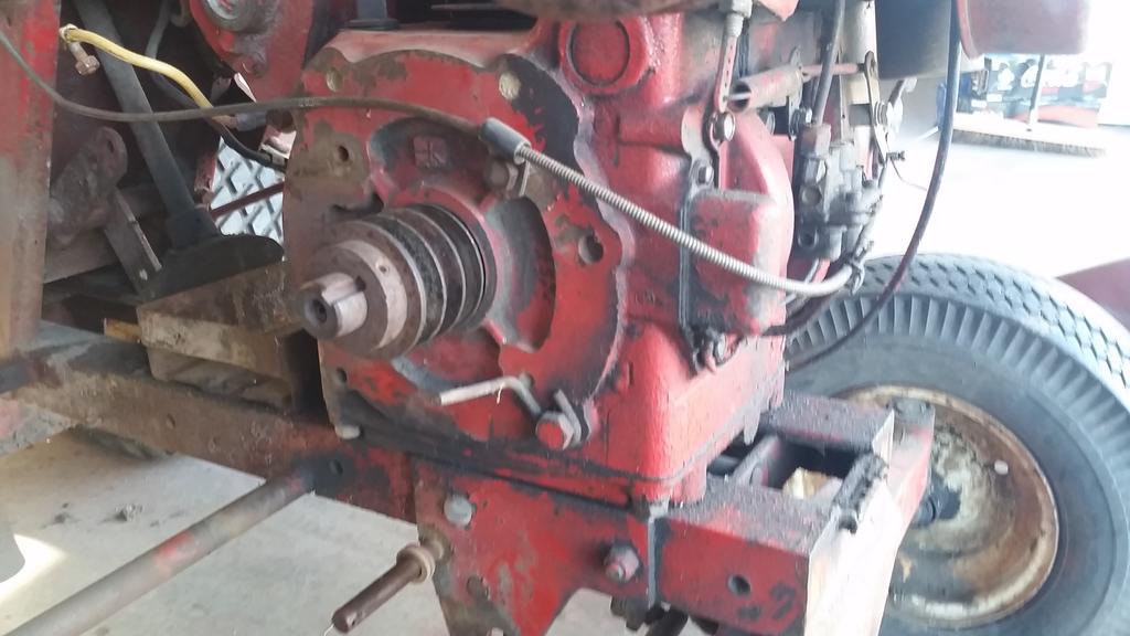

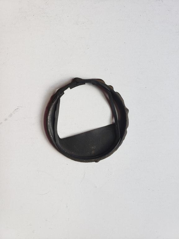

Racinbob 11,726 #2729 Posted July 19, 2019 The 854 I picked up at last years big show was run very little until recently. For months when I'd find a little time I would putter around with it getting things bolted together properly. It was missing so much hardware that I'm amazed it didn't end up in a pile of parts on the trip home. The engine had been cleaned up when I got it and I didn't notice much in the way of leaks until recently now that I'm running it and the bulk is from the breather area. I also couldn't get the carb tweaked to my liking so I decided to rebuild it since I'd have it off for access to the breather cover. Ya thunk this could be the problem? OK, carb rebuilt. No on to the breather. I cleaned things up. The PO had used the lovely blue silicone stuff. Fortunately it cleaned up good. I made new gaskets and ordered new breather filters. Note that Kohler now recommends using 2 filters in the K-181. Before I saw this I ordered 2 so I'd have a spare. So much for the spare now. They were delivered today. The clutch wasn't right. It was way too sloppy causing it to not engage properly. Enter a pair of 1/2" x 5/8" bushings a couple days ago. I had to grind off the old idler assembly but fortunately I had a spare from the two tractors that were given to me. Clutch is now smooth a silk and slop free. I need to finish the breather stuff and get the carb installed. I thought I'd do that this morning but after a few minutes out there I think I'll wait a couple days. It's HOTTTTT! 4 4 Share this post Link to post Share on other sites

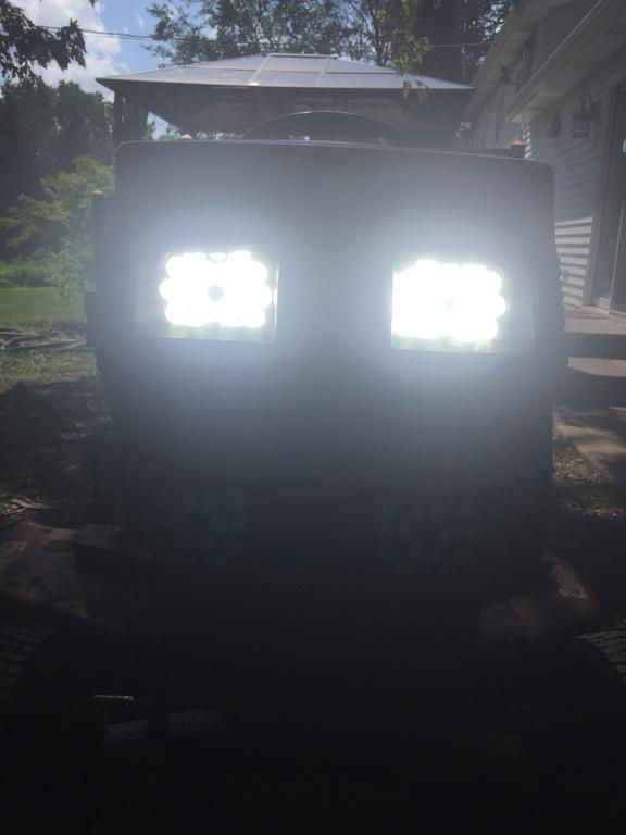

Andy N. 2,273 #2733 Posted July 20, 2019 Installed LED lights on the 418-A! I guess now I'll have to get them for the other 2 Horses. 5 1 Share this post Link to post Share on other sites

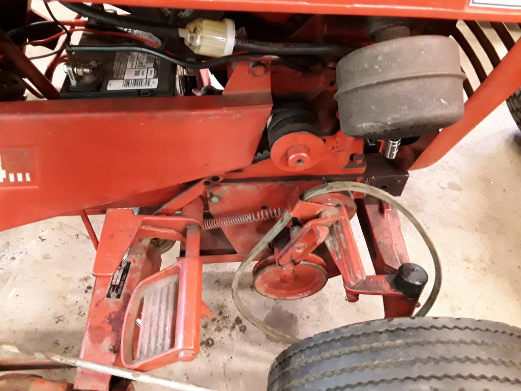

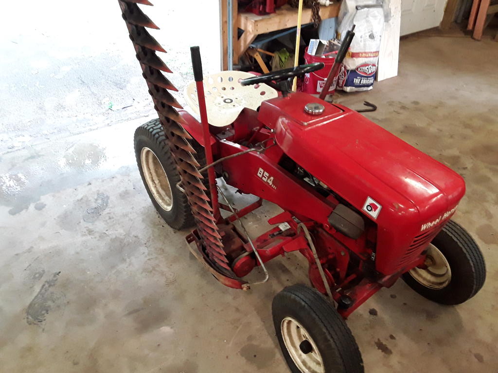

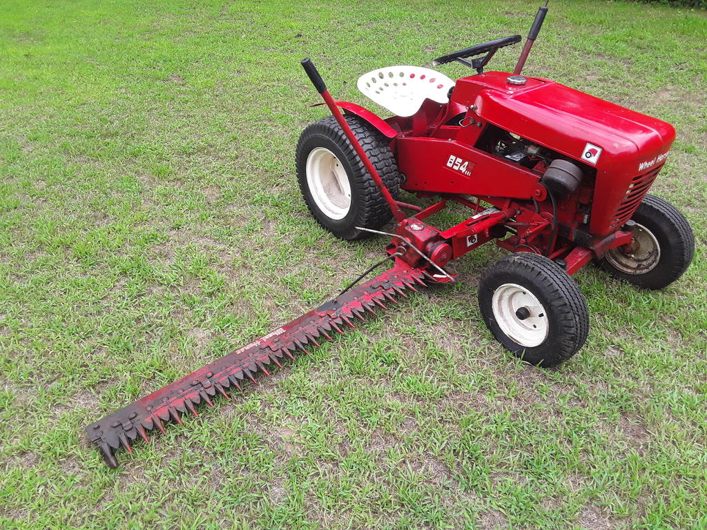

mhlmeader 689 #2734 Posted July 21, 2019 I got this sickle bar originally to put on my dad's tractor, buuuut it wouldn't fit right. So I gave it a try on my 854. Seems to bolt up correctly, anybody have an idea what the drive belt should be? I'm thinking 1/2 x 34? The 38 it came with was too long. Model 7-1312 , 50 inch bar. Anywho, this is what I messed with today...and it was HAWT!!!! 6 1 Share this post Link to post Share on other sites

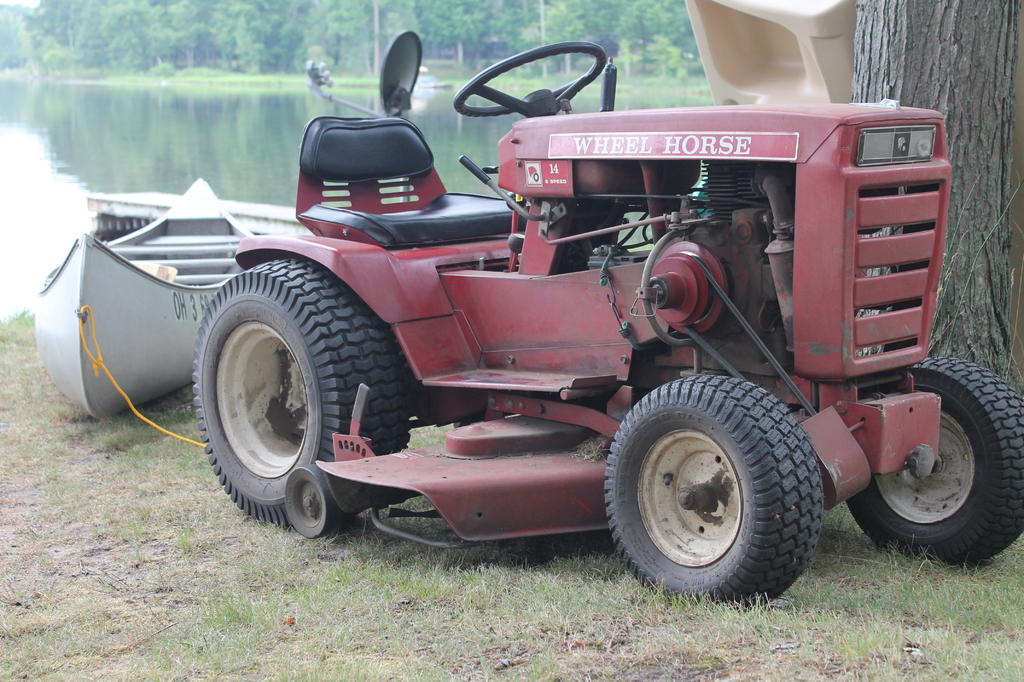

8ntruck 7,394 #2735 Posted July 21, 2019 (edited) Was in the low 90's yesterday with overcast and a pretty good breeze. My wife and I dug out the canoe and paddled around the lake for fun. Turned out that we were pretty tired when we got back in. So, I dug out the horse and put it on canoe duty to get the cane up the hill to storage. Edited July 21, 2019 by 8ntruck 7 2 Share this post Link to post Share on other sites
Ed Kennell 40,501 #2736 Posted July 21, 2019 That's a first....I use my WH to move boats on trailers, but never saw a WH dragging a canoe. 1 1 Share this post Link to post Share on other sites
8ntruck 7,394 #2737 Posted July 21, 2019 (edited) Dragged the pedal boat up the hill tonight. Not far, maybe 40 yards across the lawn. Easier than pulling the load myself! That canoe is an 18' aluminum Grumman. Weighs about 100 pounds. Edited July 21, 2019 by 8ntruck 1 Share this post Link to post Share on other sites

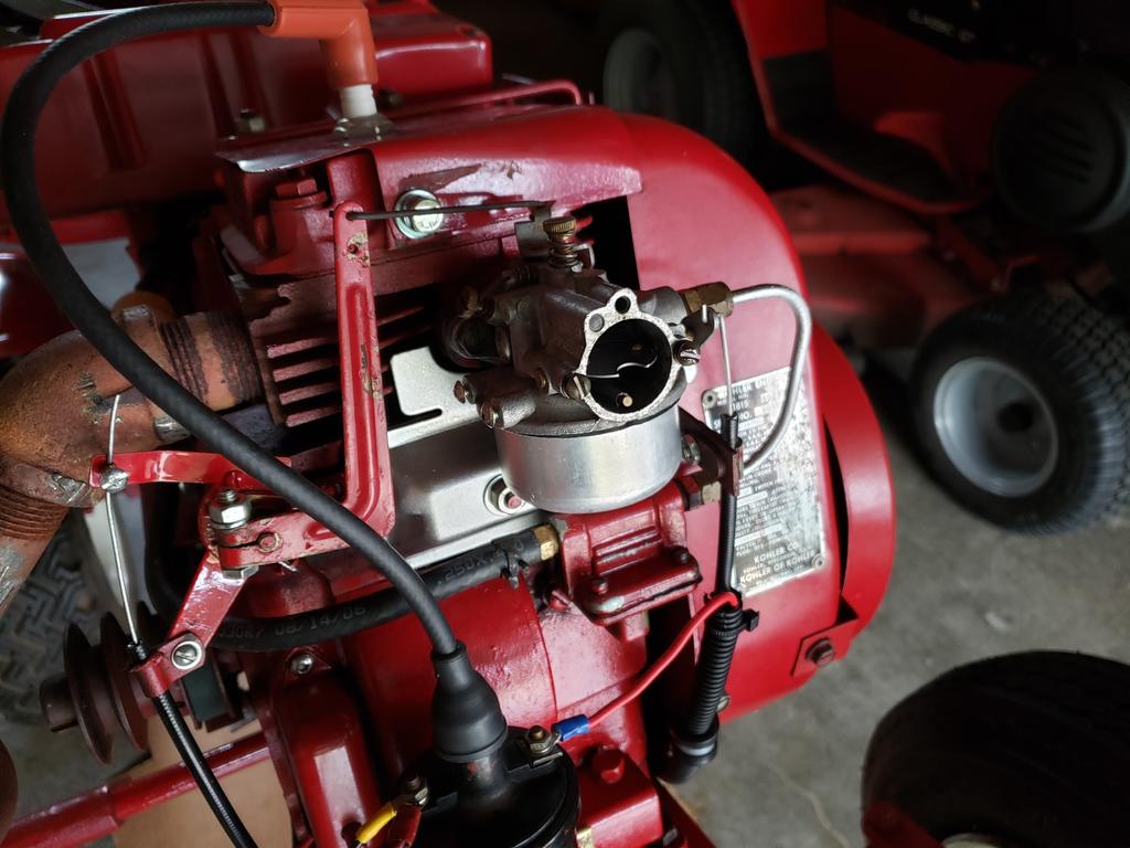

Racinbob 11,726 #2738 Posted July 21, 2019 It's a much nicer day today. I got the breather assembly put back together, the carb reinstalled and am ready to check her out. Hopefully the leaks are gone and I can get the carb adjusted properly now. 5 Share this post Link to post Share on other sites

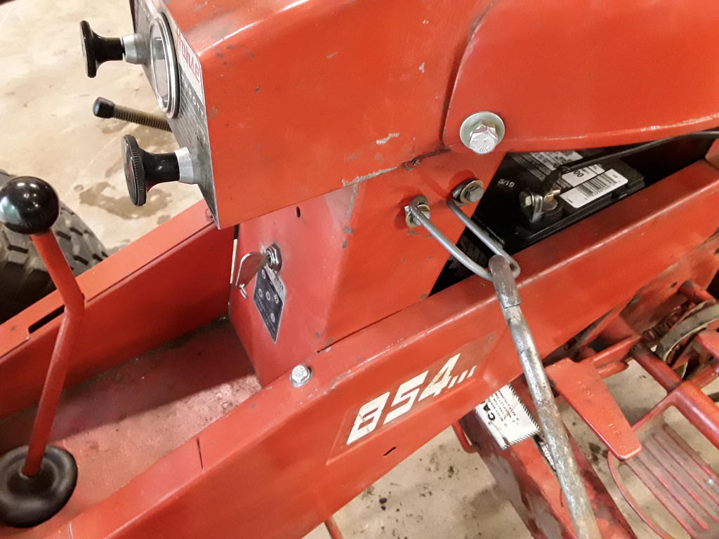

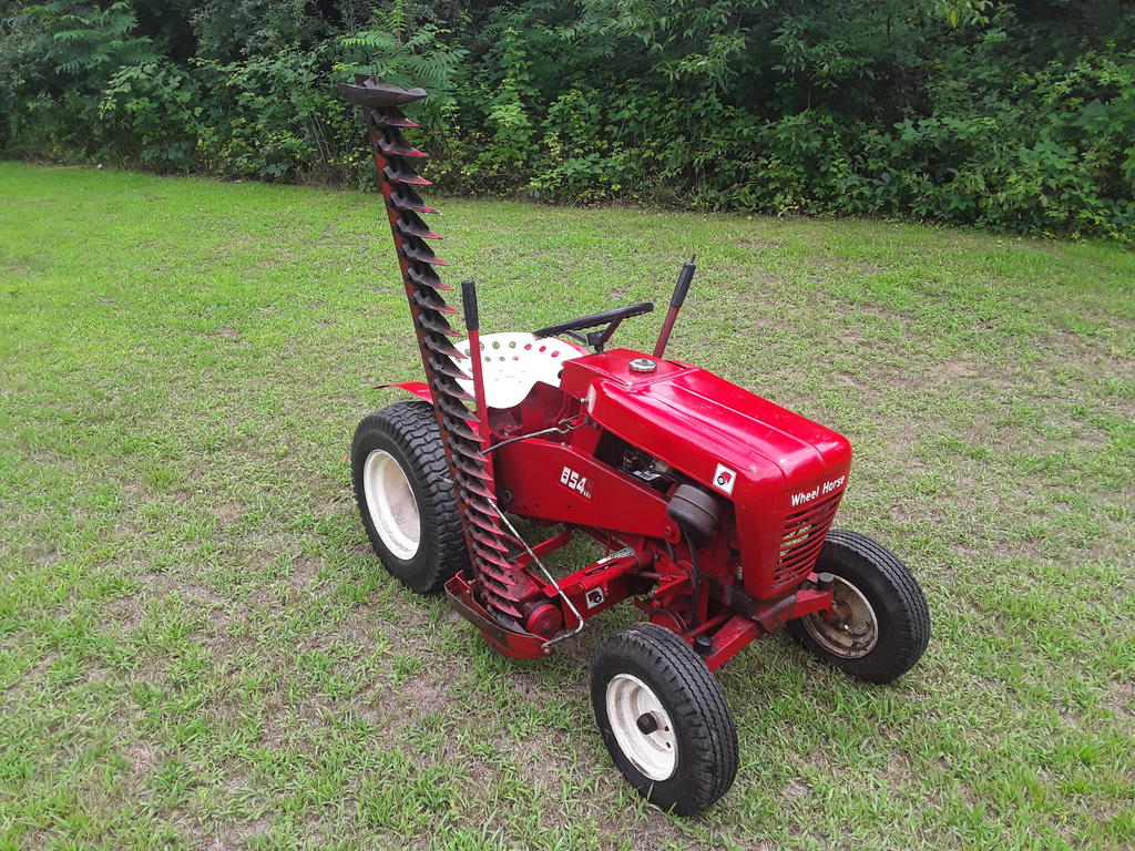

mhlmeader 689 #2739 Posted July 21, 2019 Got my sickle bar belted up, needs a little tweaking, but I think I got er'.... 12 3 Share this post Link to post Share on other sites
Pullstart 64,592 #2740 Posted July 22, 2019 16 hours ago, mhlmeader said: Got my sickle bar belted up, needs a little tweaking, but I think I got er'.... That thing looks right at home! What belt did you end up going with? 1 1 Share this post Link to post Share on other sites

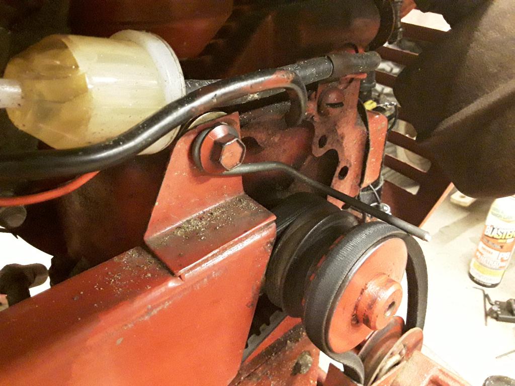

mhlmeader 689 #2741 Posted July 22, 2019 7 minutes ago, pullstart said: That thing looks right at home! What belt did you end up going with? I ended up using 1/2 x 35. Then I had to make a wire belt stop, as the belt still wanted to rotate abit when disengaged. Working pretty well now:) 2 1 1 Share this post Link to post Share on other sites
953 nut 57,979 #2742 Posted July 23, 2019 12 hours ago, mhlmeader said: Then I had to make a wire belt stop, Here is a picture of the factory belt stop, but yours looks fine. 1 Share this post Link to post Share on other sites

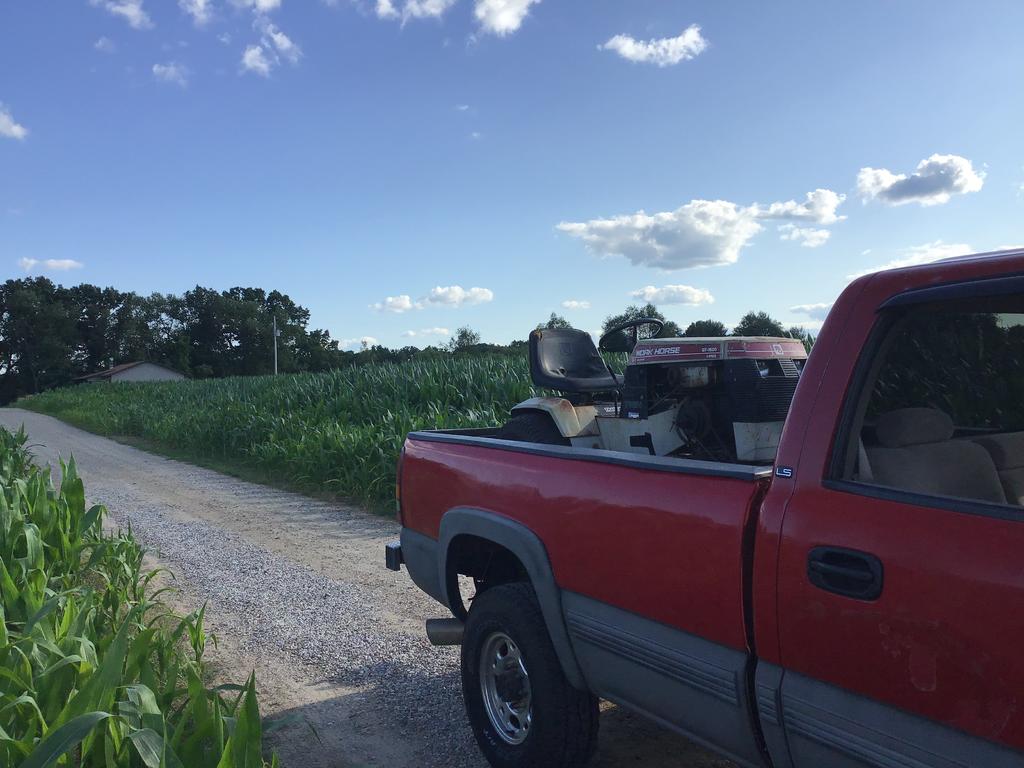

Pullstart 64,592 #2743 Posted July 23, 2019 Played with the new Briggs I/C powered GT-1600 tonight. The fuel line is plugged bad to the tank under the seat. I managed to blow air through the line into the tank but still could not get anything through. So I put a small piece of hose into a gas jug from the fuel pump and had Rylee crank it over again. Now fuel’s spitting out of a weep hole on the pump cover! The P.O. mentioned it might need some pump work, leads me to believe it’s been apart before? So I’ll need to find a pump kit for that Briggs engine AND find the plug in the fuel system. @Blackhood Bill do you off hand know of any part numbers for a fuel pump diaphragm kit? 2 3 Share this post Link to post Share on other sites
Achto 28,797 #2744 Posted July 23, 2019 19 minutes ago, pullstart said: do you off hand know of any part numbers for a fuel pump diaphragm kit? Ok I'm not completely sure which engine your new tractor has. Is that an opposed BS twin? Fuel pumps on those were a common problem. If that is what you have hopefully it is the 3 screw pump as those are a little cheaper than the 4 screw pumps. Here is a site that offers the rebuild kits, even if you don't order from them you will be able to get the factory part #'s from their site. http://www.psep.biz/store/briggs_stratton_fuel_pump.htm 2 1 Share this post Link to post Share on other sites

Pullstart 64,592 #2746 Posted July 23, 2019 7 hours ago, Achto said: Ok I'm not completely sure which engine your new tractor has. Is that an opposed BS twin? Fuel pumps on those were a common problem. If that is what you have hopefully it is the 3 screw pump as those are a little cheaper than the 4 screw pumps. Here is a site that offers the rebuild kits, even if you don't order from them you will be able to get the factory part #'s from their site. http://www.psep.biz/store/briggs_stratton_fuel_pump.htm It’s good to know the three screw is the better one! That’s what I ended up with. 1 Share this post Link to post Share on other sites

Blackhood Bill 721 #2750 Posted July 23, 2019 (edited) @pullstart according to tractor data.com that came with a 655 cc twin cylinder Briggs. Made in 1984. I'm not sure of the part number your asking for. I'd bet that Lincoln at A-Z could help you with one. Does it run? Sure would be a great addition to the herd! Edited July 23, 2019 by Blackhood Bill 1 Share this post Link to post Share on other sites
