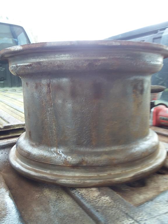

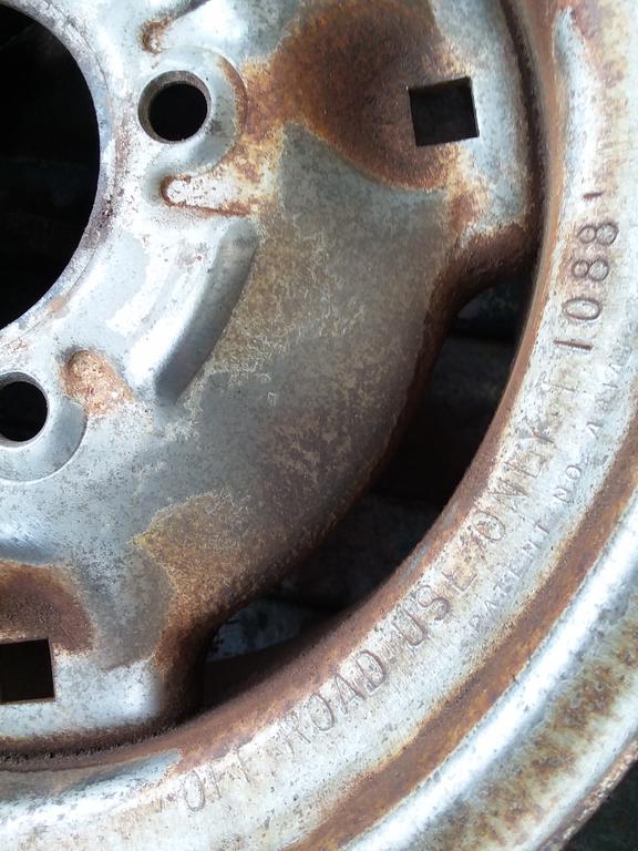

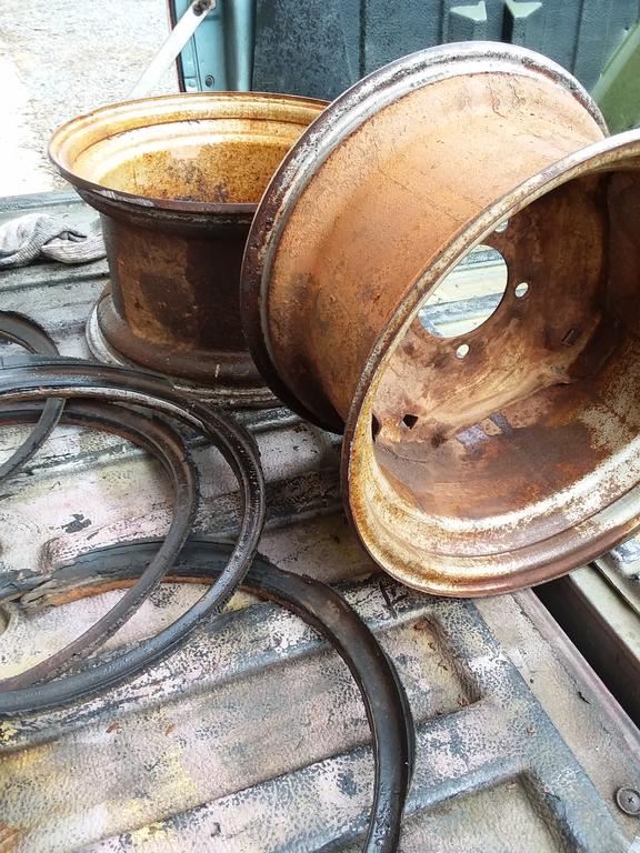

Goldann520 242 #253 Posted March 21, 2018 @Sarge, @953 nut, @dells68, thanks guys giving me some hope and DRIVE to save em. Really want to cause they're the wider deep dish rims than I have. Tires have holes big enough to see through. Sat flat forever. Lots of rust on rims but still solid. 2 Share this post Link to post Share on other sites
Goldann520 242 #254 Posted March 21, 2018 Thanks @elcamino/wheelhorse, have a couple harbor freight stores down here. Will check it out if not too steep. 1 Share this post Link to post Share on other sites

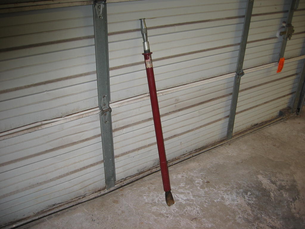

pfrederi 18,283 #255 Posted March 21, 2018 (edited) 15 hours ago, Goldann520 said: Thanks @elcamino/wheelhorse, have a couple harbor freight stores down here. Will check it out if not too steep. I have both the Harbor Freight small tire and regular size tire machines. Both do sort of OK for what they were designed for. However they do not do real well if the tire bead is really stuck on the rim. i bent the heck out of the bead breaking part of the larger machine. To break stubborn beads i use one of these. The gray one is a beast and will do up to 24 inch wheels. But it is a bit slow. Most time i resort to the slide hammer. Edit: started thinking about how much I have invested in tire tools, also have 10 different Kentool tire irons and Cheatah bead seater. But rough calculation between WHs Big tractors military vehicles and trailers/wagons i have over 100 pneumatic tires to worry about. Edited March 21, 2018 by pfrederi 2 1 Share this post Link to post Share on other sites

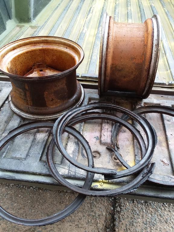

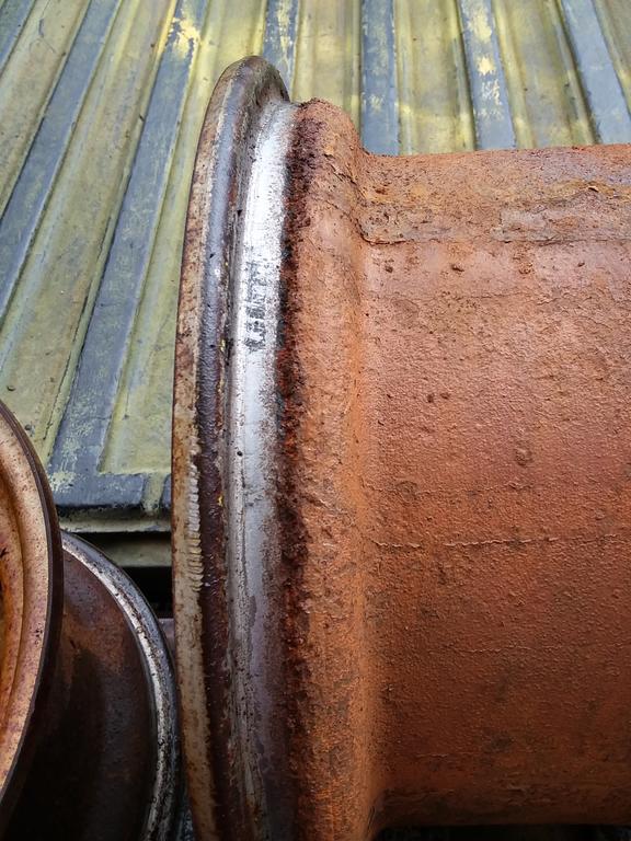

Goldann520 242 #256 Posted March 21, 2018 (edited) Taks guya, @WVHillbilly520H, @elcamino/wheelhorse, @953 nut, @pfrederi, @dells68, for giving me the encouragement to continue on with removal. Was this close to tossing em in the dumpster yesterday. Took all your advise and went to my favorite rust breaker, DISTILLED WHITE VINEGAR. Sprayed the bead and took a chisel and cut the metal bands on the bead and they just about fell off!!!!! Thanks again all!!! Started cleaning them up after. Will 10.50's work on my 312-8? These are wider rims than I have now. Or should I go with 9.50's. Edited March 21, 2018 by Goldann520 5 Share this post Link to post Share on other sites

WVHillbilly520H 10,376 #258 Posted March 21, 2018 @Goldann520, are those 8.5" wide wheels(bead to bead)? if so 10.50s will just fine and the backspacing/offset of factory WH wheels should be just fine with the 312, Jeff. 1 Share this post Link to post Share on other sites
Goldann520 242 #259 Posted March 21, 2018 Ok thanks @WVHillbilly520H, measured em to a hair over 8" quickly by eye, rims on tractor like 7 3/4"? Sound right? RUSTY rims a little wider (1/4" 0r so) than rims on tractor with 8.50's. Good to know the 10.50's will clear everything, I like the wide tires. Next decision turf or ag. Hmmmmm. My green 214 has ags and weights for heavy work already, only like $20 more for ags. Tough choice Share this post Link to post Share on other sites

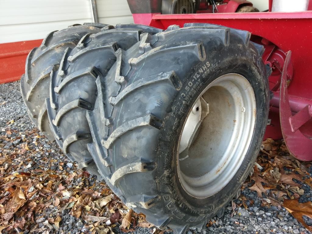

WVHillbilly520H 10,376 #260 Posted March 21, 2018 3 minutes ago, Goldann520 said: Ok thanks @WVHillbilly520H, measured em to a hair over 8" quickly by eye, rims on tractor like 7 3/4"? Sound right? RUSTY rims a little wider (1/4" 0r so) than rims on tractor with 8.50's. Good to know the 10.50's will clear everything, I like the wide tires. Next decision turf or ag. Hmmmmm. My green 214 has ags and weights for heavy work already, only like $20 more for ags. Tough choice Not trying to spend your $ but I'm thoroughly impressed with the OTR brand AGs I bought at the beginning of the year and run truer to size than some off brands like I have on the '95 both brands are 23x10.50, Jeff. 2 2 Share this post Link to post Share on other sites

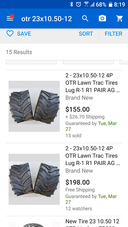

Goldann520 242 #261 Posted March 21, 2018 @WVHillbilly520H, whats the price difference jeff? I see off brand ags on e bay for $120 to $130 no shipping and the turfs $100. Those do look a lot wider for sure. Also, do you think it's worth upgrading to 8" on the front? I think I can live with the 6's for $50. Don't know about the flotation difference. 1 Share this post Link to post Share on other sites
WVHillbilly520H 10,376 #262 Posted March 22, 2018 15 minutes ago, Goldann520 said: @WVHillbilly520H, whats the price difference jeff? I see off brand ags on e bay for $120 to $130 no shipping and the turfs $100. Those do look a lot wider for sure. Also, do you think it's worth upgrading to 8" on the front? I think I can live with the 6's for $50. Don't know about the flotation difference. The OTR are cheaper ($170/pr) than Carlise Tru-power, as far as the front tire/wheels if you up grade/size you'll also have to find the correct spindles or it will look like an old gasser with 8" wheels. Share this post Link to post Share on other sites

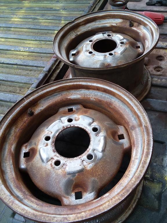

Goldann520 242 #267 Posted March 22, 2018 Alright guys, @WVHillbilly520H, @953 nut, @elcamino/wheelhorse, @ebinmaine, @pfrederi. Before I go any farther with these rims, are they wide enough to support 9.50's or 10.50's? Jeff mentioned 8.5" rims. These not that wide but have more dish than the stockers. Help!!!!! Backspacing seems to be the same on both Share this post Link to post Share on other sites
pfrederi 18,283 #268 Posted March 22, 2018 They are 7 inch rims you can use 10.50 but depending on the brand (actual sizes differ between brands) they may look bulgy You need to measure the backset correctly. Lay a straight edge across the rim on the back side then measure down to the hub ring. most horses use 1-3/8" 4 Share this post Link to post Share on other sites
Goldann520 242 #269 Posted March 22, 2018 Thanks @pfrederi did wh make wider? The dish looks a lot wider than the stocks. '91 312-8. Will probably go off brand so won't be so wide like Jeff's. @WVHillbilly520H Share this post Link to post Share on other sites
pfrederi 18,283 #270 Posted March 22, 2018 (edited) There are 8 inch rims Edit; wh didn't make rims they bought them You can get rims up to 12 inches i think. (My d200 rims are I think 12"" Edited March 22, 2018 by pfrederi Share this post Link to post Share on other sites

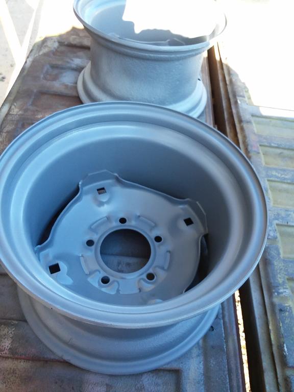

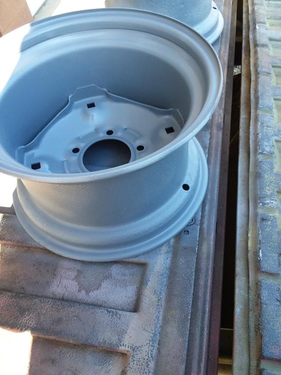

Goldann520 242 #273 Posted March 22, 2018 Ya tougher desicion than I thought. @dells68, I love ags, but like I said the JD already set up with ags and weights, so thinking going turf? Iam going bigger tires and have a slot and sleeve hitch for the 312 so idk. Finished wire cupping, cleaning and got 2 coats of primer on today. 3 1 Share this post Link to post Share on other sites
ebinmaine 70,345 #274 Posted March 22, 2018 @Goldann520 Awesome job on those rims! About the tires... ags vs turfs. Is there a Specific reason you DO or Do NOT want more ags or more turfs?? I'm pretty well set on ag tires but I have no lawn to screw up. Just curious.... Share this post Link to post Share on other sites
dells68 7,498 #275 Posted March 22, 2018 @ebinmaine just hit the ole nail on the head. What do you want to do more with the tractor? Yard chores? Plowing chores? Grass you'll want turfs. Plowing or pushing and need lots of traction, ags. Only you can decide on that. Rims look awesome by the way! Share this post Link to post Share on other sites
