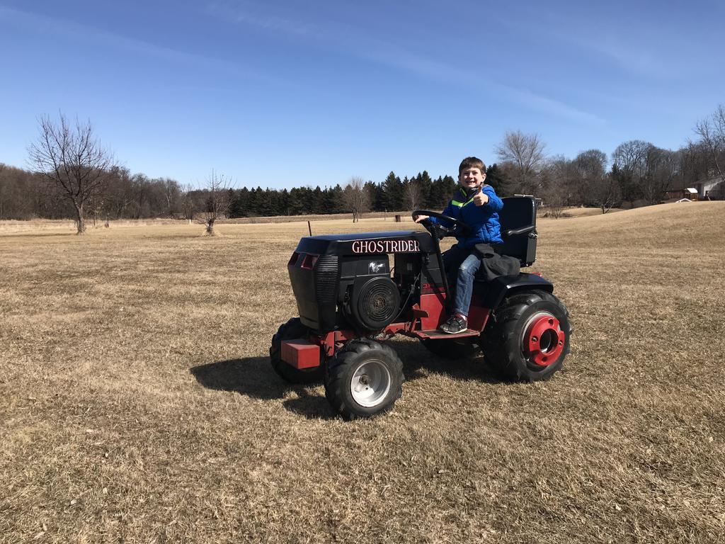

PeacemakerJack 10,743 #228 Posted March 16, 2018 Had to get rid of some construction debris today and had a half empty trailer and so I decided to clear some trash out of my business storage. GhostRider has been taking his long winters nap in there so I started him up and pulled him out. Then Judge (my third born) wanted to drive awhile... nice picture opportunity in between cleaning stuff up! 12 3 Share this post Link to post Share on other sites

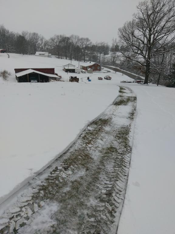

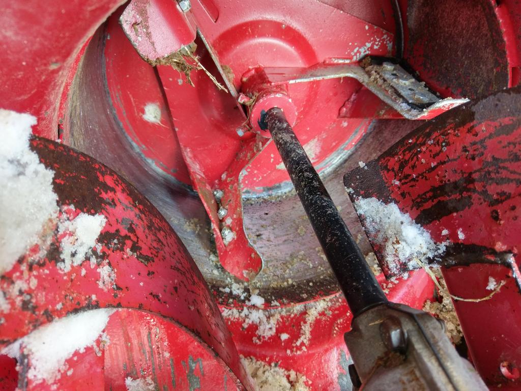

WVHillbilly520H 10,376 #234 Posted March 17, 2018 11 hours ago, WHX14 said: Ahhhh earth to EB earth to EB over..... Ah Jim I could say the same to you, as I finally got to test out the OTR AGS in a heavy wet 7" snow on Monday without chains and tagged you but no response, anyways nearly flawlessly on unfrozen ground...just don't add rubber paddles to the impeller on the deuce and clear 3-4" deep gravel/stone driveways... 1 1 Share this post Link to post Share on other sites
PeacemakerJack 10,743 #235 Posted March 17, 2018 That is a bummer Jeff—the stones beat those rubber paddles up. That is one of the advantages that we generally have up here in the “far north”—the ground is usually frozen like concrete when we are moving snow. It is always a bummer though when the ground is soft and we have to move snow like you did, ruts and tore up grass not to mention kicking stone if you have a gravel drive... I’m glad that the OTR’s worked good. They sure look great on there. You know me, I’m a sucker for a pair of AG’s on a GT!!!! Thanks for the update. I’ll check in on your thread too... 1 1 Share this post Link to post Share on other sites

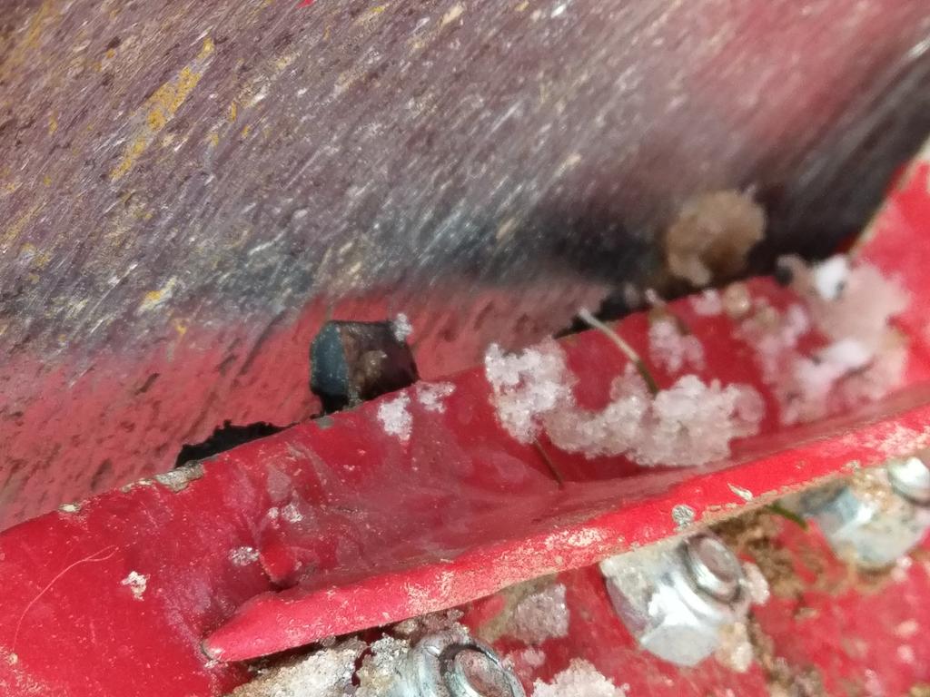

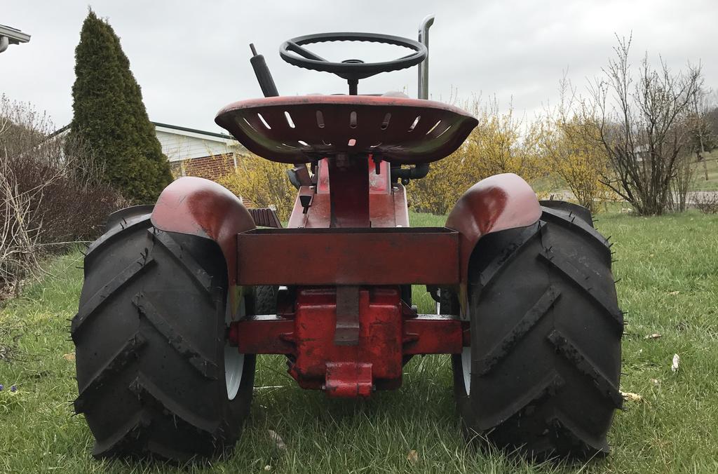

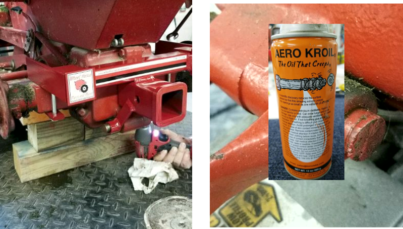

Vinylguy 4,691 #236 Posted March 17, 2018 Went to my buddies shop yesterday and the bike lift was open (which is unusual) so Gary thought it a good chance to get the commando out and try to remove the hitch pin. Once we got the wheels off I noticed some play in the left rear hub. moved in and out on the axle about an 1/4 inch. Called up our good friend Rmaynard for advice and got that issue resolved. thanks Bob. About 3 weeks ago I sprayed Aero-Kroil on the hitch pin and figured we would still have to cut the pin to get it out but after a couple taps we saw it move and were able to punch it out with little trouble. Ordered one of Lowell's awesome hitches and got it installed. High quality product as always Lowell, Thank You. The brake was a little weak on the down slopes last year. I am pretty sure the commando wont float. The adjusting nut was rusted up also but after 30 minutes soaking with a kroil treatment it was good to go. Love that stuff. Hoping to find a good lawn sweep now that I have a hitch. Noticed the original Wheel Horse tires are age cracked on the inside. I think I mowed all last summer with no air in them. Will start looking for some new tires. Oil change and a good cleaning next. Then load it on the trailer and take it back out to the lake April 1st. Almost forgot, Need to mount a good adult beverage holder. 2 6 Share this post Link to post Share on other sites

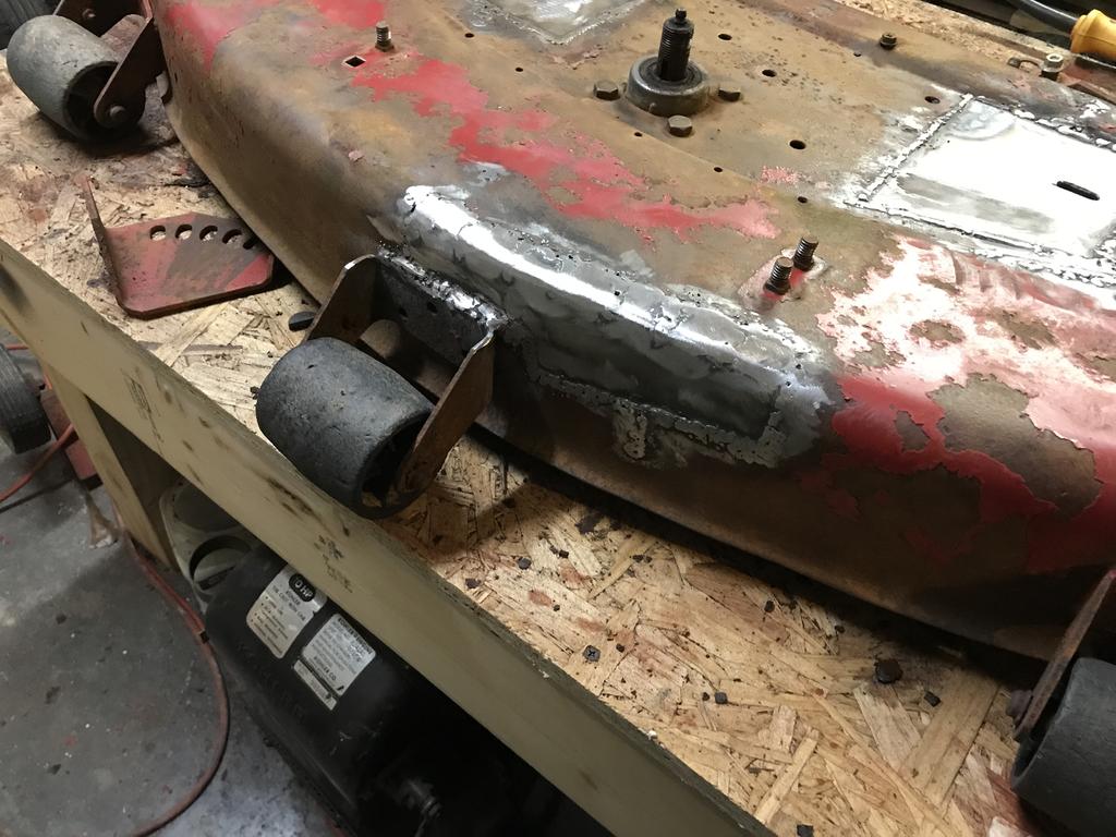

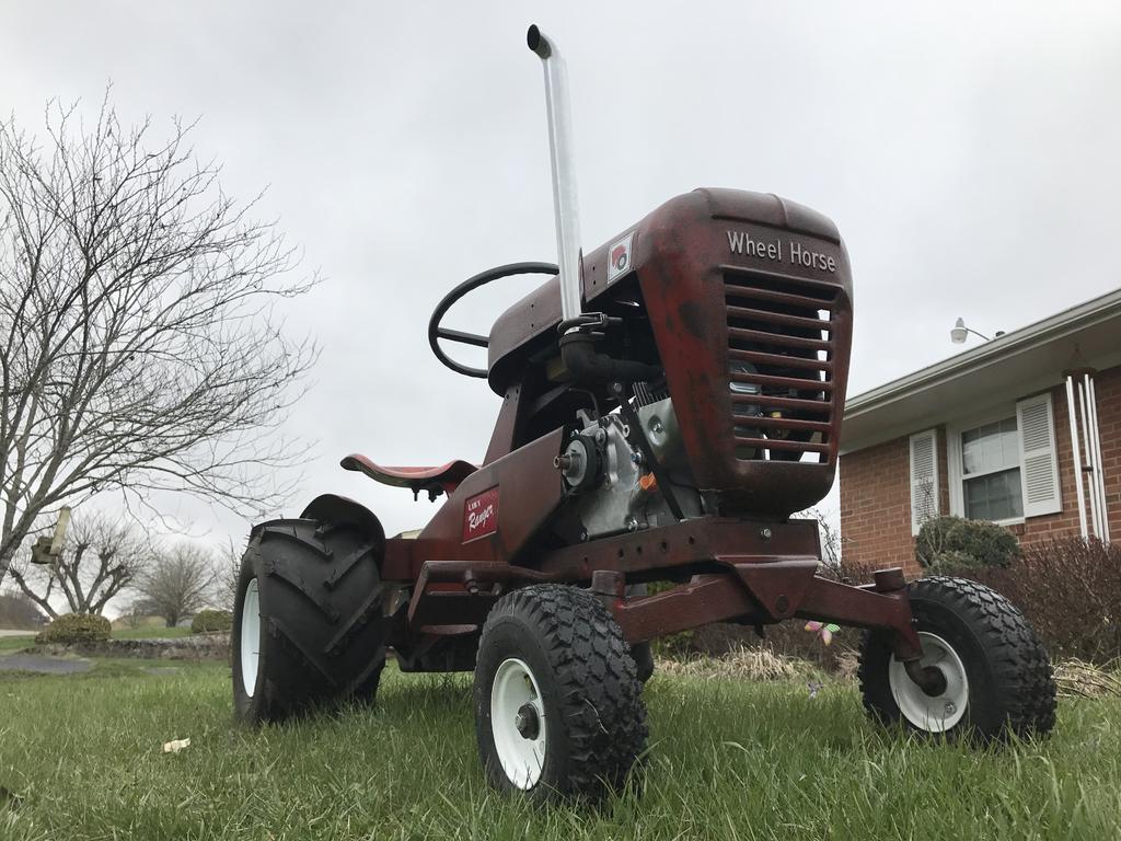

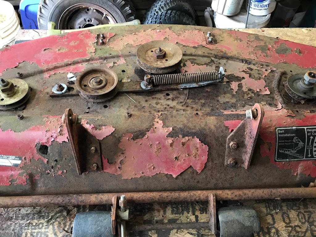

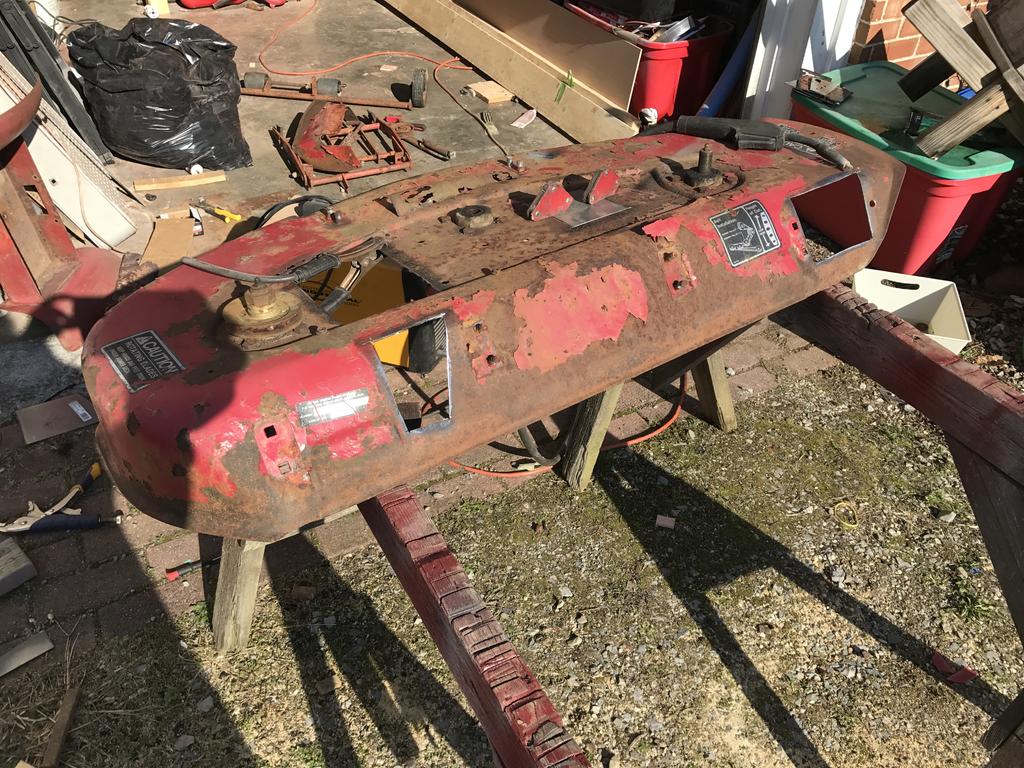

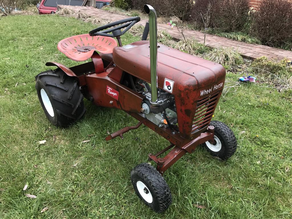

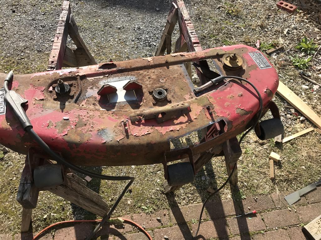

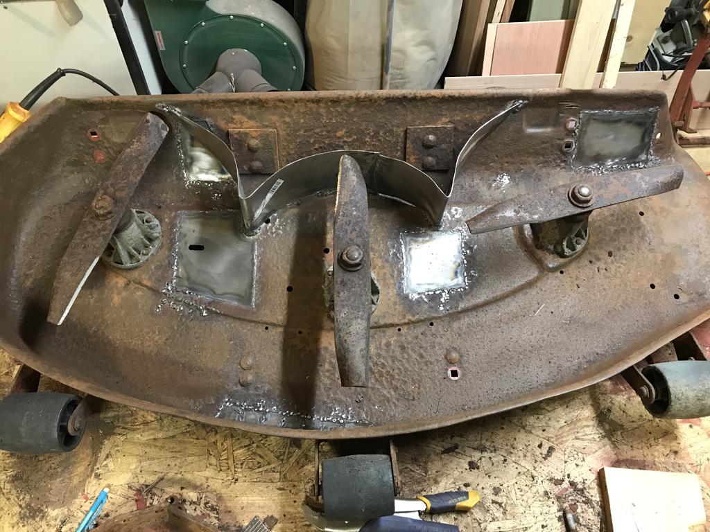

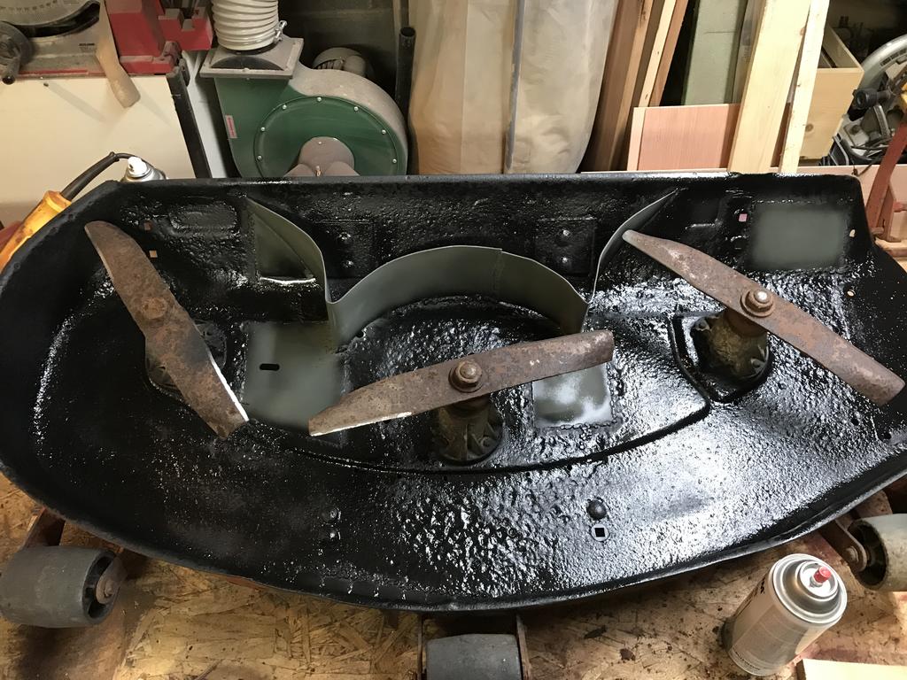

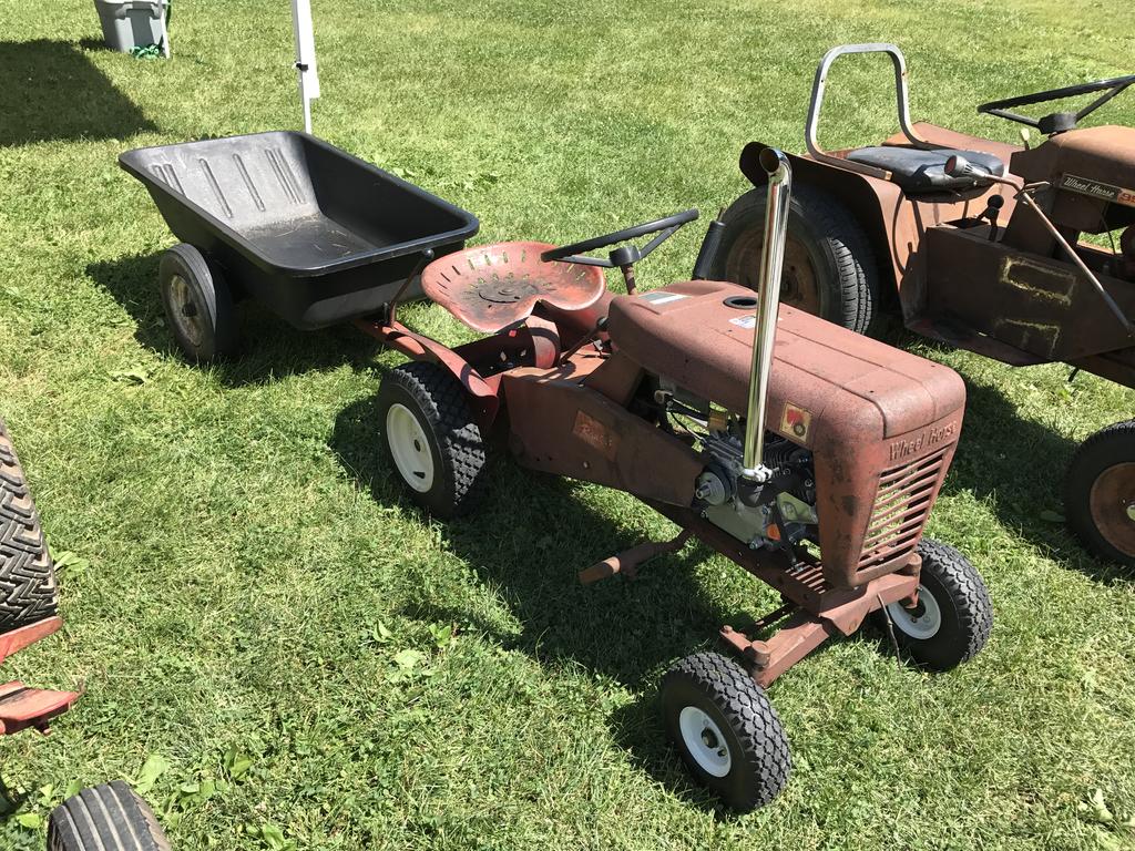

dells68 7,498 #237 Posted March 18, 2018 Well, Emory's Lawn Ranger saw the light of day again. I pulled it apart to put in a trans that I got from @oldredrider, tires from @limited12, wheels from Miller tire, hubs from eBay, and a sanding with clear coat. Check out the before and after pics. I also tore down the deck that came under Emory's Roadrunner. Gonna put it under Coyote and put it to use. I had to cut out 5 sections and graft in new metal, make new baffles, fill a few holes, wire wheel the underside, etch prime the new metal, and put rust converter on the underside. After it cures, I'll seal the seams with polyurethane sealant and beeline the underside. A couple of the spindles are corroded, but have 3 boots holding them, and I have 2 new pulleys for the spindles. 6 7 Share this post Link to post Share on other sites
elcamino/wheelhorse 9,360 #238 Posted March 18, 2018 @dells68 What kind of rust converter did you use. The tractor and deck are really looking good. 1 Share this post Link to post Share on other sites
dells68 7,498 #239 Posted March 18, 2018 I used the Rustoleum stuff you can get at Lowes. I've used it for a couple of years now and it seems to keep the rust at bay as long as you wire wheel the metal really good first and topcoat it with something. I used another brand on a VW Thing I did and it's held up great. Only time will tell. Topside of the deck ain't gonna be real pretty thanks to my welding skills or lack of, but hopefully I've added a few years to its life. Got it and Roadrunner for $50 at the Big auction last fall - and people laughed at me! 5 Share this post Link to post Share on other sites

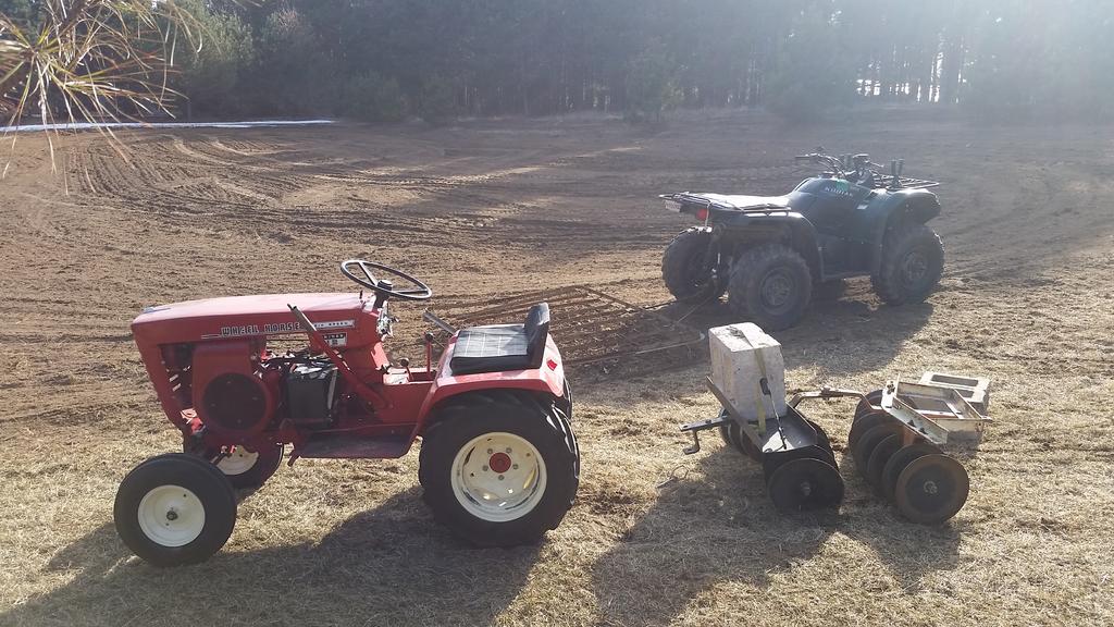

WHX?? 50,515 #241 Posted March 19, 2018 Didn't do anything to the horses but did make one work! Getting the plow fields ready for spring planting! 4 8 Share this post Link to post Share on other sites

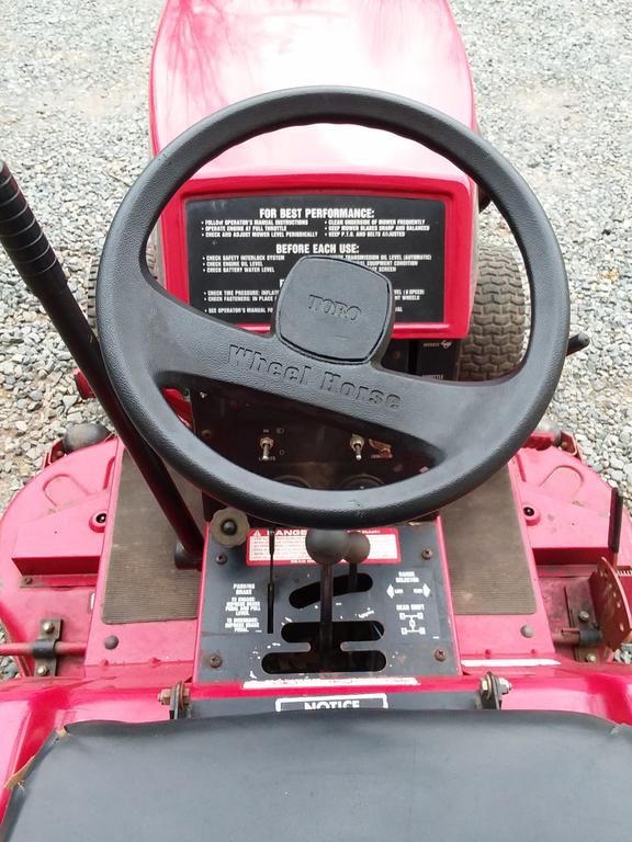

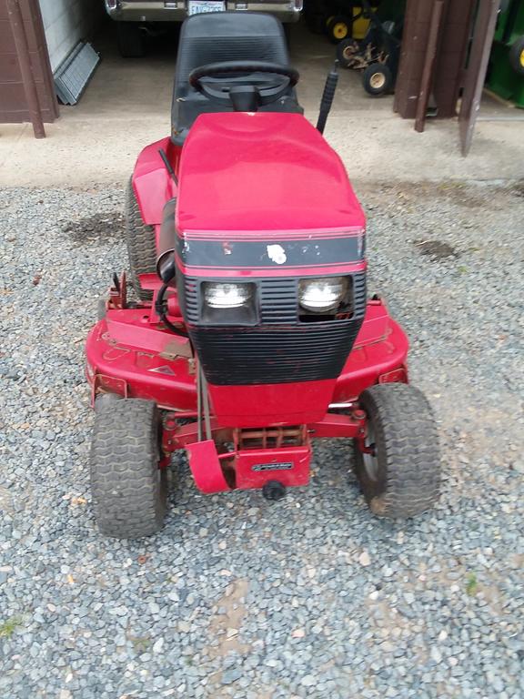

Goldann520 242 #245 Posted March 20, 2018 (edited) Got my steering wheel on the 312-8 finally! (Was steering with 2 broken nubs) tried to center wheel but rt side tie rod not adjustable? '91 312-8, whats up with that!!!! Even my green has 2 adjustables! @ACman, @WVHillbilly520H, she's coming along slowly. Btw had to drill out top plastic of wheel and DRIVE that sucker (sawed off steering shaft) out bottom. Edited March 20, 2018 by Goldann520 3 Share this post Link to post Share on other sites
WVHillbilly520H 10,376 #246 Posted March 20, 2018 6 hours ago, Goldann520 said: Got my steering wheel on the 312-8 finally! (Was steering with 2 broken nubs) tried to center wheel but rt side tie rod not adjustable? '91 312-8, whats up with that!!!! Even my green has 2 adjustables! @ACman, @WVHillbilly520H, she's coming along slowly. Btw had to drill out top plastic of wheel and DRIVE that sucker (sawed off steering shaft) out bottom. I think @wheelhorseman, makes an adjustable set of you can make your own, also if you pull the steering shaft up out of the fan gear and move 1 tooth to the left to help recenter, I know it's not a 520 with car style rod ends, I'm not even sure the 400 series had adjustable ends, Jeff. 2 1 Share this post Link to post Share on other sites
Goldann520 242 #247 Posted March 21, 2018 @WVHillbilly520H, moved the shaft on the fan gear today. Now it's off a tad the other way, but not as bad. At least i got the steering shaft tightened up really well with the collar and snapring. Started breaking down tires off old wider RUSTY rims I picked up with the other goodies this weekend. Tires won't budge off the bead. Tire shop or throw em away. TERRIBLE!!!!! 2 Share this post Link to post Share on other sites
