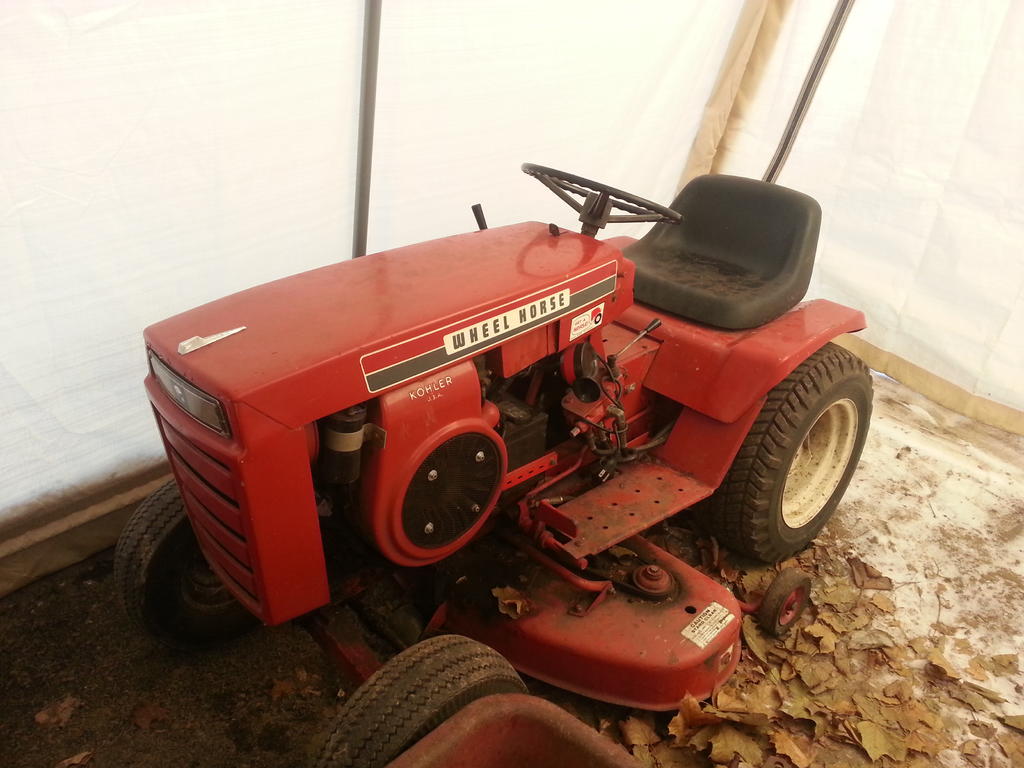

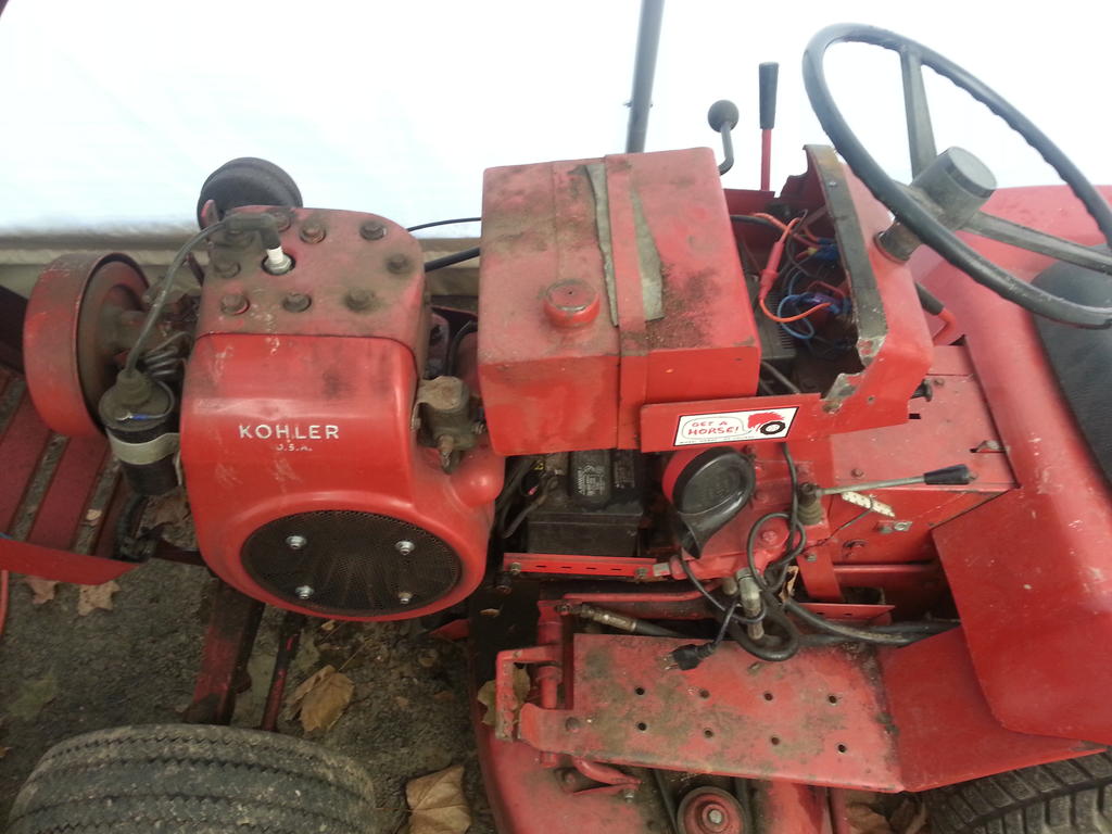

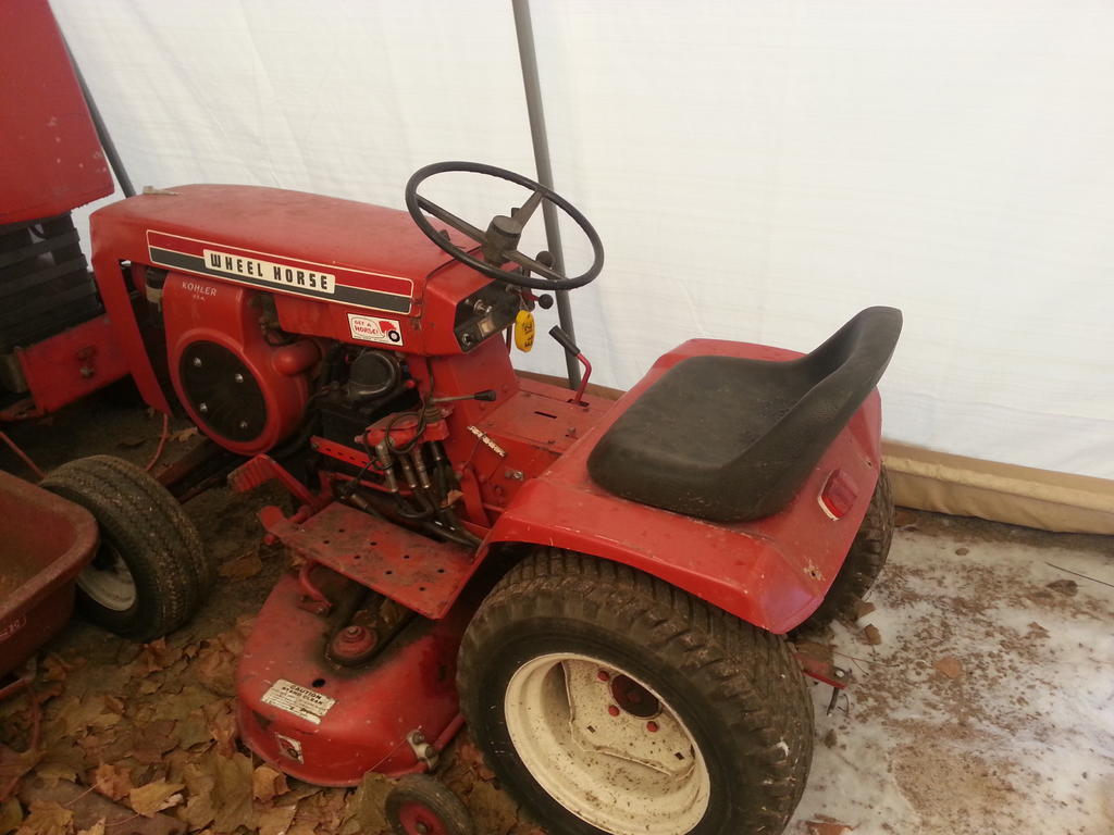

The Gman 476 #1 Posted January 15, 2018 Hi, I'm Gary from Ontario Canada. I joined a number of months go but this is my first post. This forum is fantastic! So much to see and learn. I have currently have 4 horses. An 87 312-8, 89 520, 71 A800 ranger and another one I could use some help confirming its identity. I'm not sure if it's an electro 12 or a charger 12. I've seen pics of the electro with both "electro" and "wheel horse" hood decals. Is the hydraulic lift a rarer find. The engine is in rough shape. Burns oil, and has a number of oil leaks. It was already re painted when I got it. Thanks for any help you can give. Gary 5 Share this post Link to post Share on other sites
Ed Kennell 40,188 #2 Posted January 15, 2018 to the Gary. I may be wrong, but I believe the Electro came with the electric PTO clutch. May help with the ID. Other members may be able to tell by the transmission engagement handle. Share this post Link to post Share on other sites
WHX?? 50,466 #3 Posted January 15, 2018 Gary look right under the dash to see if there is a tag there with the model number. It may be missing or painted over. If not that there see if you can post a pic of the engine id plate. That would help also. Definitely got the wrong fuel tank but still a nice survivor. Share this post Link to post Share on other sites
The Gman 476 #4 Posted January 15, 2018 Hi Ed, thanks. There is a utube video of a guy with both a charger and an electro. The electro does not have the electric pto but has the hydraulic lift........ so confusing.... I can mtell the hood decals were replaced. Thanks again. Share this post Link to post Share on other sites

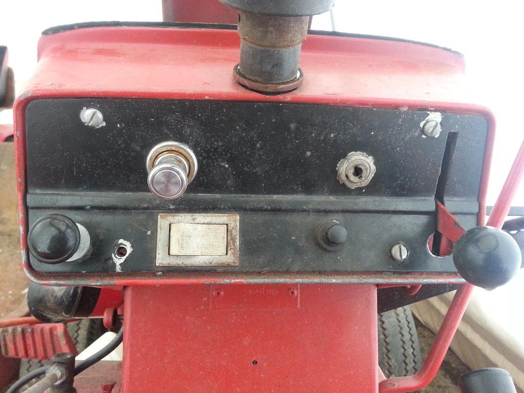

953 nut 57,438 #5 Posted January 15, 2018 there have been a few modifications made by previous owners including the horn and gas tank are NOT . If it was an Electro (and the dash has not been replaced) there will be a switch for the electric PTO between the throttle and choke, don't see one on yours. The hydraulic lift could be found on the Charger or Electro. If the model number plate is not on the dash tower the PTO switch would be the only give away. Share this post Link to post Share on other sites

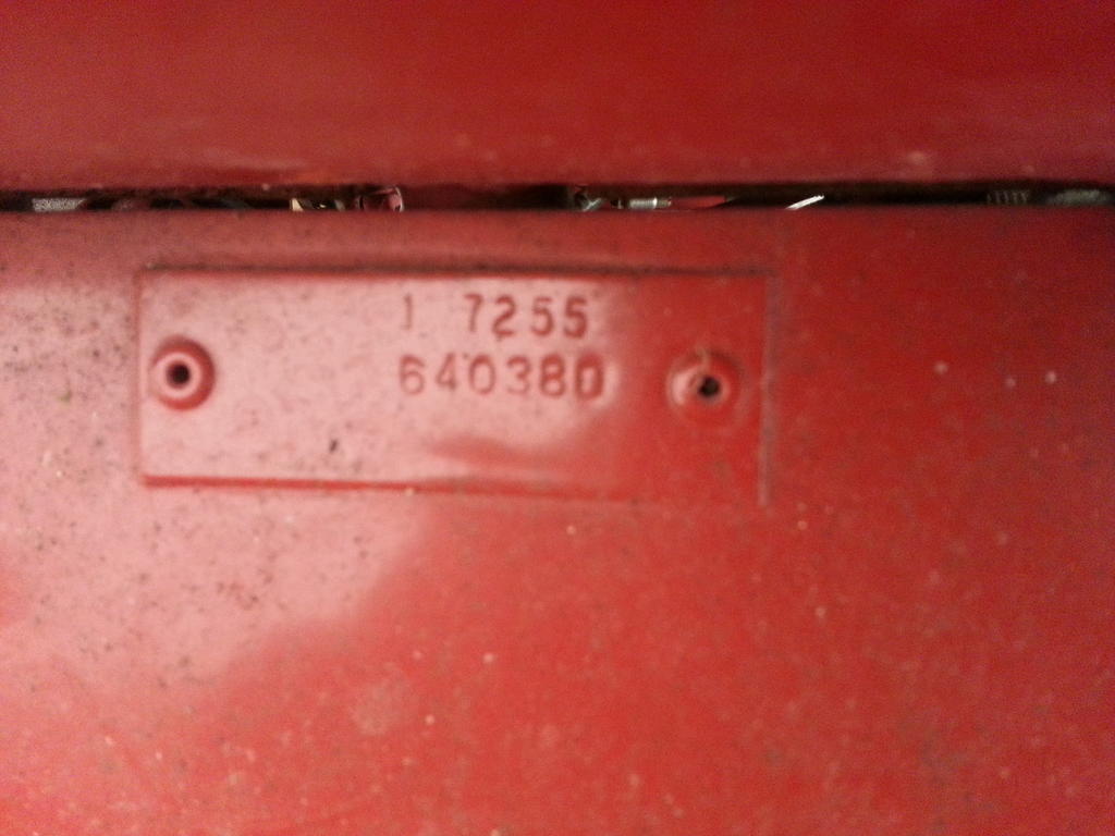

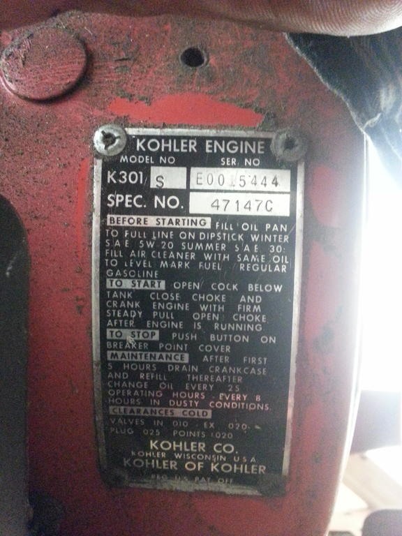

The Gman 476 #6 Posted January 15, 2018 Wow...WOw..and WOW. Red square is the place. I took a pic of the engine plate and found the tag below the dash. It was painted so I didn't notice it a first. Is this enough to id. the beast? 2 Share this post Link to post Share on other sites
pfrederi 18,279 #7 Posted January 15, 2018 (edited) Model number makes it an Electro 1970 Listed Spec number for the engine should have been 47371C The engine spec number you have is listed for the 1969 Electro I have a 69 and it has eh 47147C motor. However WH probably had some 47147C engines left aftr 69 and used them in 1970. Your engine originally had a Breakerless ignition system. It has been replaced with a battery system...much easier and cheaper to work on. Electro also would have had an electric PTO but when they failed it was common to substitute a manual. The hydro lift was standard on Electros optional on Chargers. They are fantastic tractors. I have 4 Chargers and Electros. You absolutely can't beat them for snow plowing work I think it should have had hub caps also (at least the 69s did) Also looks like the lift control valve has been replaced Edited January 15, 2018 by pfrederi 2 4 Share this post Link to post Share on other sites
WHX?? 50,466 #8 Posted January 15, 2018 Yup 1970 Electro 12 serial No 640380 Type 7255 in the search box upper right corner pull down files and hit search. You will find every thing you need for the tractor in the way of manuals, service bulletins and what not. 3 Share this post Link to post Share on other sites

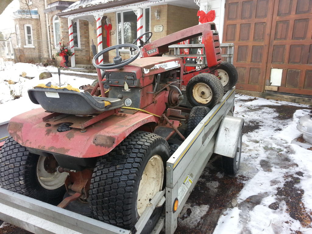

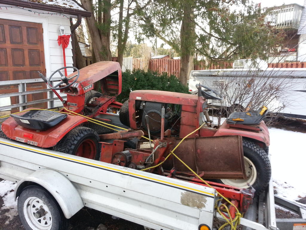

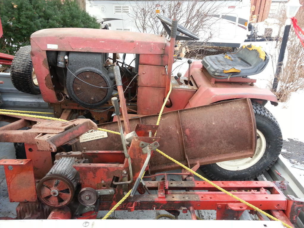

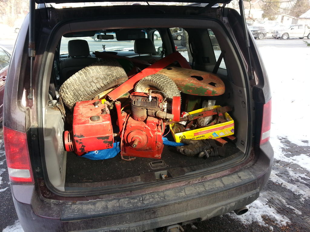

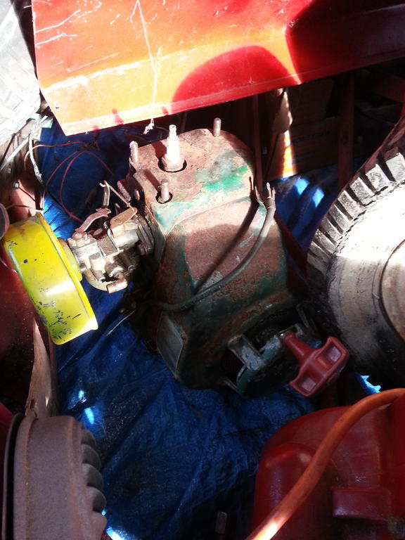

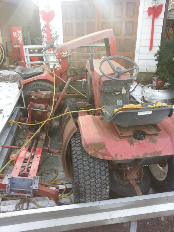

The Gman 476 #23 Posted January 20, 2018 Not exactly what I was expecting but I couldn't just leave them there. They were wasting away under tarps. Nice fellow in his late 80's had them. Asking 250 gave him 350. Looks like each one is all there? Won't know till I put all the parts in separate piles. SB an SK486, 800 special C120 and a suburban. We will see when I sort through them. Gotta unload now. Wife wants her Pilot back. 2 3 Share this post Link to post Share on other sites
jay bee 912 #24 Posted January 21, 2018 You're going to need a bigger trailer (and possibly a larger storage area) if you keep up this pace. 2 1 Share this post Link to post Share on other sites
