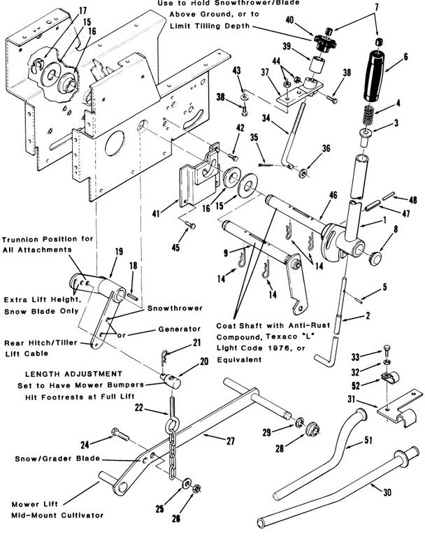

Since it sounds like it did work per chance did you install the 'flag' in the wrong hole in the rock shaft? That could cause the lift to try to raise the blower past it limitations and hit something before it latches in the raised position. :think::)

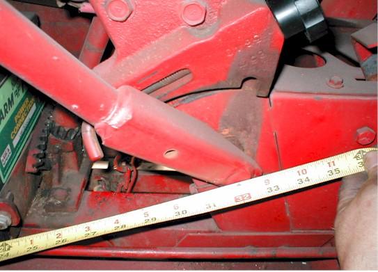

This is what locks it. Pirated from the net. I don't know what they were measuring.
This is from a later model and lift arrangement but the lift arms are the same and have the attachments lifted by the same holes in the arms.
Garry
Make sure your flag is in the top hole of the rock shaft (item #19) as shown in Garry's illustration in Post #3.  Also, there are usually shims on the shaft between the flag and the lift rod.  If there are to many shims, it will cause the lift rod to hit something up front before the lift handle can come back far enough to engage the lock mechanism.  Hope this helps.
